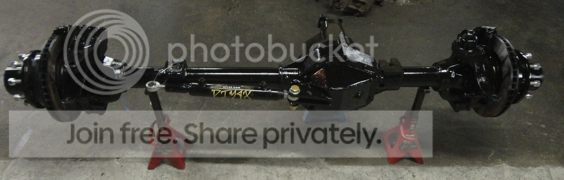

Got the Dana 60 that's going into it finished up today and as soon as I finished painting it, I realized I hadn't put on shock mounts. I gotta get a tie rod built for it yet and then I think its ready to go in the truck. Front drive shaft here we come. Get some pics of it once the tie rod is on. The Hydro assist mounting is in place so that will be done right away this time.
