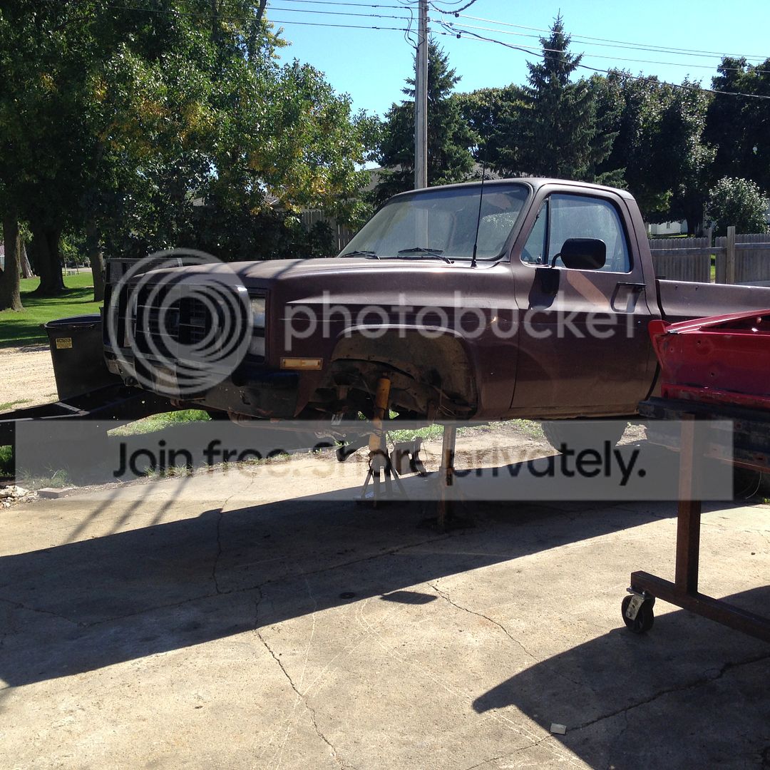

This is what we did this morning. Whole removal process took between 45 minutes to an hour. Fastest removal I've ever had. Not a single bolt rusted stuck.
