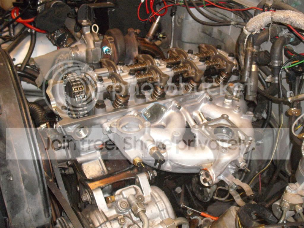

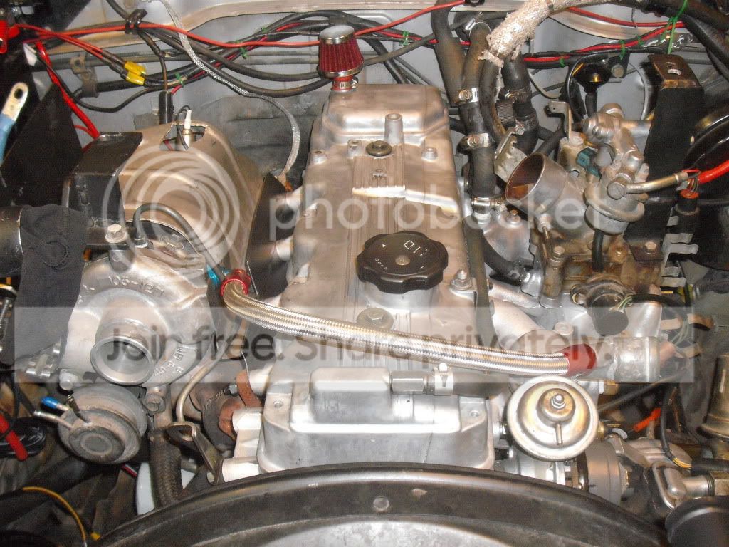

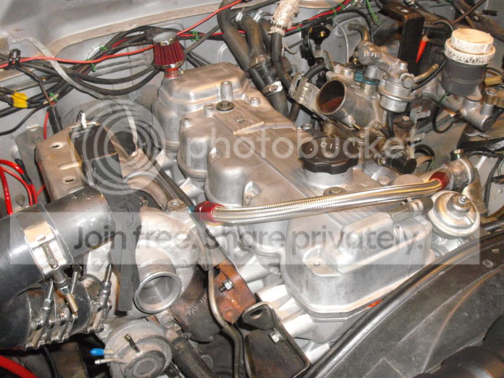

The turbo motor has a fairly easy to use fuel injected TB system and is intercooled. Once I had it in, I had to work some plumbing issues for the Intercooler, oil cooler and trans cooler. A few of the other Turbo swapped Monty's have the IC up front like this.
montymcvicpipes2-jpg.253169
(MontyMcV's on 4x4wire)

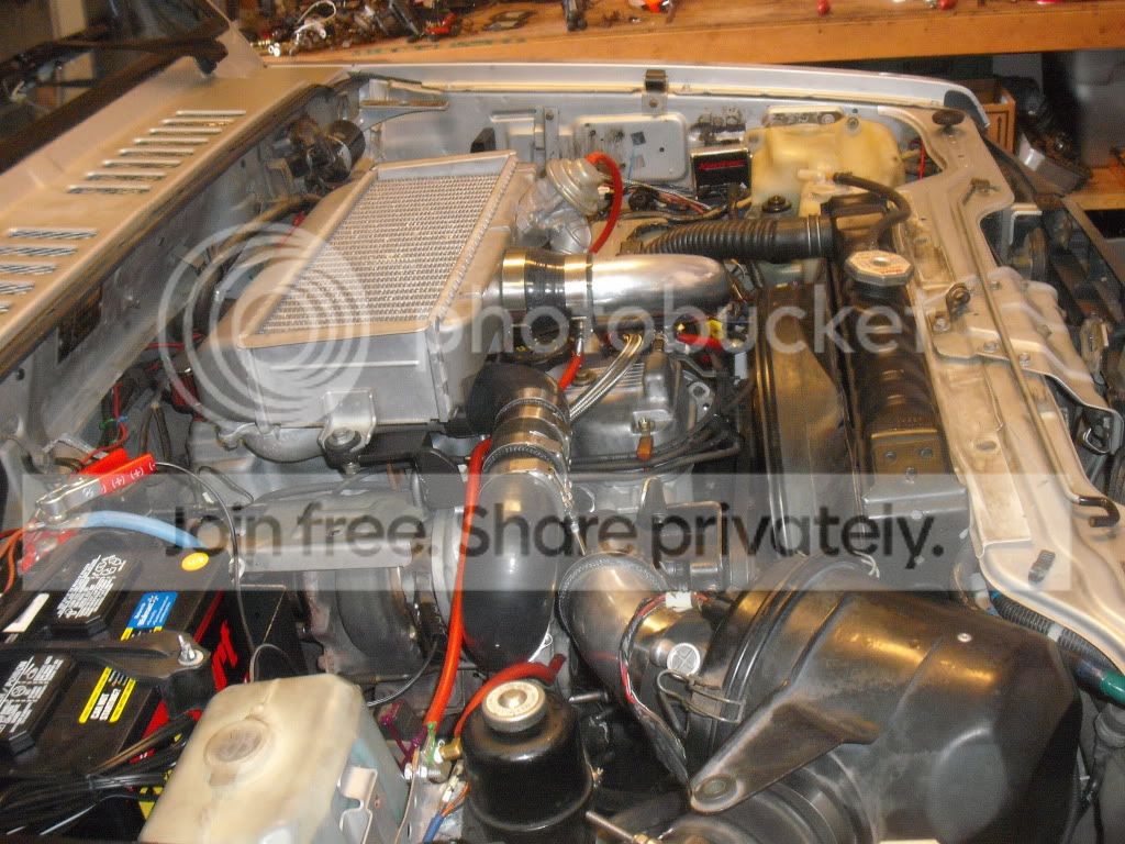

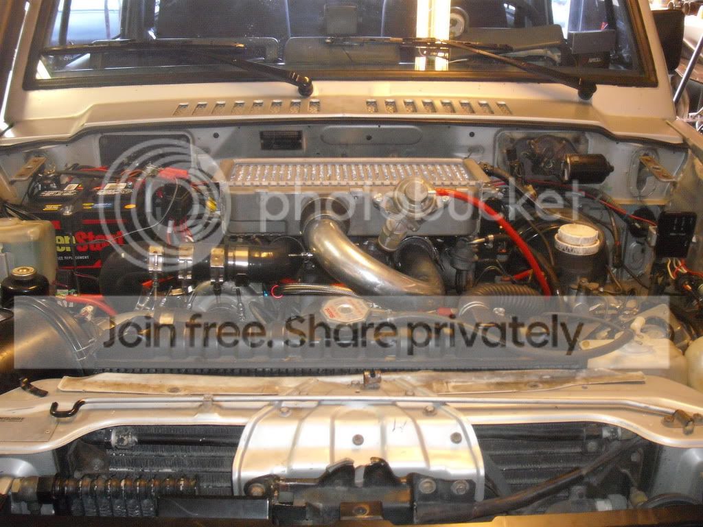

I didnt want to go that route cause I wanted to keep my AC and the turbo's oil cooler had to go in that space along with the auto tranny's cooler. The only space I could get the intercooler to fit was pretty low down by the skid plate. And I really didn't like the idea of having it down there. So I decided to go top mount with it. Now the JDM models (Pajero's) can come with a turbo diesel and they run a top mount IC and a nice looking hood with scoop on them. But I knew I wasn't going to have any luck getting that setup here. So I originally planned on going with a WRX scoop on mine along with a WRX intercooler.

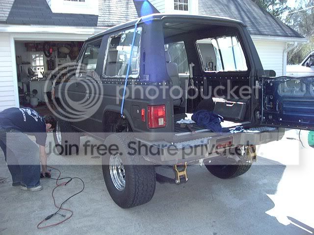

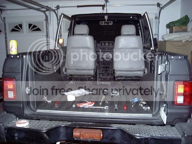

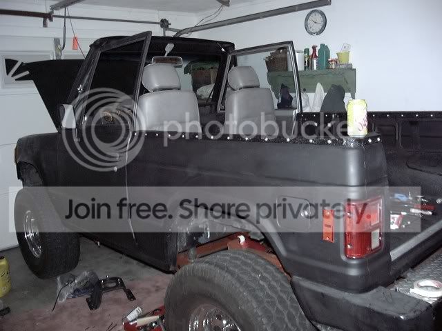

Along with working on the motor setup, I was also redoing alot of the interior. I stripped it out to fix some rust issues in the back and to bedline the interior.

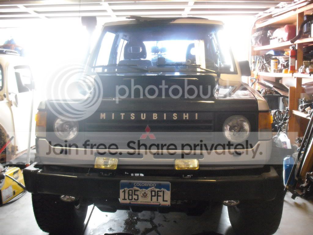

I also swapped out the Raider grille for a Mitsubishi grille and added an HID light kit to it along with some fog lights and driving lights up front.

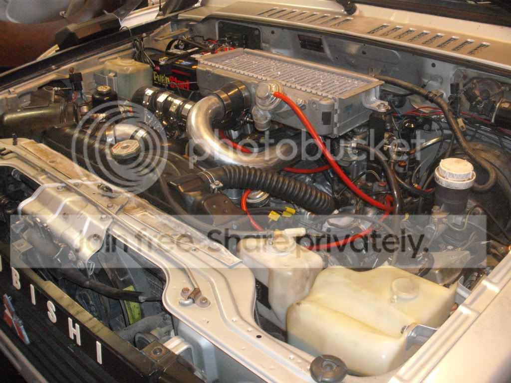

Here is what the IC setup looked like.

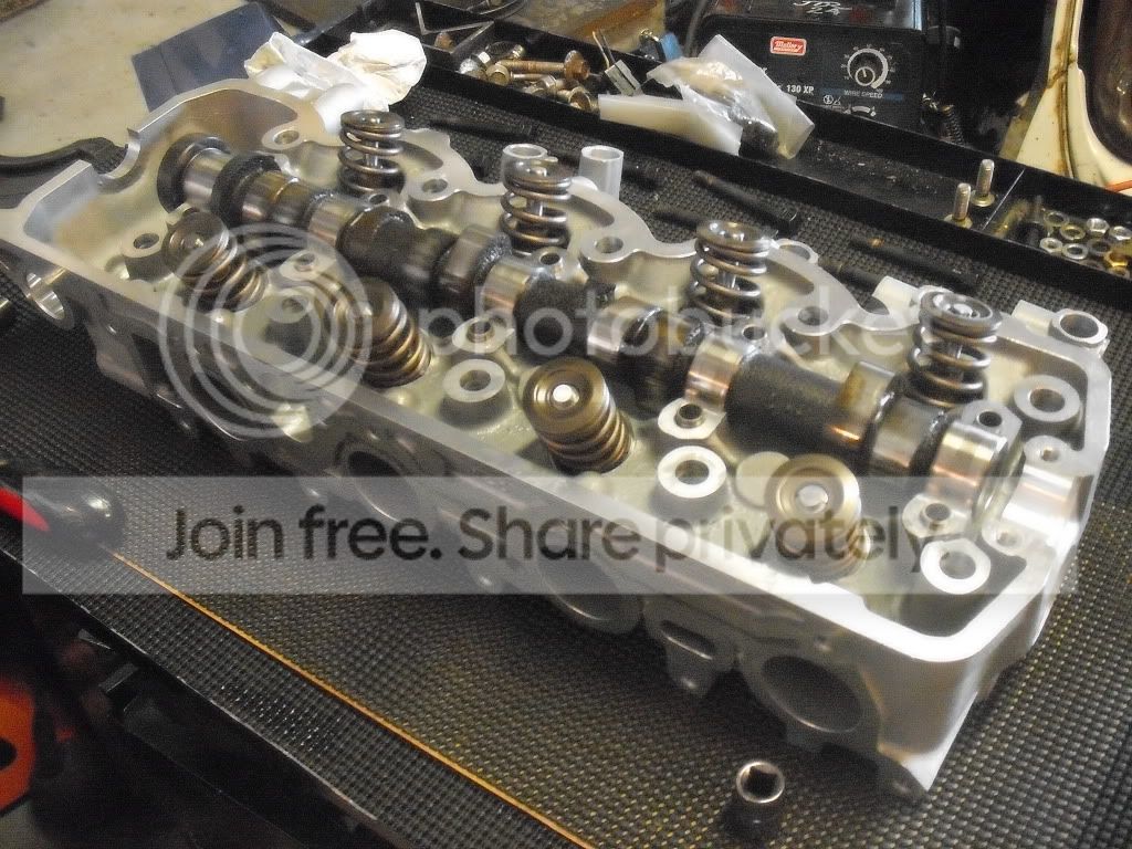

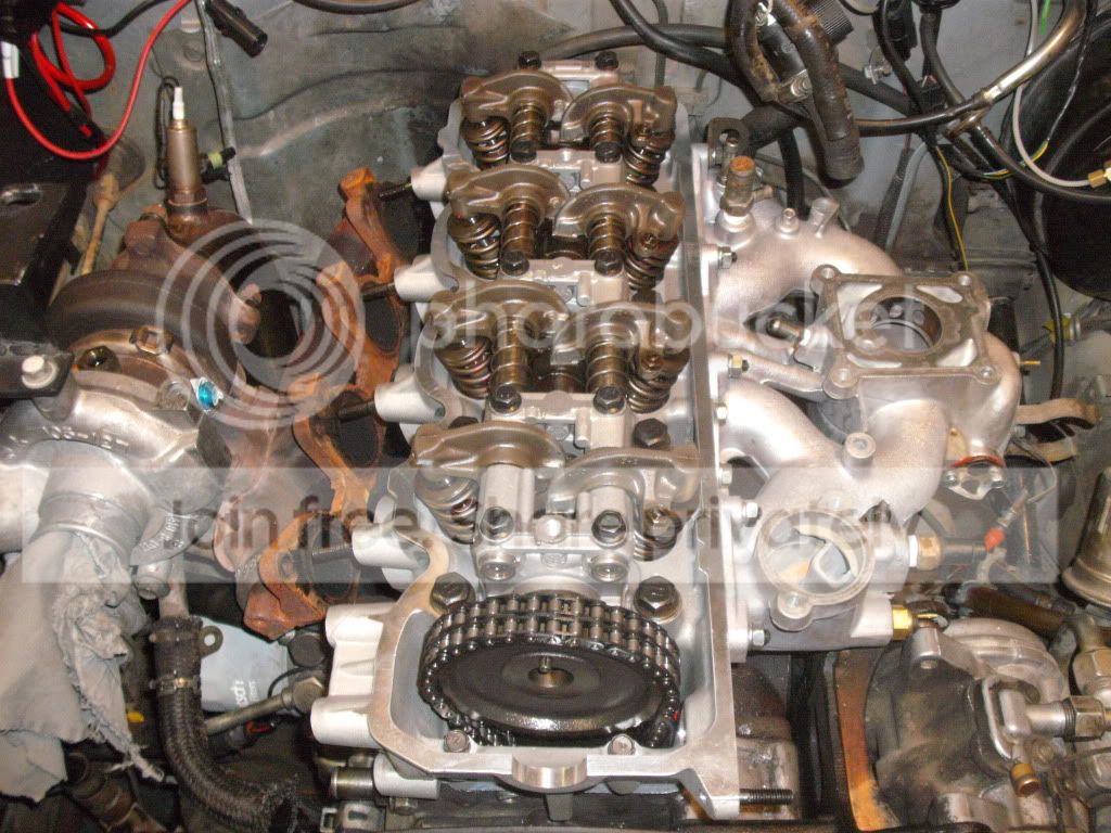

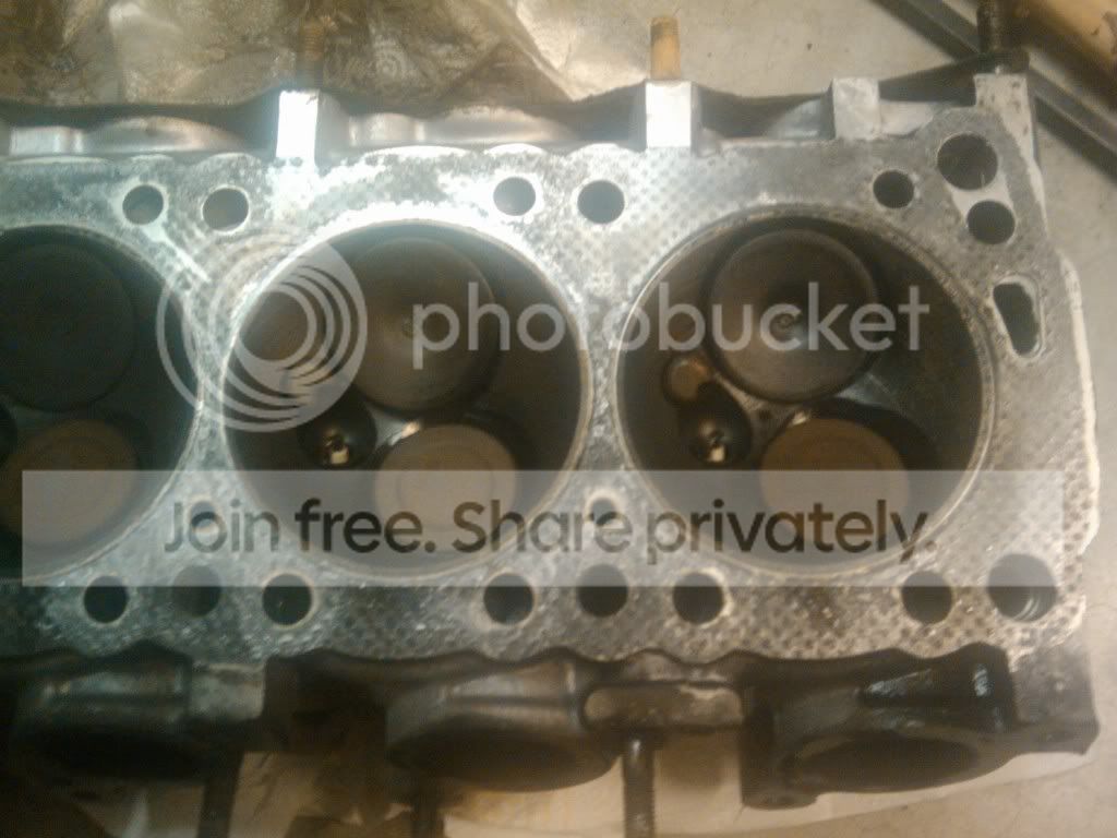

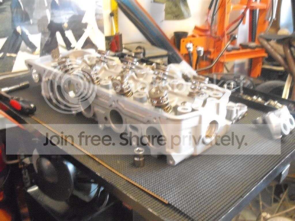

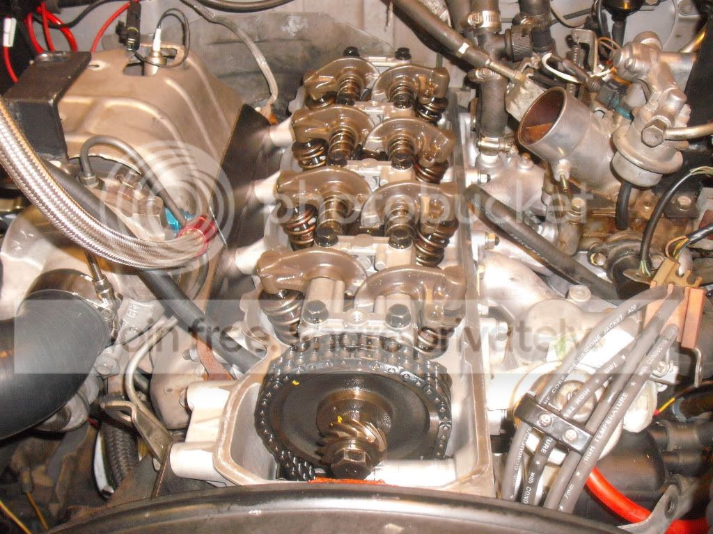

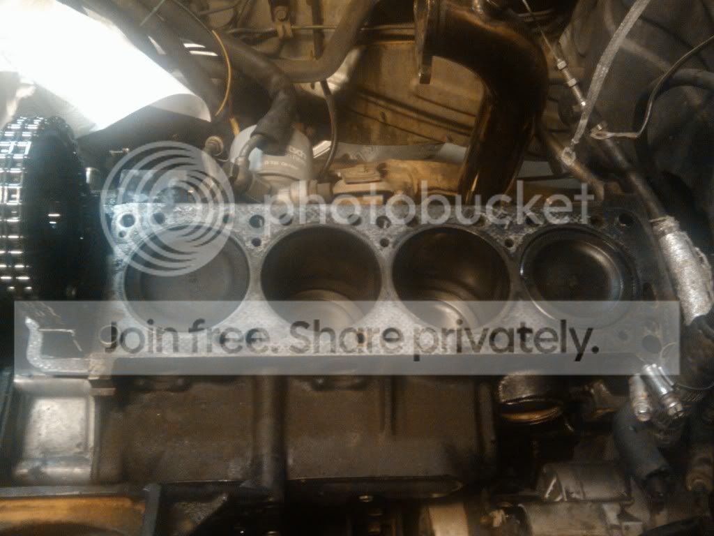

So I got it running almost right but kept having some weird idling issues. But I drove it around and figured I could live with it and took it to work a few days. Thats where I screwed up. These 2.6 motors are notorious for having issues if you overheat them. The head is aluminum and loves to crack or warp real easy if you overheat them bad. Well my idle issue was actually a bad vacuum advanceon the distributor. So while cruising, under boost, the vac advance is supposed to retard the timing. It wasnt doing that very well and I ended up overheating and cracking the head pretty bad.:doah::angry1:

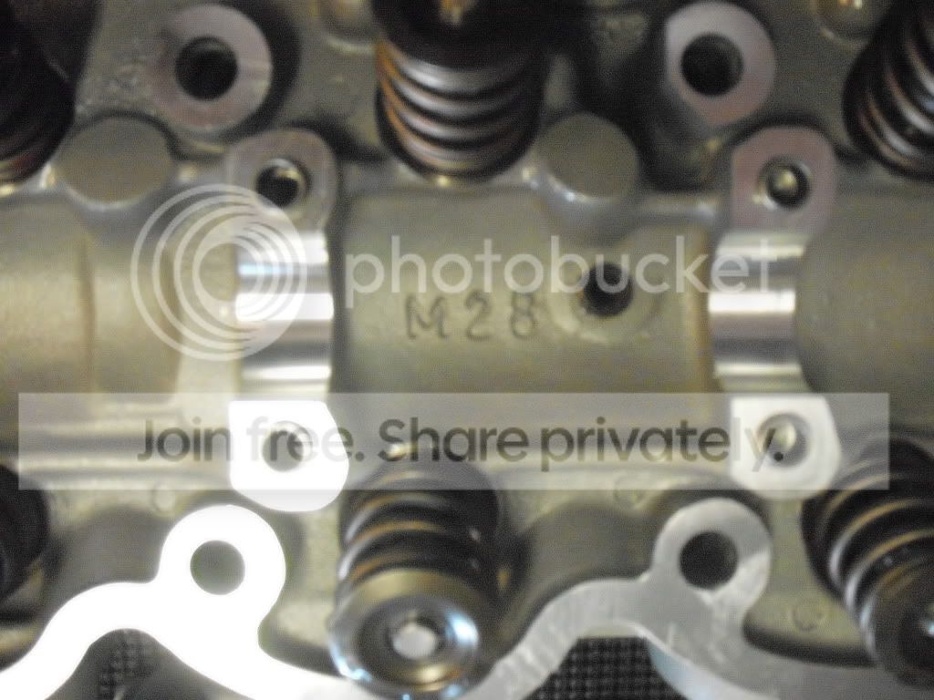

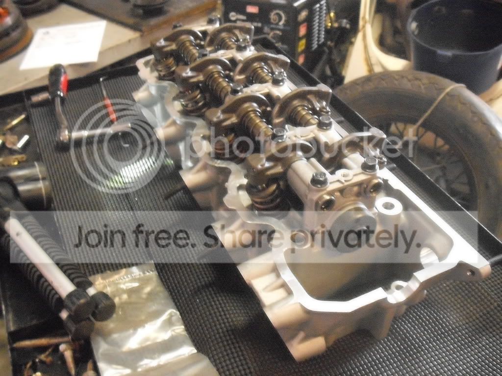

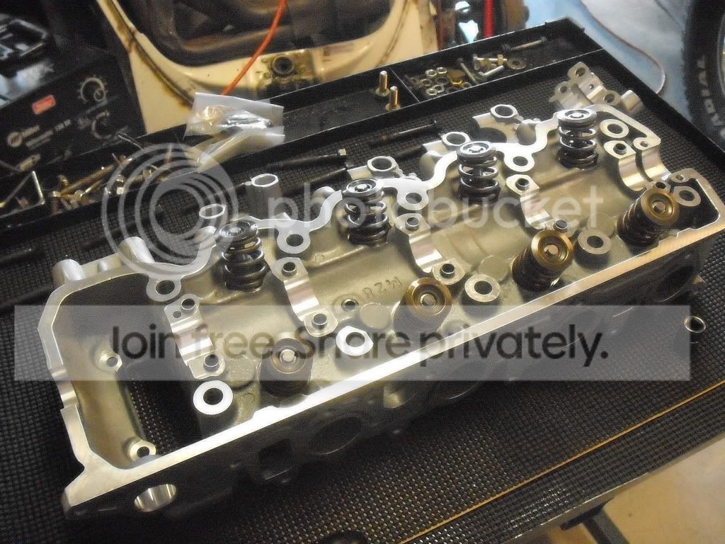

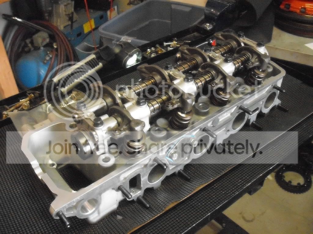

I tried finding a used head for a few weeks but kept coming up empty. Seems like every one I found in the local yards were trashed or had bad cams. I ended up buying one off a local guy on the StarQuest forums that was supposedly recently rebuilt. But that thing was out of spec and cracked. By the time I would have paid for it to get fixed, I was looking at new head prices anyway.:dunno: So I went and bought a new M28 head (no Jet Valves:bow:) from EMS out of Niles Ohio. Randy did some great work in building this head for me.:waytogo:
Then I got to put it all back together.

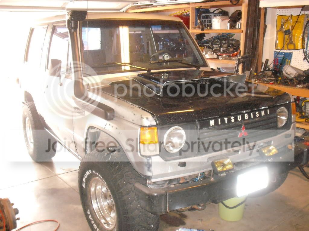

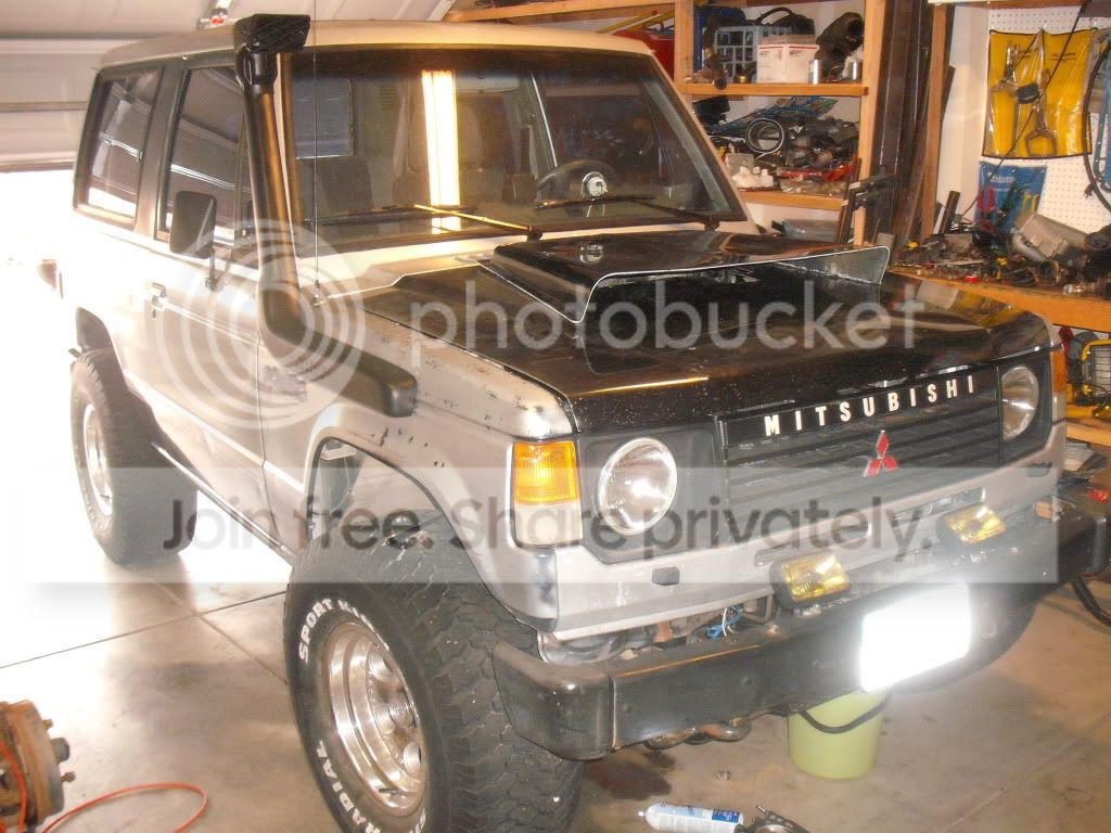

After I got done putting that all back together I picked up a different hood scoop. Its a little large, but I wanted to pay homage to the Mopar part of this rig.:haha:

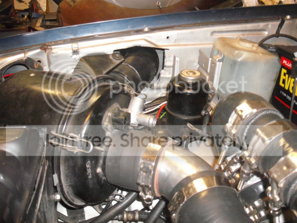

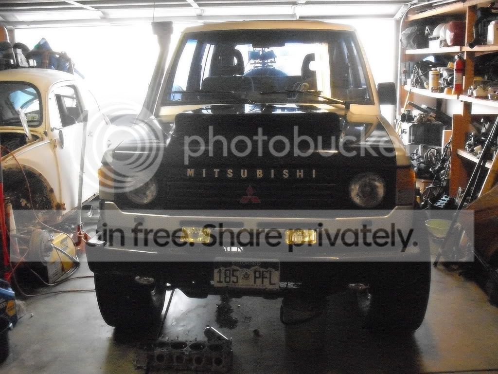

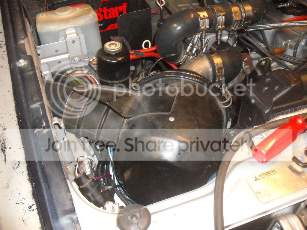

I also added a snorkel to it. Yes its fully plumbed and functional.
I also put on JDM/Aussie tail lights and turn signals. I like the look of those versus the US spec tail lights (solid red for the stop and turn and solid orange for the front corners).

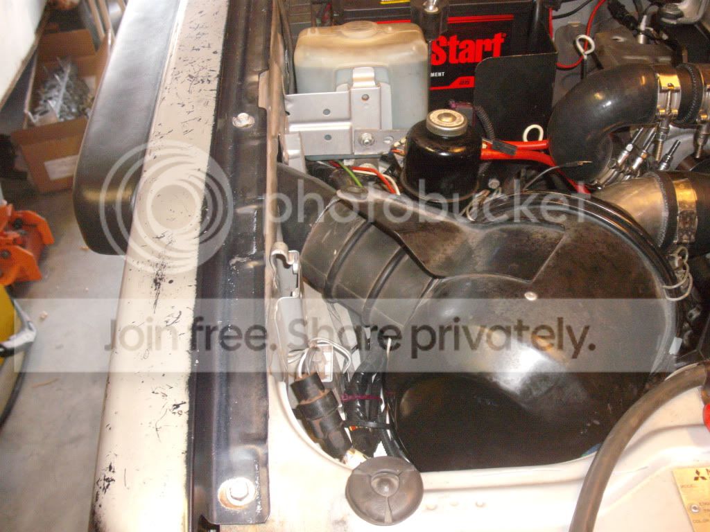

Snorkel plumbed into the stock air can and Starion MAF.
