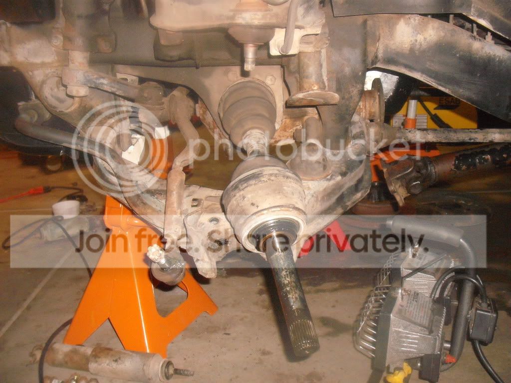

Some more work done on the Raider.

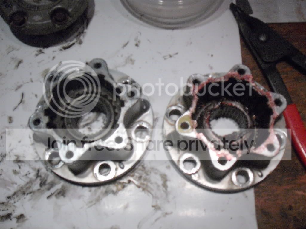

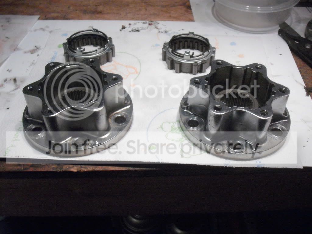

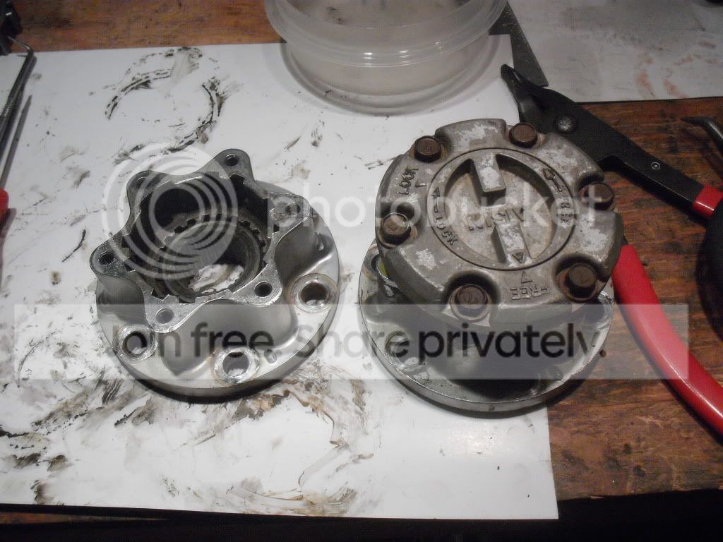

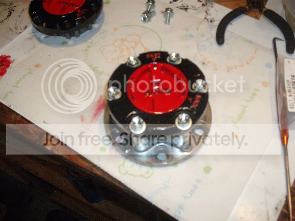

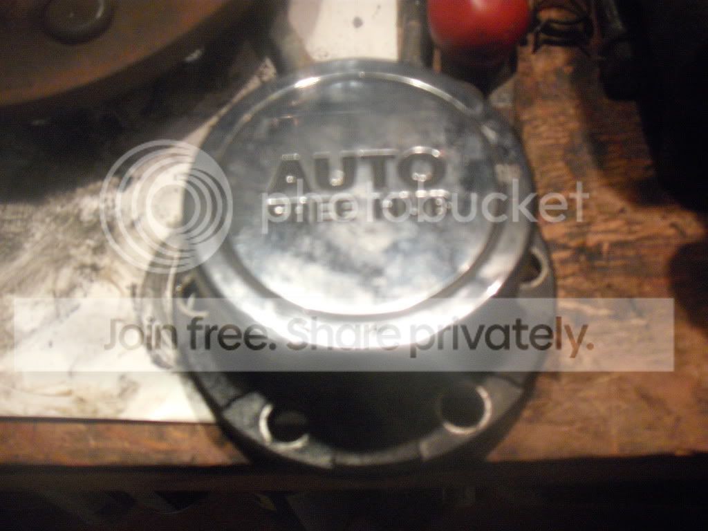

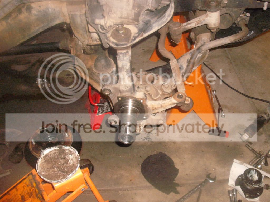

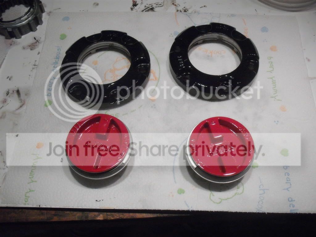

Took the auto hubs off for some rebuilt Aisins.
I went thru them and cleaned them up.
I had to check the oil pump and pan so I decided to drop the pan. In order to get to the oil pan I had to drop the front diff. I needed to do some work on it anyways and it made me redo the brakes.

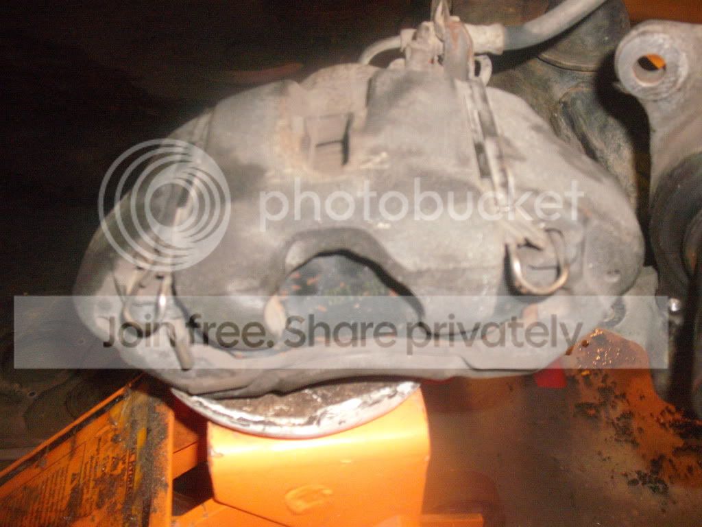

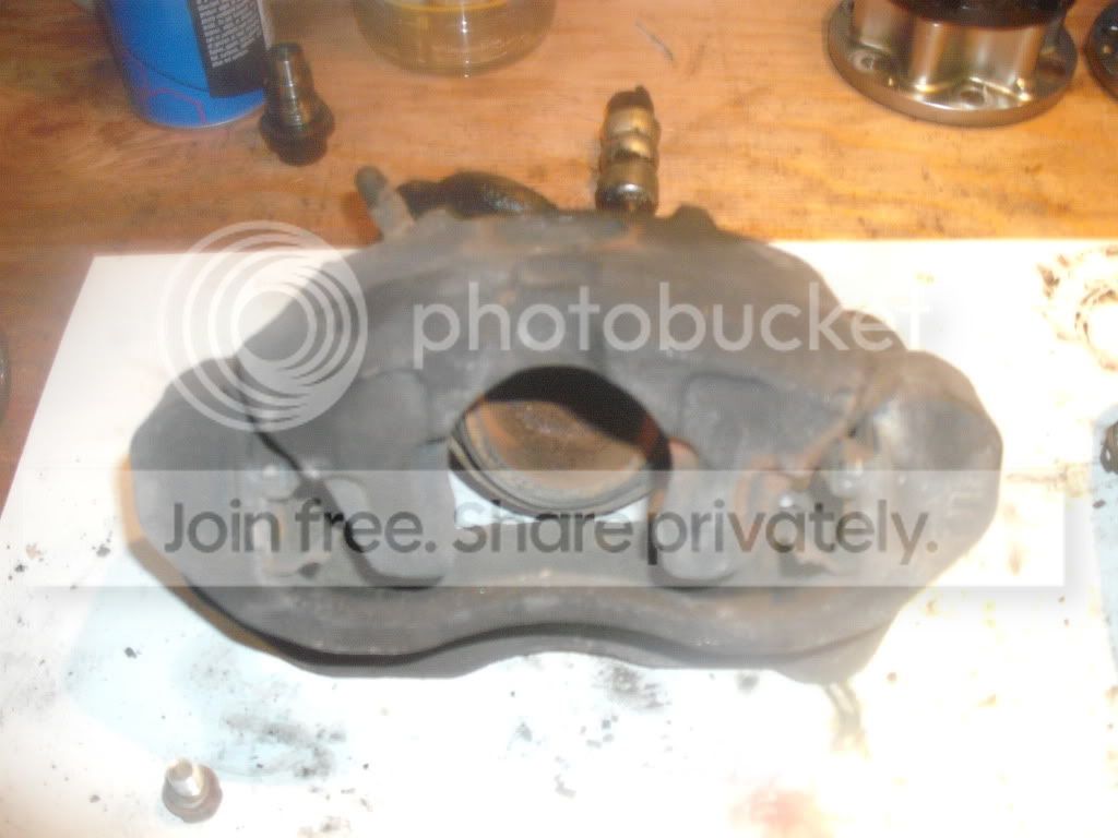

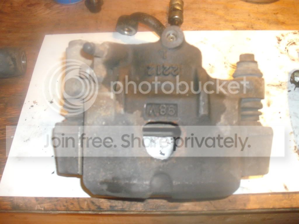

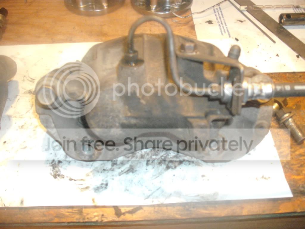

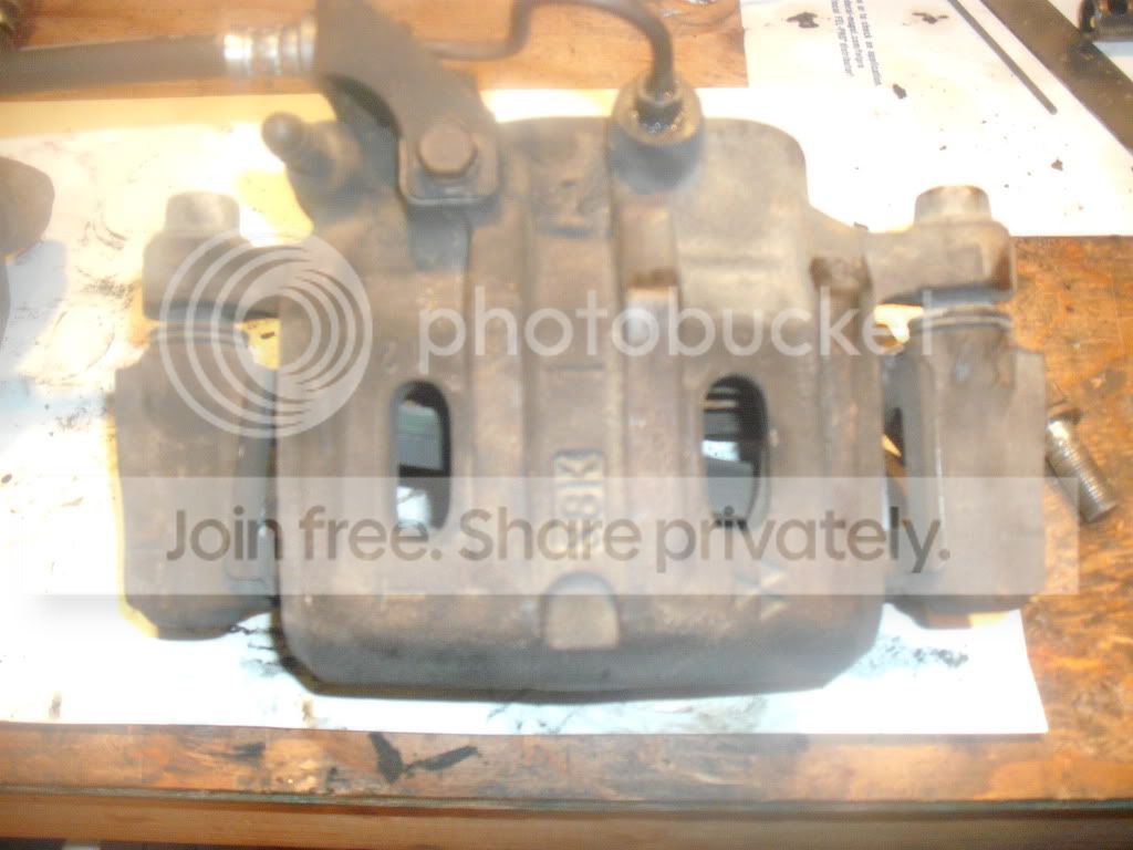

Here are the details on the brake upgrade.
a 4 Cyl (87 and older) has 10" x .79" rotors and the caliper piston is 2.1248".
the later 4 Cyl (88 on) had 10.2" x .866" rotors and the caliper piston is a little larger at 2.249"
The later V6's had the same calipers (2.249" pistons) but the rotors were slightly larger at 10.9"s.

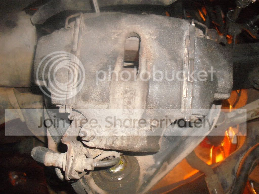

V6 calipers

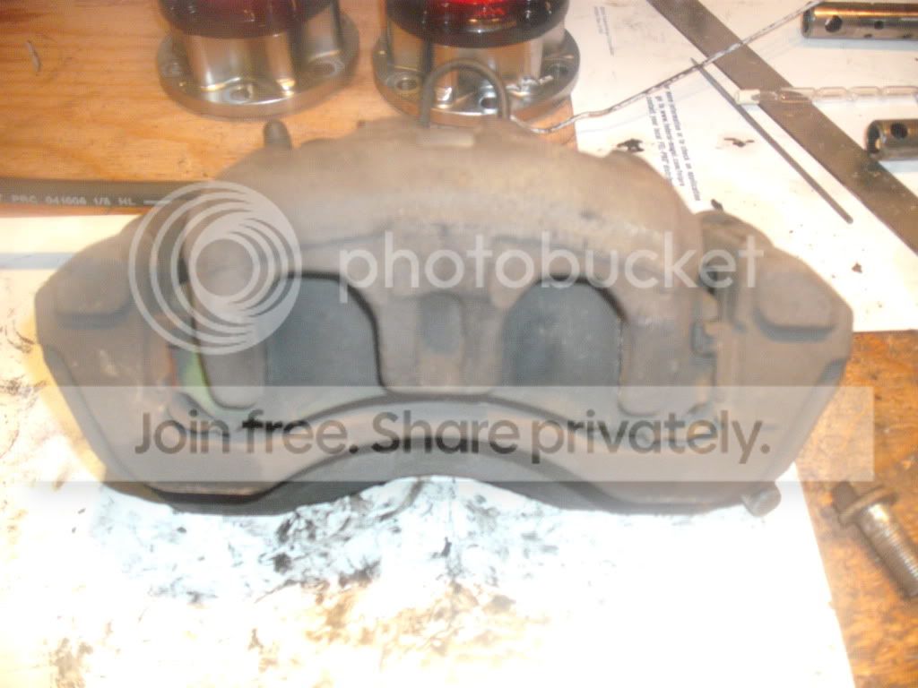

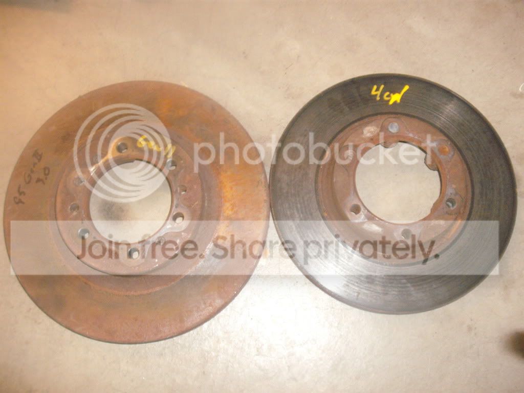

The Gen IIs used a similar rotor at 10.9"s x .866"s but the two piston caliper has 2 pistons at 1.6875"s.

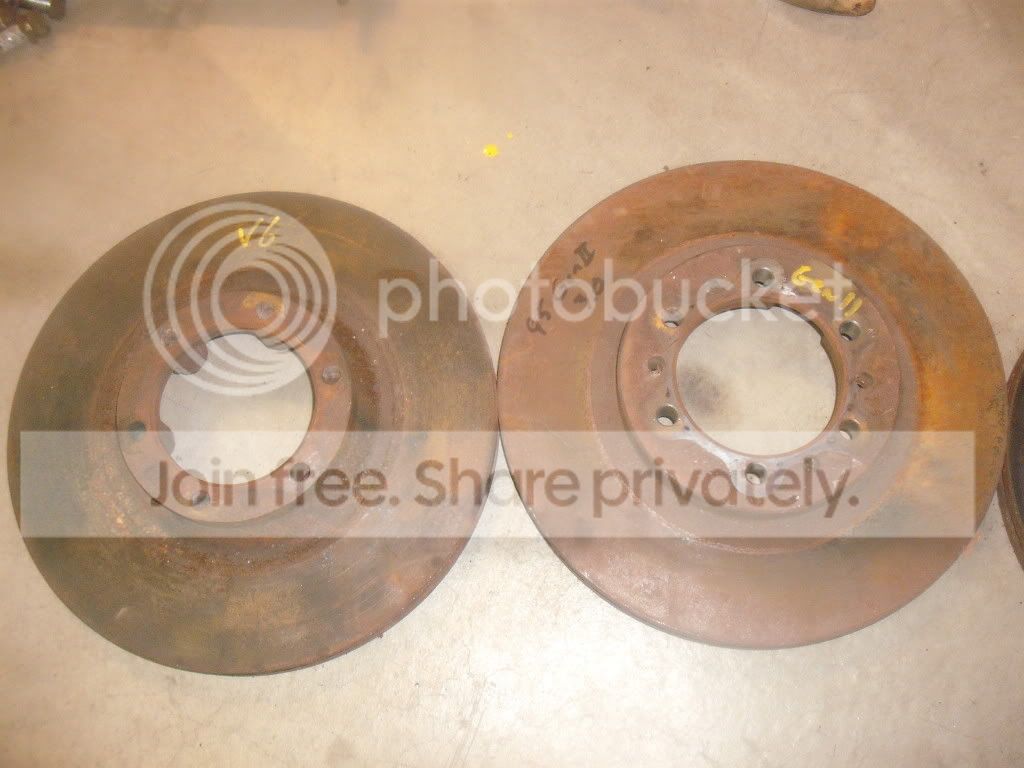

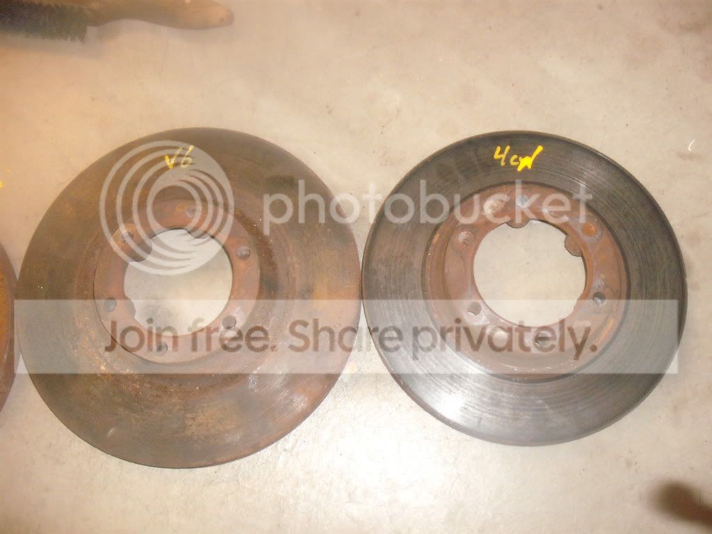

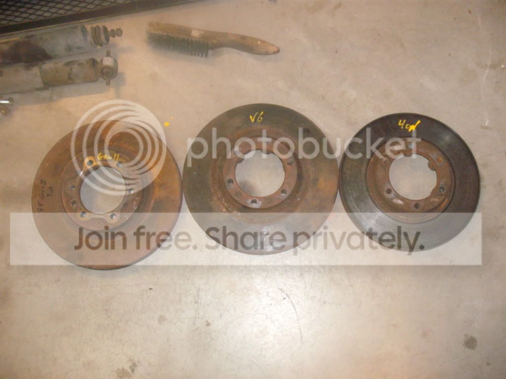

Here is a side by side comparison of all 3 rotors. 4 cyl is on the right, V6 is in the middle and Gen II (3.0) is on the left.
v6 to 4 cyl.
v6 to Gen II
Gen II to 4 cyl:waytogo:
