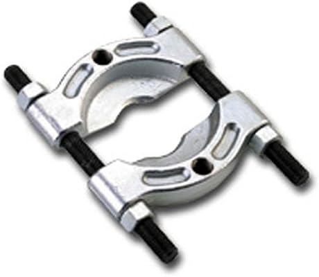

Isn't there a separator available in the right size?
