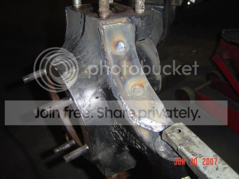

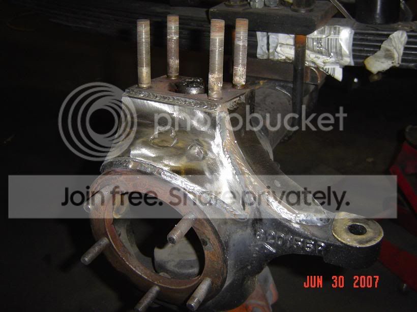

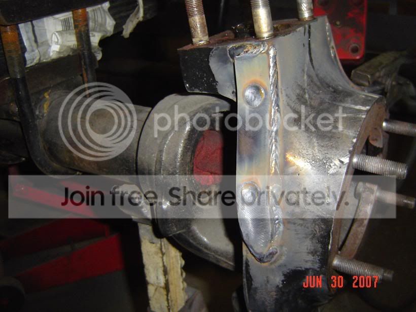

member was asking for pics of these, I hope you see them. I don't have your contact info...
All 1/4" plate and it takes some finishing. They are formed.... sort of. It takes some heat and weld to put them in place.
Will all that welding distort the knuckle?
Haven't put them on the site.
$40 per axle. I'll try to get some pics of an unwelded kit so you guys can see how much forming is needed.
Not if you take your time. Work on both sides at the same time and jump back and forth. Drink a beer and so on.

We've never done any special prep or wire selection. The knuckles weld up pretty good. If I were to do anything, perhaps post heat and slow cool for normalization around the HAZ and feathering into the entire knuckle.
Knuckles on my blazer had no pre or post heat or cooling control in any way shape or form. Been beat on a few times and so far so good.
If you for some reason, think you may need to machine the weld in the future, then you may want to pre heat and post heat and most definitely control the cool down. If not, you'll have a hard time doing any machining later short of grinding. It'll be very hard.
EDIT: Technically speaking, there probably was some amount of preheat in our process now that I think about it. With the press brake we can do some rough forming on the pieces. The rest has to be done on the knuckle with some flame and a hammer. So, the knuckle is getting heated to some degree.
