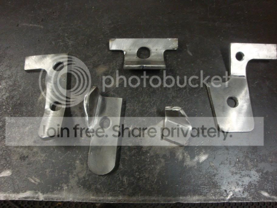

I'm going to take the camera along today, cut your kit and have it ready for shipping and do up another and photograph the install sequence that we use. Maybe that'll make it easier.
5 pieces of steel per knuckle.

The GM kit, this is one knuckle. Both sides come in the kit.

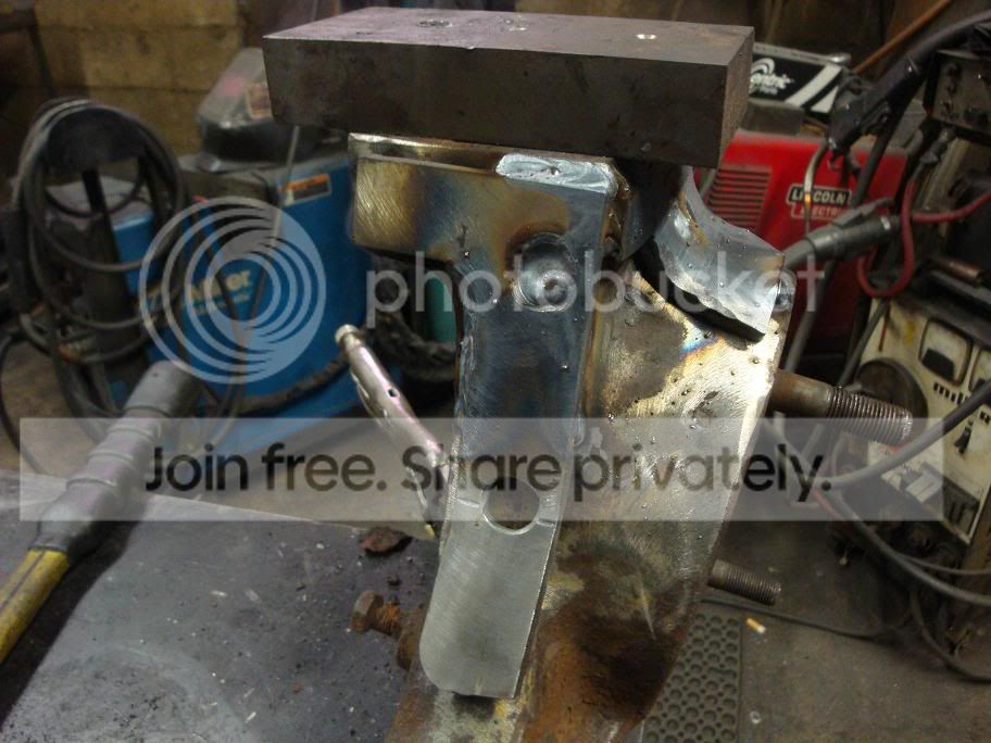

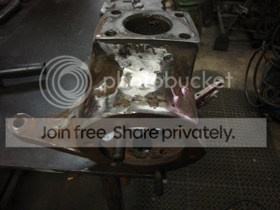

Prepped knuckle. (All studs should be removed I cheated.)

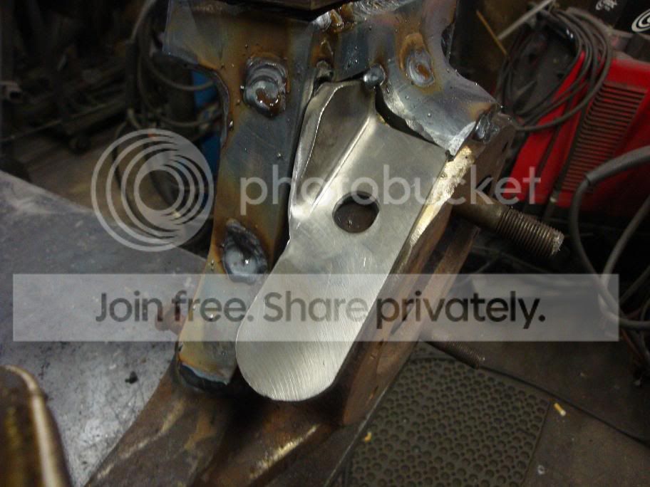

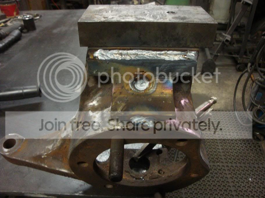

First piece layed in, protect those threads!!
Second piece layed in, some welding and forming.

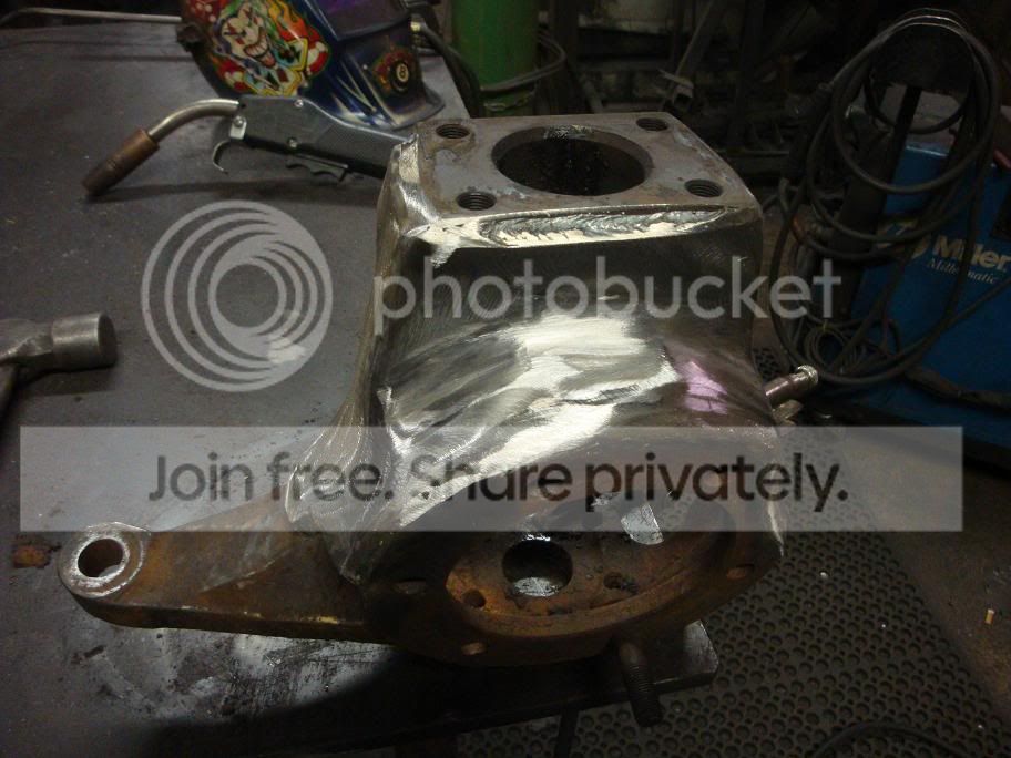

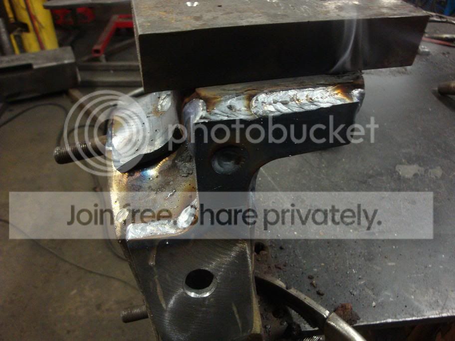

Back to the other side.

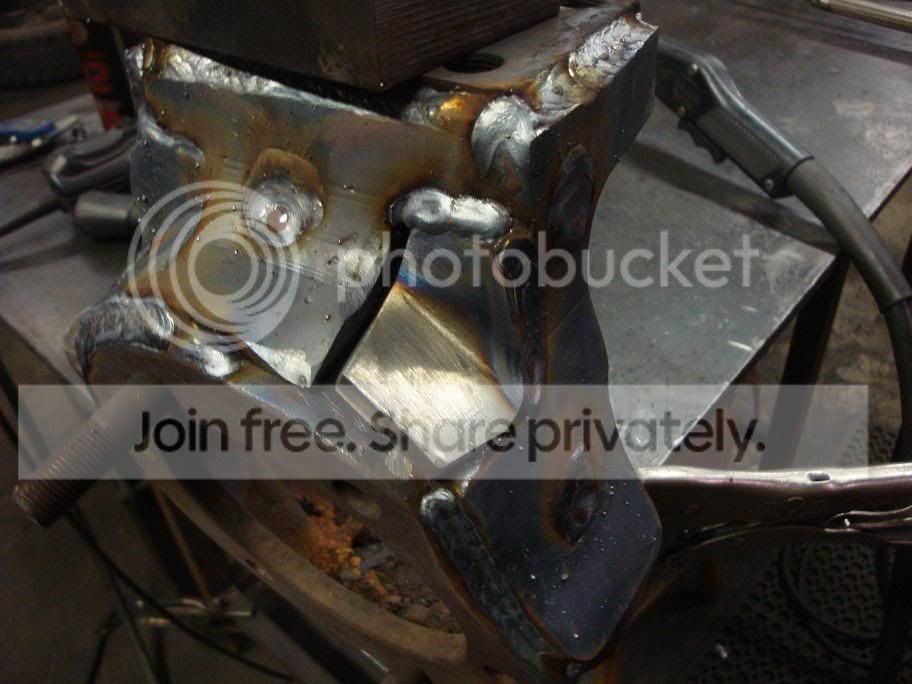

Next piece.

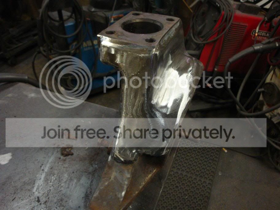

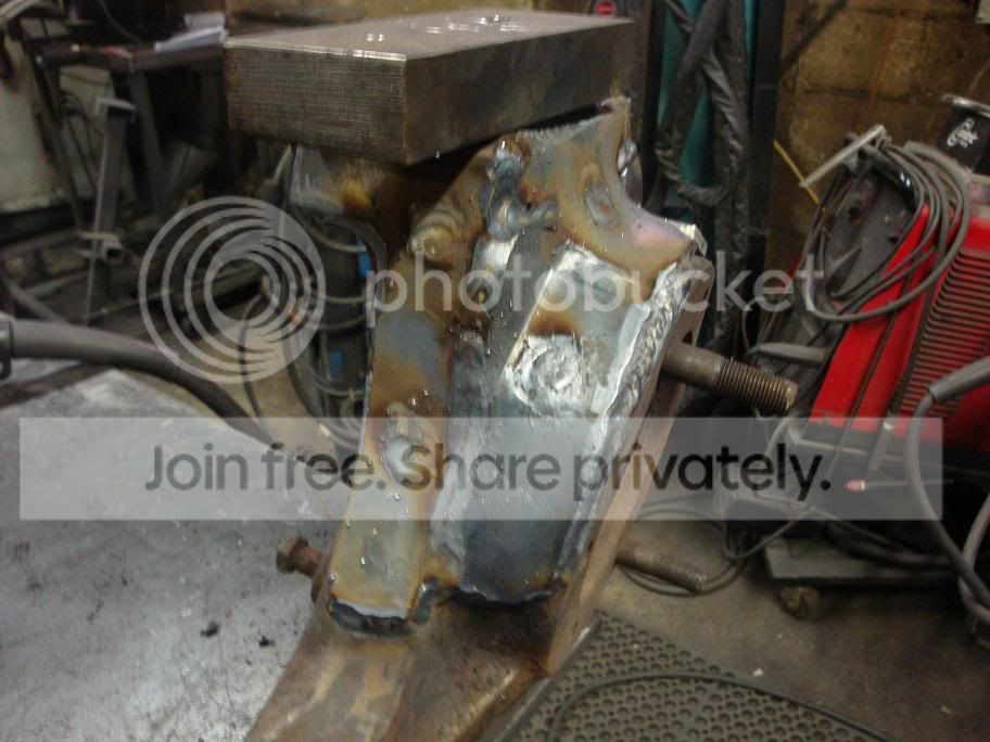

Last piece and finishing up all welding.

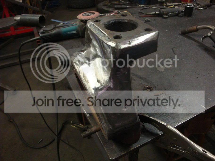

Finished, and cleaned up.
Be wary of the spindle surface and of course the steering arm surface. Weld in either of these areas if not cleaned up could surely cause an issue.
