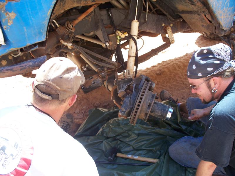

I believe this is how they normally break, his kit would definitely add strength here. I was running high steer with a ram assist when this broke on pritchett.
That's a bad break! I think this would be one of the worst breaks to suffer on the trail.
Somewhere I saw a zip tie repair for this.:eek1:
That's what spawned the epic 7 wheel drive recovery of BB08 fame :thumb:
I'm gonna take a guess, that you may be alittle tired of breaking stuff everytime you go to Moab...? :D
