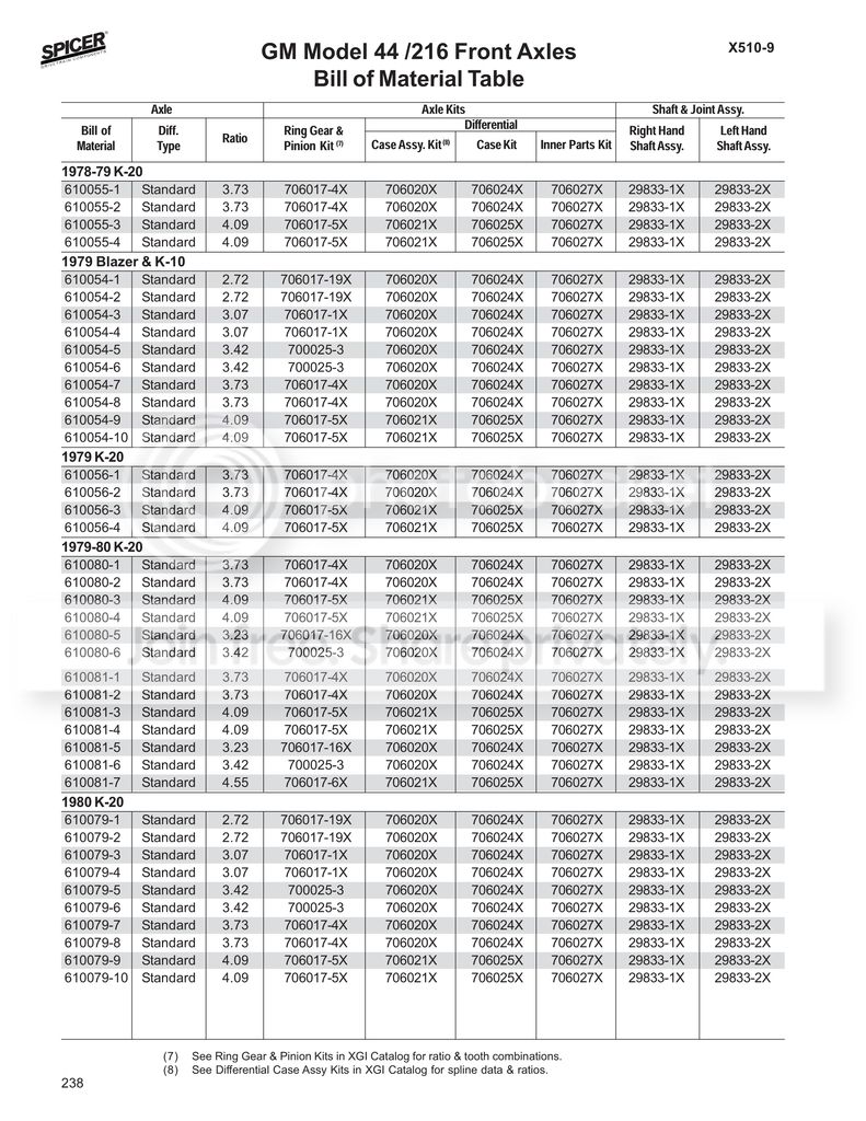

3.31s and 3.42s will work together no problem. There is a bugger factor between the front and rear in all the gear and chain slop in all the running gear.
Toyota guys run 5.38s up front and 5.29s in the back all the time.
