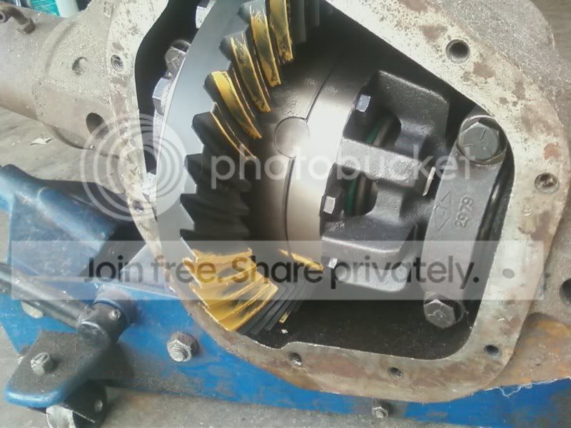

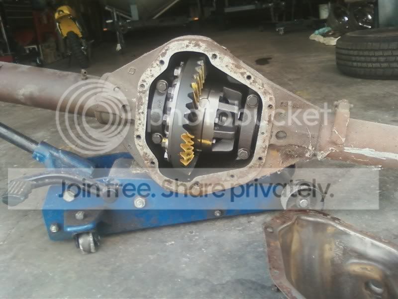

Well, found a 70 with detroit and 5.13's in the scrap pile all brand new
I need to make sure I don't have a HD carrier then I'm going to order the kit and swap them in. I'm pretty it's a regular 70 though
:pimp:
This is a regular 70 right? Can't find any hd markings
It had sl58c so It looks like it is correct. I'll be calling jantz soon :D
