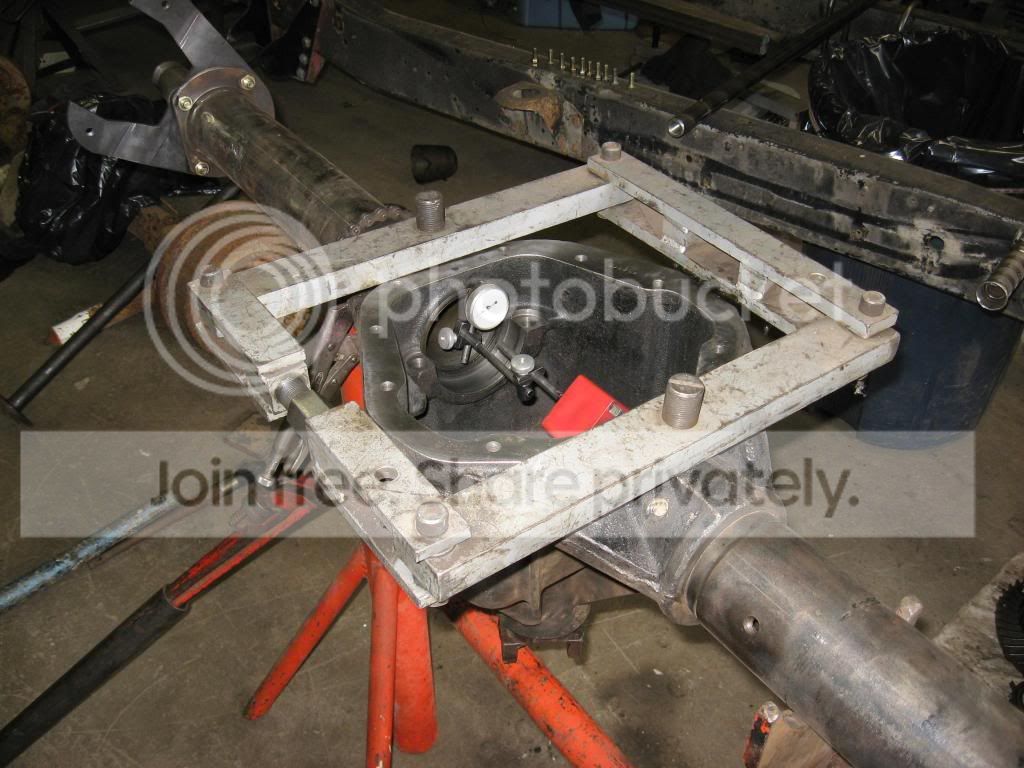

How the heck does that thing work?
Here's a pic of one in use.
Gus
Nice looking unit there. I got a Kent Moore unit a few years ago for about a hundred bucks.
Case spreaders definitely make the job easier, especially when doing it on stands like the pic above, but keep in mind that they can not be used on a front axle when the axle is in the truck.
I was going to use/ borrow one on my 60 front, but It meant pulling the housing out of the vehicle or pull the leaf spring, because the leaf spring was in the way, I decided to not use it after all... on a rear axle it would be killer, but I have a 14 bolt...
