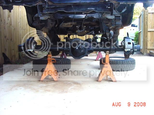

Here's mine - 5.86's, spool, narrowed to 69" & disc brakes from a D60.
