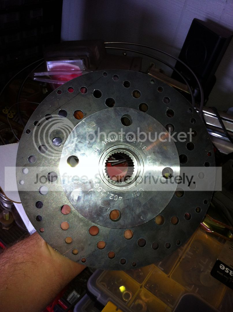

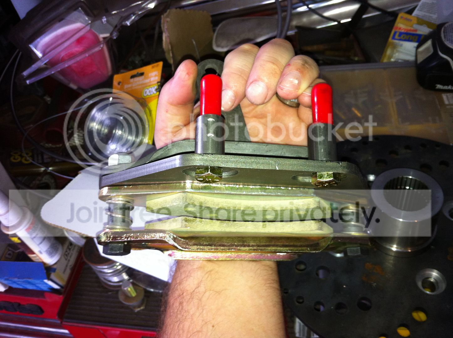

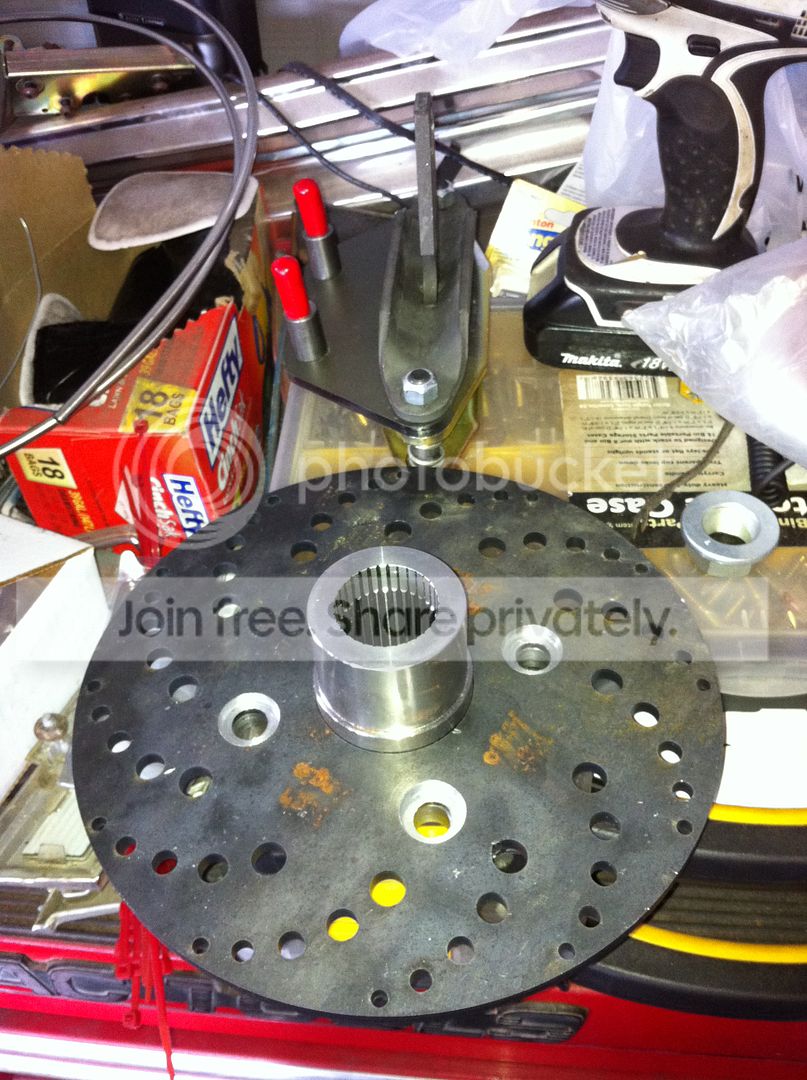

But back to the truck, the rear output and driveline brake showed up earlier this week. I'm still waiting on the driveshafts (and getting a little paranoid that USPS may have misplaced them...) so I need to throw that on there.

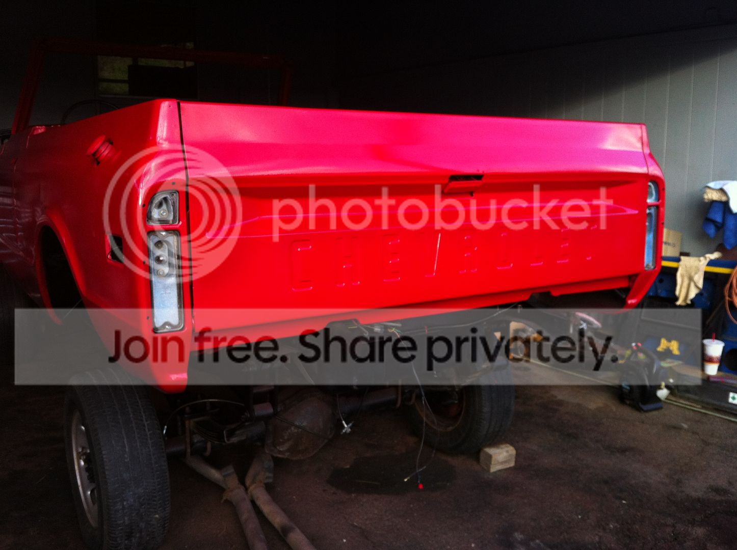

And here are some shots of the truck. I didn't take many of the paint because it still needs buffed more. The tailgate was sanded the least and subsequently looks the best right now. Some other spots on the truck are a little dull still so I bought some different polish that should cut a little better. I should be doing that a little later today.

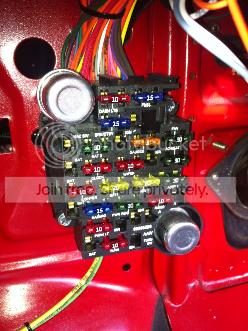

Then a pic of the fuse block. The AAW kit was really nice and went together very easily even though I'm a wiring noob.

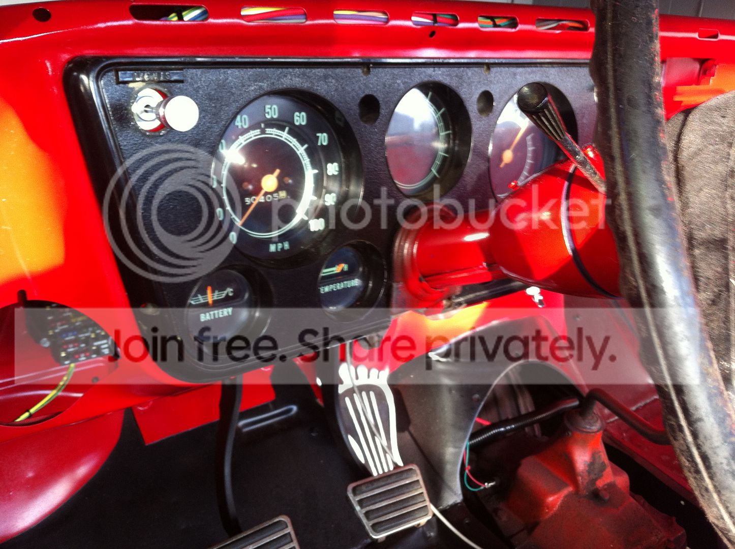

The cluster is in, but not 100% just because I haven't tested everything yet. My plan is to paint the glove box door black to mirror the gauge bezel. I think it should look pretty nice.

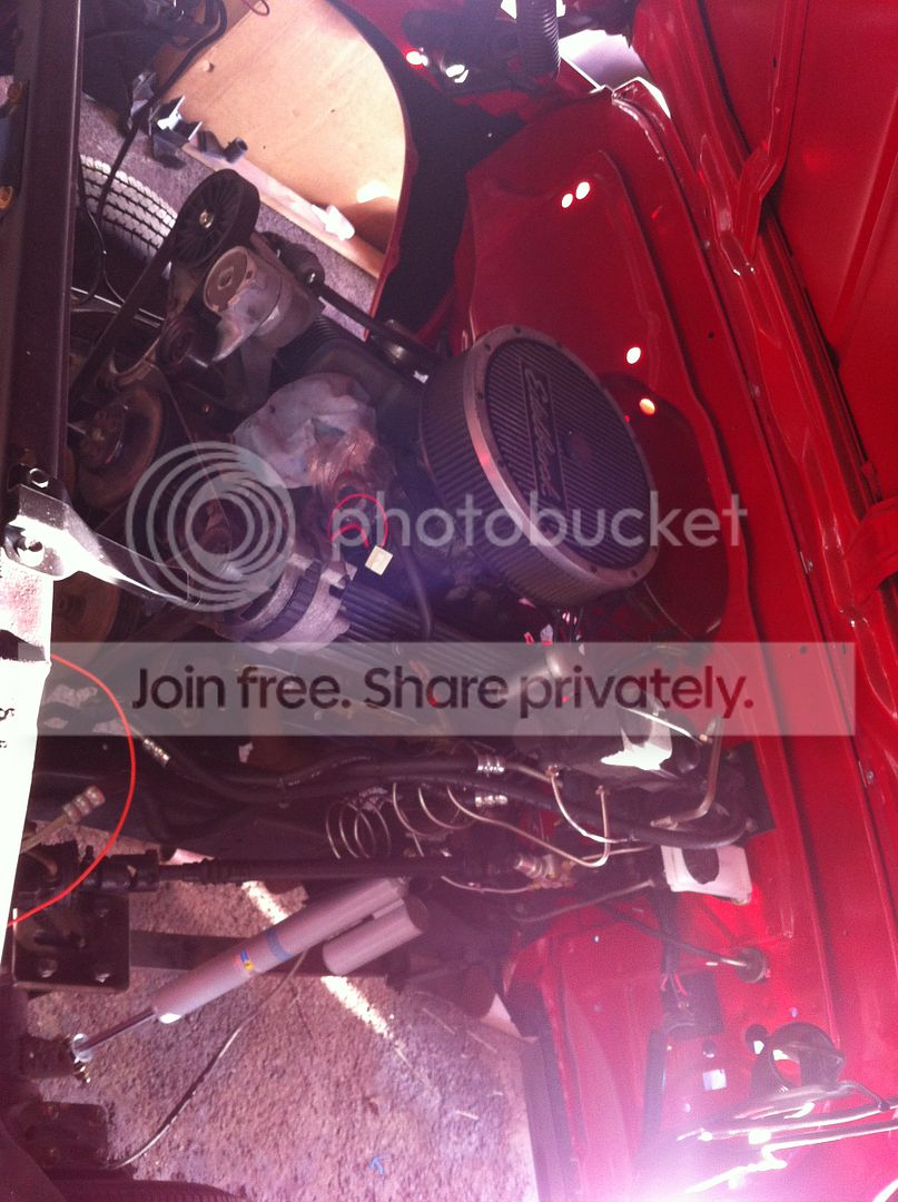

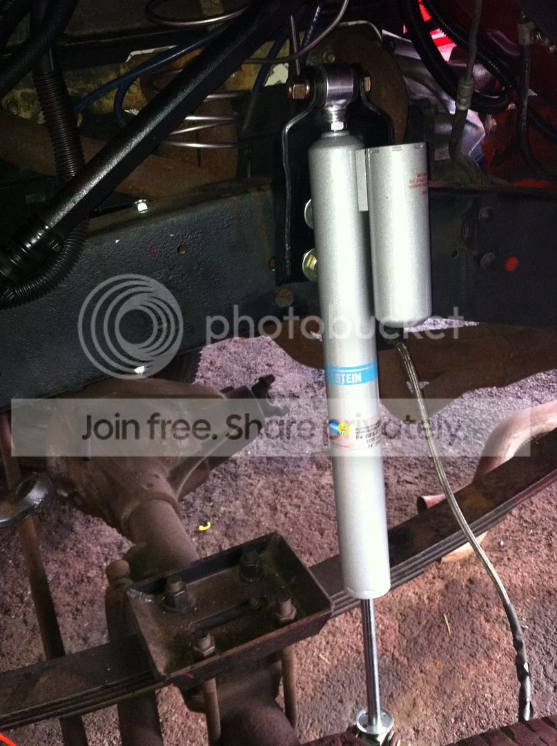

I got my front shocks mounted pretty nicely I think. They're 14" travel bilstein 5150's. I still need to do the rears.
And an overall shot of the engine bay. The radiator still needs to go in, and I need to wire in the fans. There's still a bit of stuff to clean up under the hood, not to mention putting the inner fenders in and whatnot.

The aaw kit was awesome. I don't think I reused anything. Just cut certain wires to length, terminate and choose which circuits I wanted. Worked out really nicely.
Agreed. I completely rewired mine. The AAW kit was really well put together.
American Auto Wire for the win! Altho I did reuse some of the old rubber connectors because they seemed less cheesy than the new fangled plastic. I think I reused the turn signal to plug in to the plastic housings, rear harness connector at the rear cross member and the steering column one because I did not like the new flat style. (the original is curved around the column)
