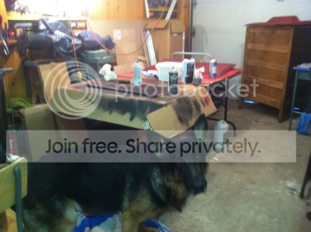

It was tough because its been cold and dry and we have 3 german shepherd dogs so there is a lot of dog hair floating around.
The trick for the static was just to wipe it down again with a warm damp cloth, let it dry quick and then quickly apply the SEM paint. Looking good so far.

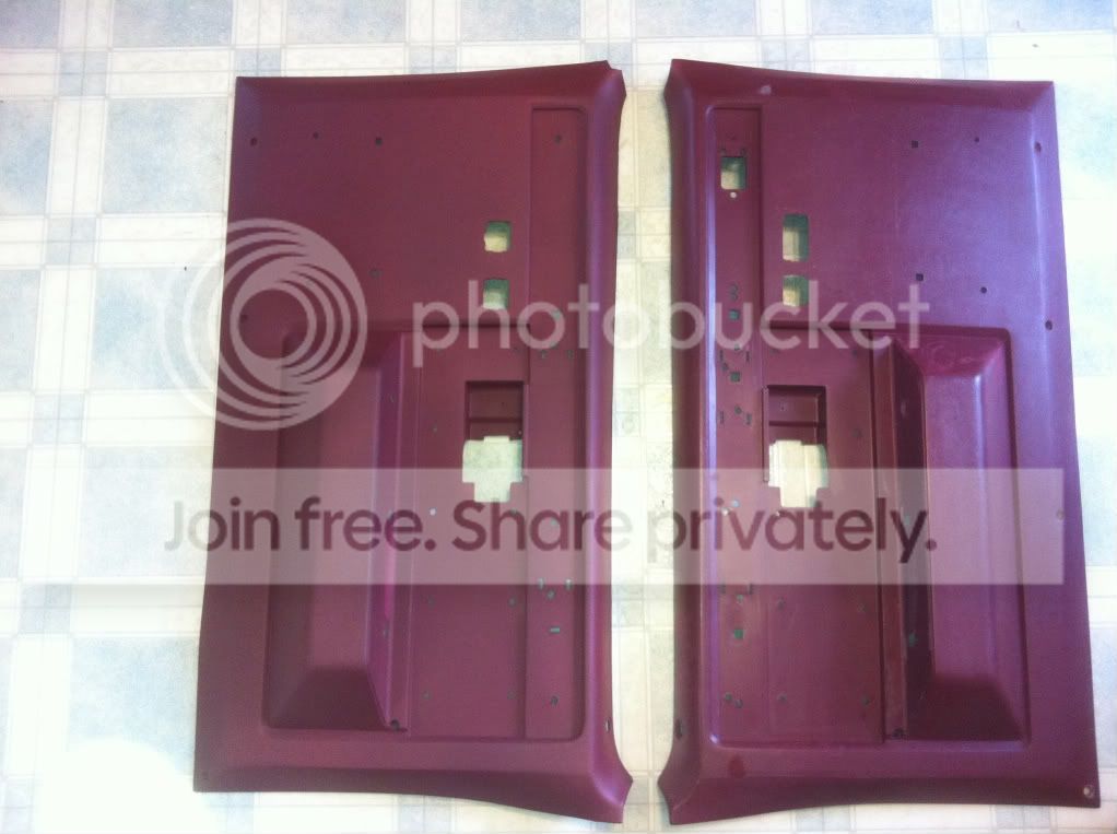

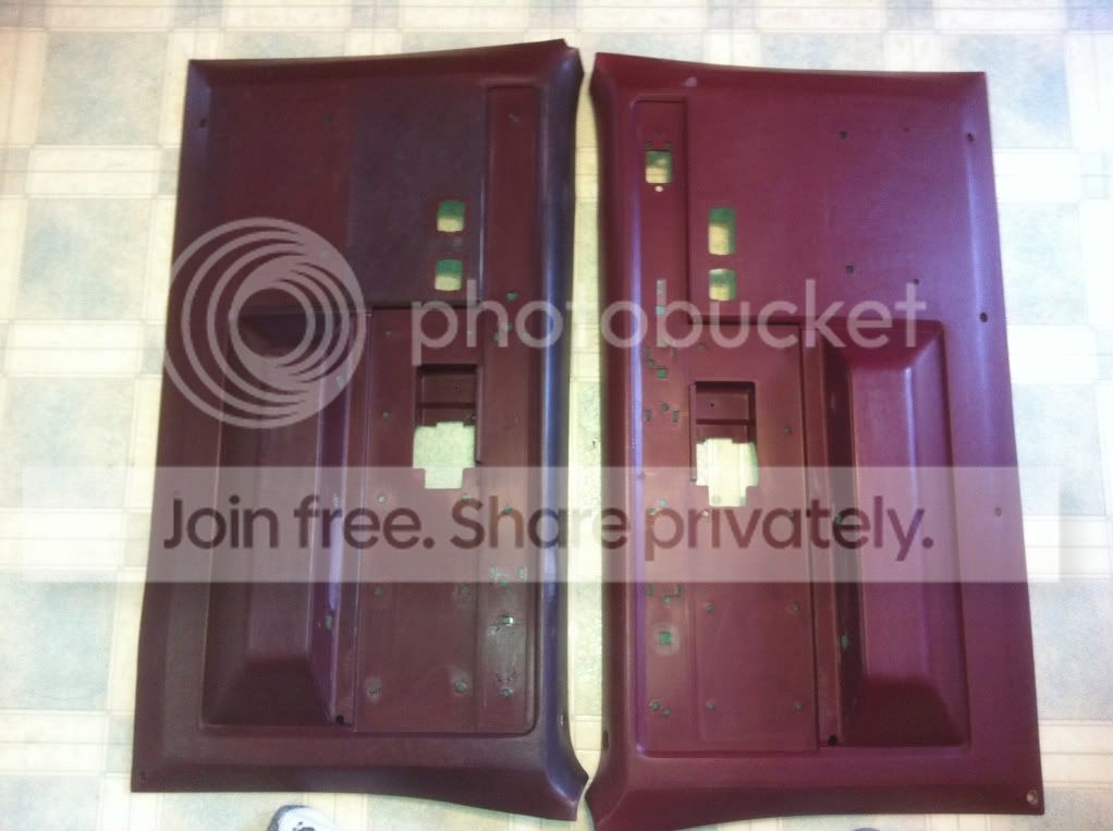

Here is before (GM MAPLE vs GM RED)
This is after 4 coats of Red SEM colorcoat (Mixed at auto paint shop-I can get the codes if anyone wants them)
As you can see it was slightly different than the original GM red on the right, so I decided to paint both to match.

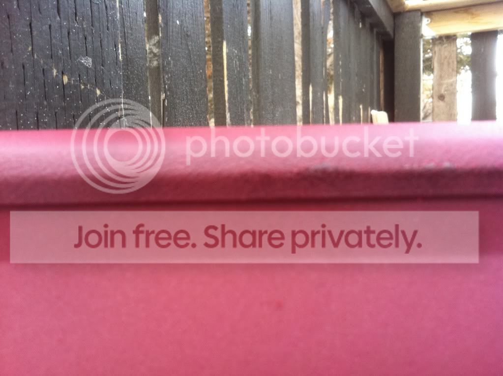

I didn't like how it had such a flat finish to it. Didn't look like factory to me. I was also concerned with how easily it seemed to peel off. Just by picking the door panel up I accidentally rubbed some of the paint off:
So, I painted it up again and hoped that it would eventually set (although skeptical... I have a german shepherd and he loves to stick his head out of the window... His name is Dawson, and he has big claws :doah::thumb:)

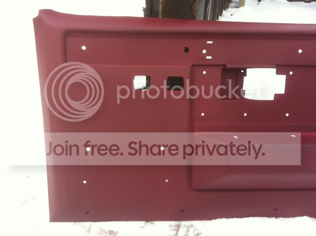

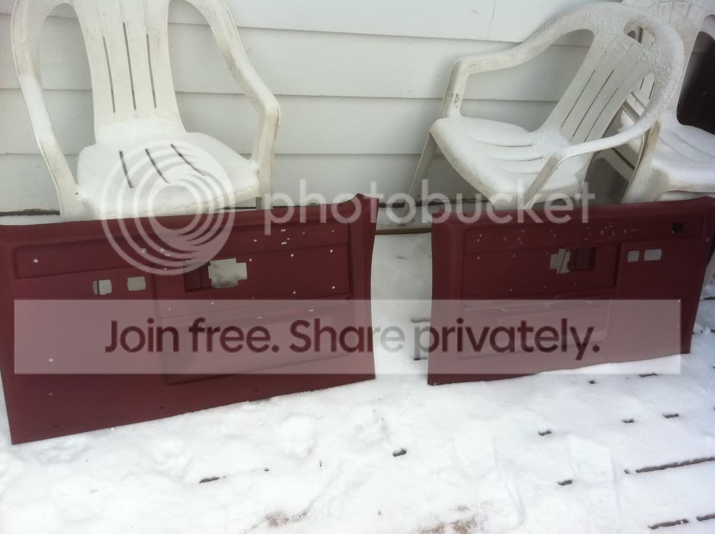

I think the clear coat will help alot with longevity and strength. I will report how it lasts over time.
The clear coat made a HUGE difference in the looks too. Looks better than factory now. More pics to come soon in above reserved posts, Deuling :D
