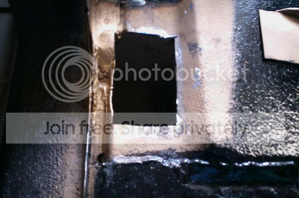

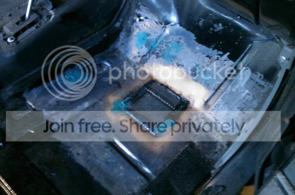

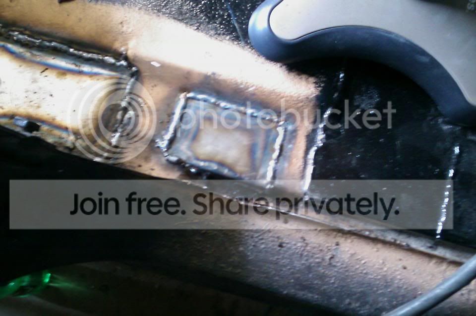

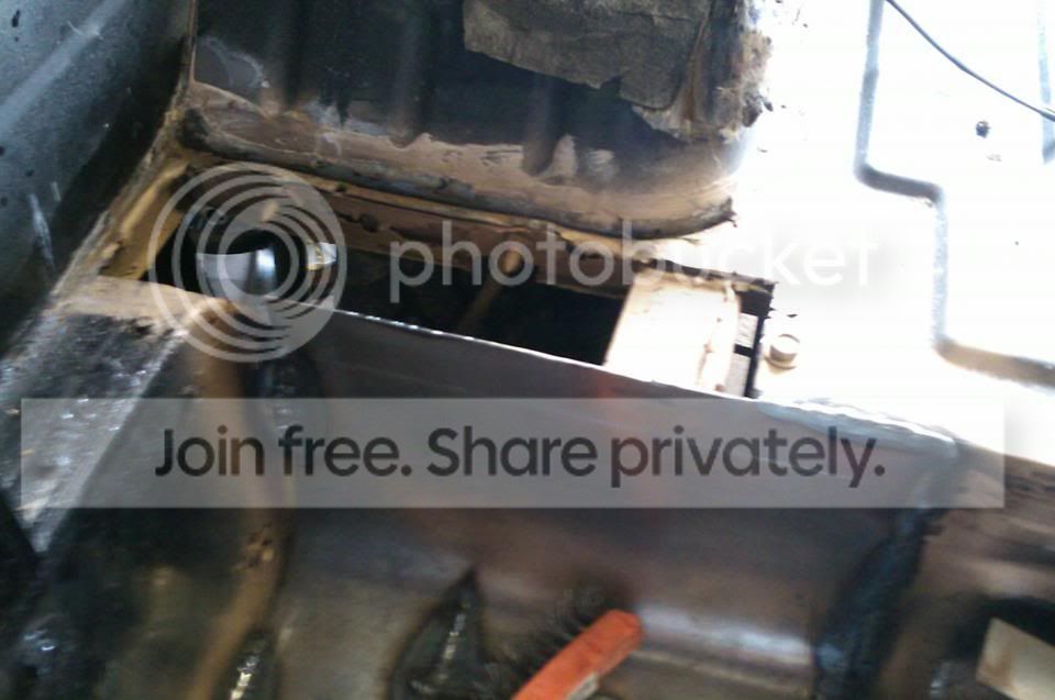

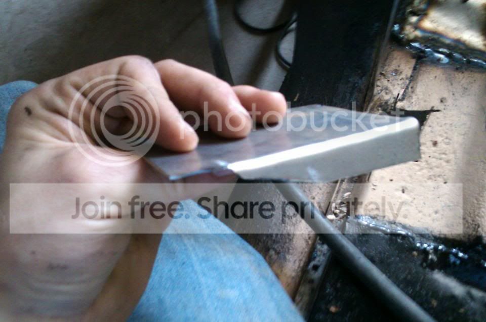

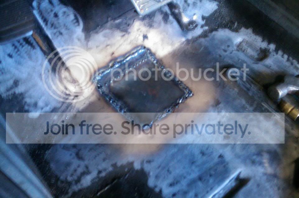

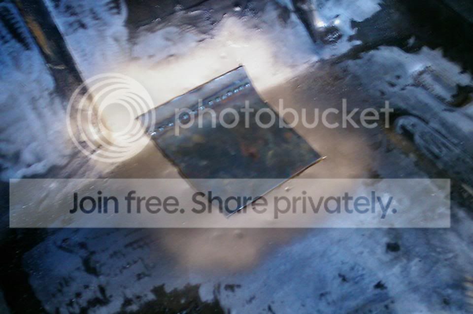

I fought the rust and....
I kicked its AZZ!!!!! :woot:
I had just laid down the EZ-Etch rust desolver here, It was clean metal when I started welding the panels on.
Suck it rust :D (my lungs are loving the new respirator)

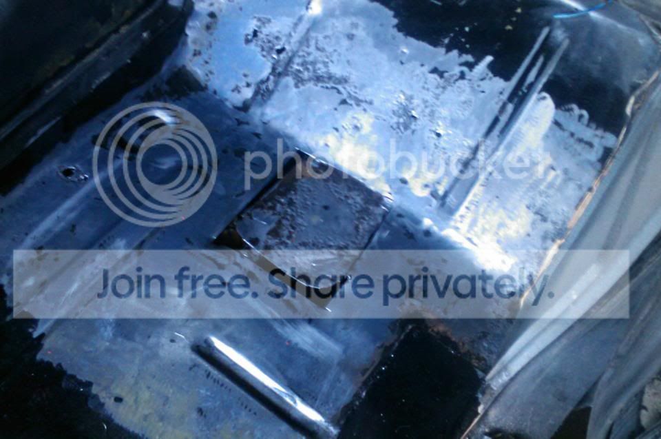

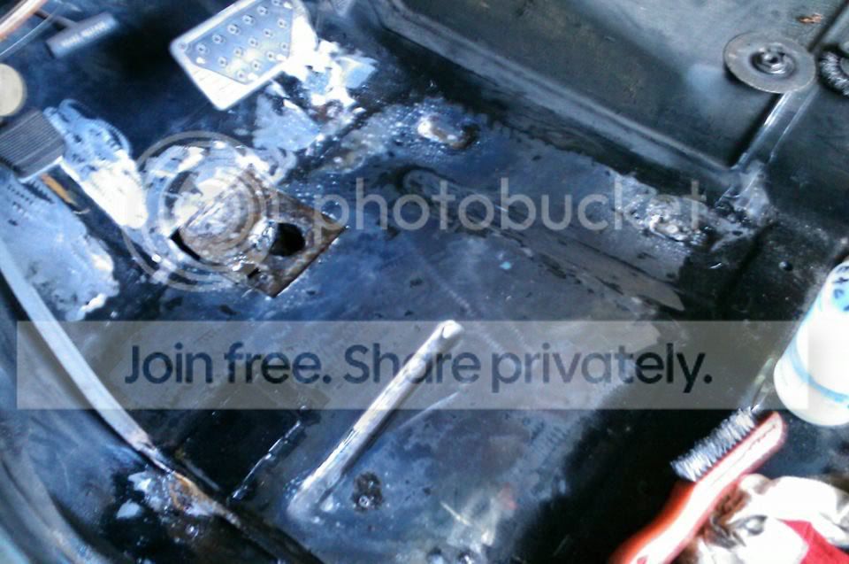

Yup. Doing the floor with bedliner (which has been seam sealed already) then putting it on the lift and sealing the bottom and coating that in bedliner. The liner xtreeme kit i ordered today will be here friday and makes 3 gallons worth. Ill prolly use it all lol
I'd prime it just to be sure. I'm anal about rust.
Uhmmmm...not sure if that's a good idea unless you plan on spending an all nighter on it. POR15 is pretty slick and hard after hardening. I know it can be top coated but when I thought about it doing the POR15 and then the top coat via their instructions would have taken over a day.
Catnaps in between?
Ive already done most of the rig in it. Putting 3 coats on everything tuesday, scotchbrite pad sat morning,clean, then bedliner. I GOT THIS $HIT!!!!:thumb:
Okay. Just make sure to prep prep prep.
I skimped one time and after spray painting over the POR15 it eventually just peeled off the POR15.
