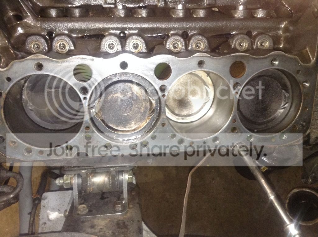

They are all fecky. I think I was way lean. It was stinky at idle, but I never thought about (or really new) that the idle circuit and power circuit in the carb is seperate (or existed).

So after talking with my engine builder, he said running it too lean on open throttle is what caused my issues. Which after talking to a few other guys that have some engine experiance, they all seem to have the same thought.
So carb tuning kit is in the mail, along with some other parts to get it a bit more dialed in.

Whats funny is with that blow out, the #5 cylinder got completely steam cleaned from the steam ports lol.
Water under pressure and heat will completely dissipate carbon. I ran an Edlbrock prototype water injection system on a 383 in 1980-81. 40k miles later the engine was pulled apart for inspection.
Clean as a whistle. Cylinders measured the same as when assembled. The truck pulled harder and ran cooler with the injection.
So what your saying is..... Tap into steam ports, run into intake and have water injection system :whistle: :haha:

Vic Edlbrock said they could not get the kit to sell because nobody would spray water into their engine on purpose.

Its funny cuz that cylinder looks brand new, and no scratches. It was probably making more power becasue of it too....
Well until it blew. I could feel it dogging a bit after that.
