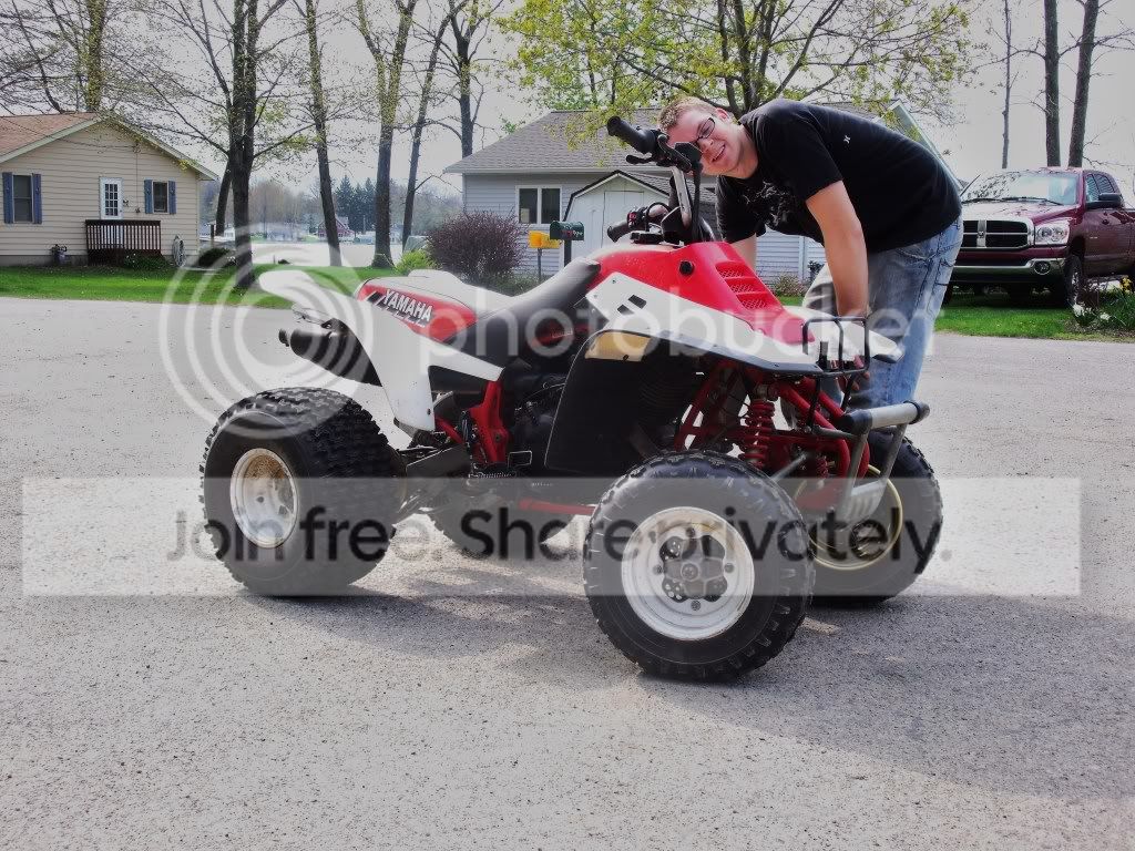

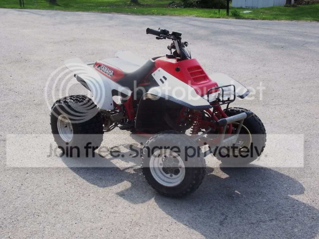

I just picked up this puppy today from my cousin for $750.
Its a 6 speed, has reverse, and electric start and pull start!!!
Im diggin it, any sweet cheap mods for these??? I have never owned a quad or any toy like this for that matter, things to look for, watch out for??
I dont like the short wheel base very much, im hoping that someday I will be able to extend the A-Arms or the rear and give it a bit longer wheel base.

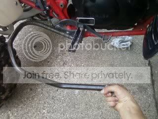

Plans for now, make some nerf bars so my legs dont get sucke in by the rear tires, and make a new front bumper, both things I can do for free because I can get pipe from work, and I have an untouched 16 ton pipe bender just calling my name!!!

And with the nerf bars I only weigh 145lbs so I think 5lbs of half inch steel pipe for free compared to $100 to buy some alluminums that weigh one pound... I will make them removable so if it really affects it that bad it will be a bolt or 2, no big deal. At the moment its def on a budget because I cant afford to spend much on it lol, I need to focus on the truck for sure.

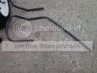

And you guys said I couldnt make my own nerf bars lol. Made them for free, they are perfectly semetrical and maybe weigh 6lbs. I think they turned out really nice and I got to play with the pipe bender for the first time and got to do some welding :thumb:
All I need now is some sort of nylon strap material and to weld the mounting brackets onto it.
At $100 for the cheapest ones out their and the hour maybe it took to make these I ot to sell these SOB's!!!
Wow I totally wung it and didnt look at any designs and look how similar they are to these. Maybe I should be a pipe fitter after all lol
