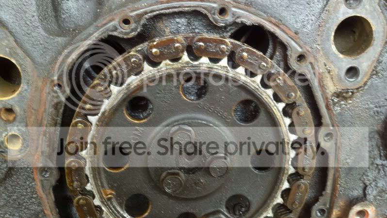

EDIT, Just for fun here is what a worn/stripped timing set looks like. You can see how although the teeth are catching the chain, how they can/will skip. Now, what i dont know is if that pic is of a gear that was originally nylon toothed or not, and if the 91 would have originally been nylon toothed.
