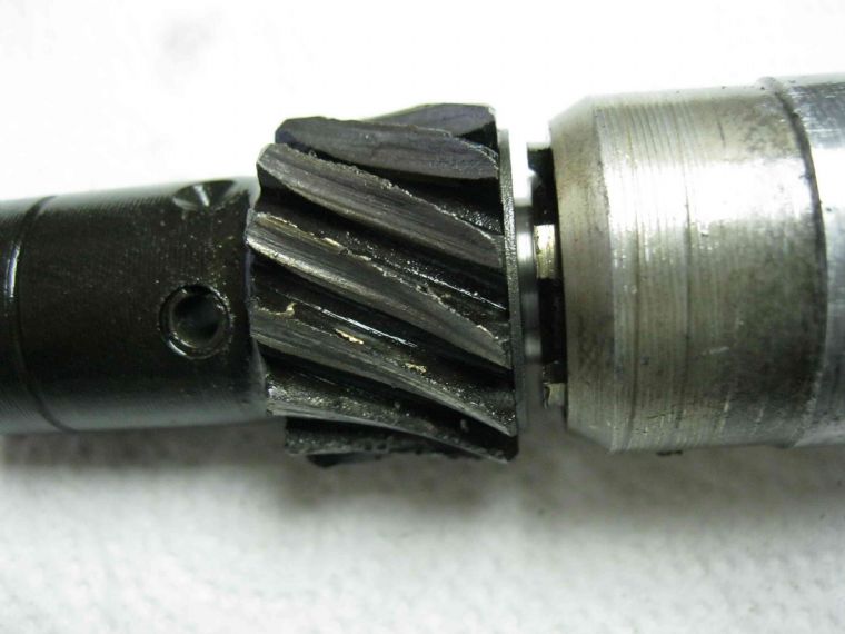

Also just for fun, here is a stripped dist gear. Again, you could see how it could still grab.

Been driving 69 AMX for a couple of months with a 1978 Long block 360 recently installed. I took the old distributor out of the 390 and put it in. All has been pretty fine, i.e. it has been fast and starts well and runs smoothly UNTIL I downshifted on the way home from 4th to 3rd at about 45 mph. The car backfired a bit then died. After towing the car home, I found I had spark and fuel so I put #1 at tdc and pulled the distributor cap. The rotor was not anywhere near #1. I pulled the distributor and the gear is very rough and worn down on several of the teeth (see picture).
:eek:!...hate to see what the cam gear looks like on that AMC--probably just like the dizzy gear!.........................................................................................................I found the nylon govenor gear in my '81 G10 van's TH350 looked just like that,when I yanked the govenor out!..bought it for 500 bucks with a "blown transmission" back in 1990--after I replaced it with a used govenor,I drove it another 40,000 trouble free miles..................................................................................................Though I worked auto parts counters for 20+ years,I sold very few distributor gears--about the only vehicles that "ate" them seemed to be mopar slant sixes,they were nylon gears--but even those were not hot sellers....I was surprised to see how many gears Dorman now sells for lots of engines,I didn't think enough of them failed often enough,to have much demand for them.....
Can't that kind of gear damage happen when one gear is softer than the other. I don't exactly remember but it was something about a brass dist gear or cam gear getting stripped because the other gear was a much harder metal. I only mention this since you said the dist is new. Maybe it didn't like ur cam gear.
