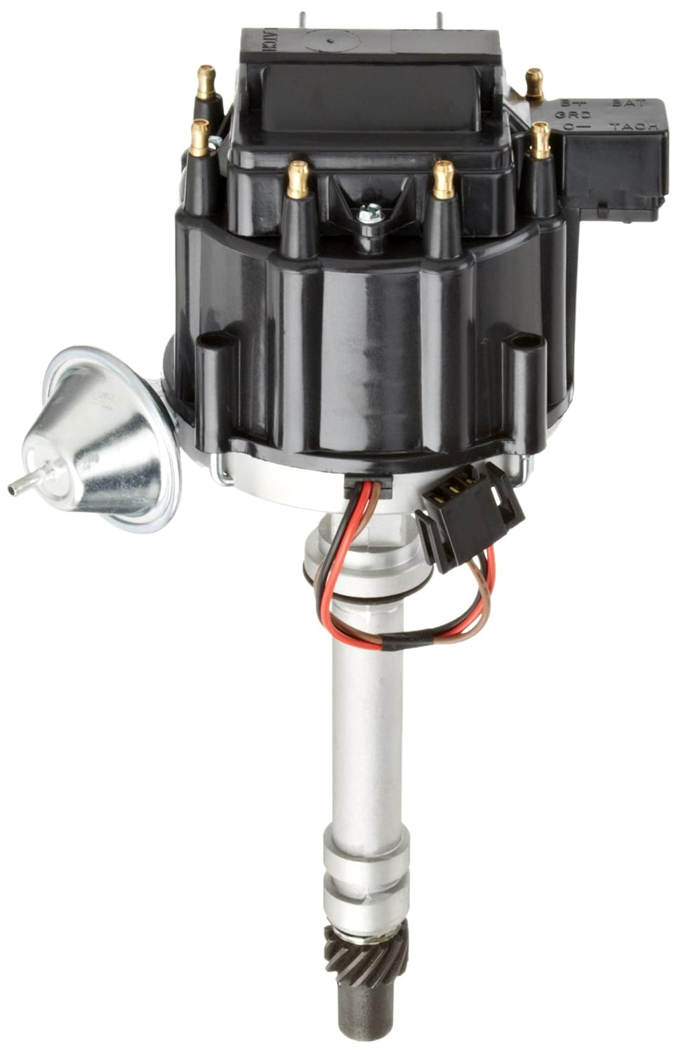

So I can do this one piece at a time or I can go ahead and get this:
https://www.amazon.com/gp/product/B..._title_srh_1?ie=UTF8&psc=1&smid=ATVPDKIKX0DER
I can get an HEI module for $30, but the pickup coil is $60....and on and on and on and on
I only got a little money right now...who thinks carburetor or fuel pump?
Who thinks Distributor?
