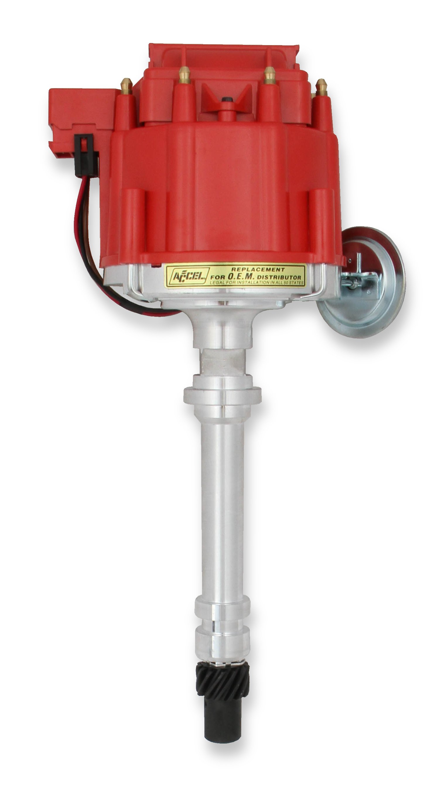

I ended up buying this online and will pick it up tomorrow because I wanted to work on it this weekend:
https://www.holley.com/products/ign...MIpPuuxd214gIVgYnICh04UQzsEAQYASABEgIh4PD_BwE
I hope it is a decent distributor...would have bought ACDELCO if it were available:
I hope the Accel brand is ok...I have looked at some posts in here and some don't sound good
I could install the AC DELCO coil that I bought into it??
Accel isn’t bad in itself. I’ve had luck with them in the past. But I think anymore nothing is foolproof out of the box. I’ve seen all kinds of parts brand new out of the box not work.
It isn’t known good until you see it running. Outside of that don’t trust anything even if it’s brand new.
I have three of those accel dizzy's and they work great.. my buggy had a MSD dizzy with a 6a box... the box died out on the trail one day and I didn't have a spare... that cost me a weekend of wheelin'... when I got back to the shop, I pulled the whole mess out and stuck the accel in it's place.. never a bit of trouble out of it since... MSD did replace the faulty box for free, it was out of warranty, so I have to give them props for that...
I'm giving MSD a try again with my LUV truck SBC .. complete billet dizzy, 7al-2 box, wires, hopefully all goes well with that. I have read that MSD suffers from a lot of DOA components lately. Apparently they have gone overseas for a lot of their stuff and the quality control has deteriorated recently...
But I digress, Accel has been pretty solid and I would recommend them to anyone for a street daily driver..

this one is 59107C whatever the "C" is for
