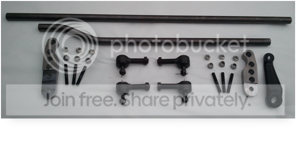

Yes indeed nice looking rig. From what you described about your use the 44 should be fine. I run one and it had held up nicely for years untouched with mild wheeling. I still run it, only it is fortified a wee bit now as I treat it a wee bit harder. Steering box area, offroad design makes a weld on repair and also a bolt on brace. I would recommend both as that is a very weak and vulnerable area of your frame.
