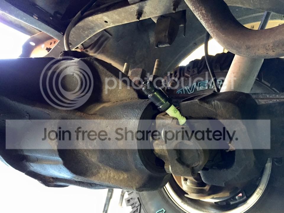

After spending a half hour searching the engine bay, starter area, frame rail, and floor...
I found the hide and seek champion....
I hate when they do that. Had a socket extension do that didn't find it till I couldn't move in 4wd

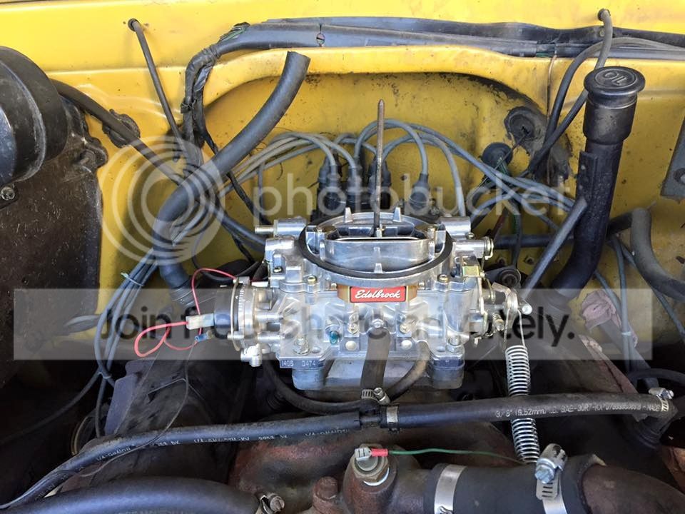

No, the tee off of the front of the carburetor.
Martin
On end goes to the vacuum advance on the distributor not sure about the other. I'll have to stick my head in there tonight when I'm doing the pinion in the rear end.
No, there is a different vacuum line going to the distributor. Your PCV valve has a hose running off of it to a T, the T runs to the carburetor, and the other end runs out of the picture.
Martin
Ah, to your charcoal canister.
It's not on that side on the newer stuff.
