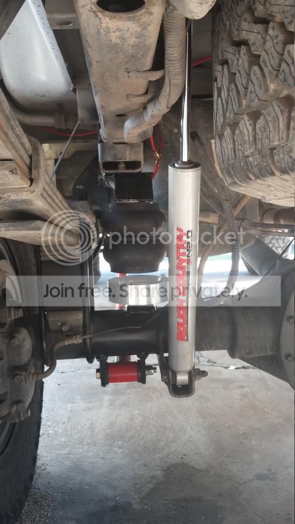

Every pic I can find of this truck on the net shows coilovers. Hopefully someone has a pic stashed away of his setup with bags.
He was coil over, with bags for overload purposes, on top of the top links.
One thing about the pics I posted. Those bags are from a cement mixer. Rated at some ridiculous number. Our local semi wrecking yard has em for 150 for the pair.

For a daily driver, occasional wheeler and tow-rig I'd run a shackle flip with a good traction bar and some cradle mounted air-bags. It's cheap, flexes well and when you need the stability and load carrying capacity the bags are there (but they aren't tied to the frame and axle so they don't limit your articulation).
I mounted the bags on my tow-rig this way and I'm very pleased with the outcome. They never touch while daily driving but with a load in the bed or with my trailer hooked up they drop down in the cradles and I can air them up to set ride-height.
Daystar sells some cradles to make it happen.
