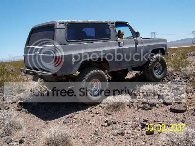

Stock 350, close to 47" tires 21.5" wide.
