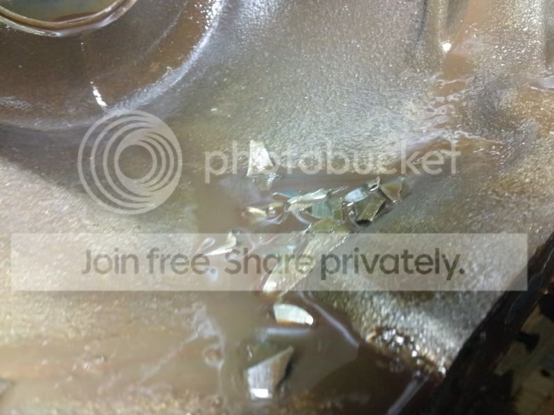

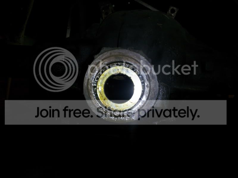

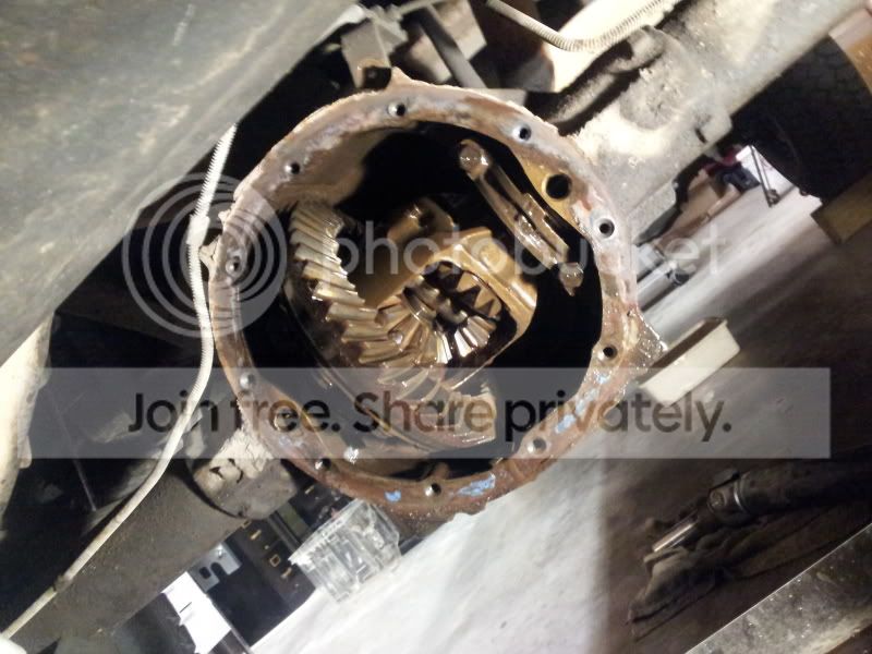

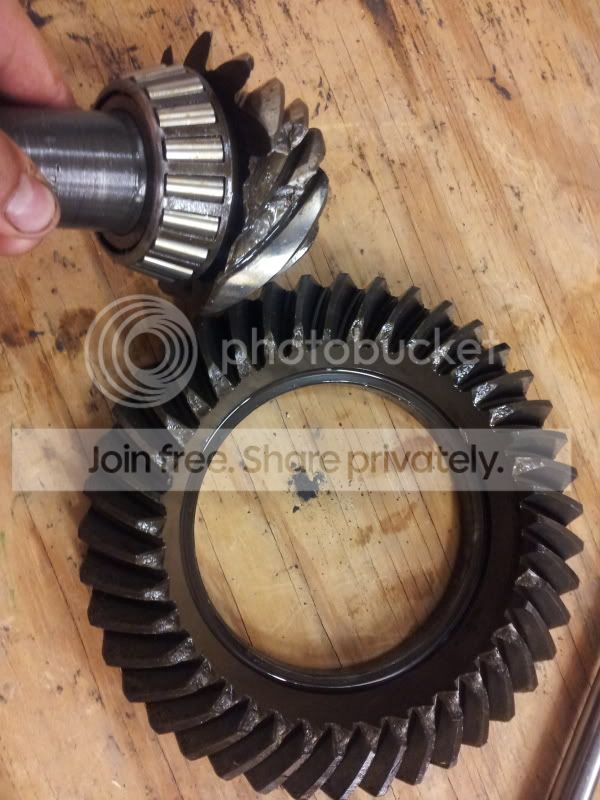

all of this comes in light of me taking apart the rear dif earlier tonight after trying the recommendation to drive with only the front axle engaged. sure enough the sound was gone in all gears at all speeds. i drove the truck into the garage and started wrenching
after a downpour of muddy rusty gear oil i saw this:
a little bit of work with a rubber mallet and then this:
upon closer inspection:
:yikes:
wonder where those came from
oh
so that's what was making that gosh awful noise. guess i'm out a transmission and a whole lot of faith in the word of the previous owner.

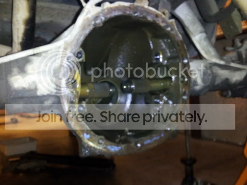

oh yeah also how do i get this bugger out:
also should i be looking for and 8.5 unit or a 7.5?
