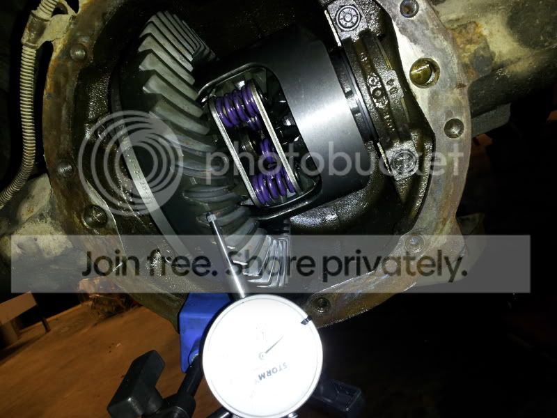

anyway, i made some progress, got the rear end finished for the most part.
backlash set to 5.5 thousandths, pinion nut to 16"/lb
