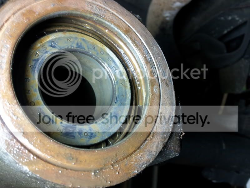

i would be lying if i said i spent most of the day changing the brake shoes and wheel cylinders on the rear. i think i stared at this bearing for a solid hour and tapped around it with a screwdriver for another hour before giving up. i'm almost positive my bearing and seal kit will come with this bearing and race so i'm trying to get it out but have not had success. the stupid chilton book is of zero service. i tried to make sense of this but i'm a little slow:dunno:
Seal comes out with a screwdriver if you don't have a seal puller. Tap a flathead screwdriver under the outer lip (metal) of the seal and twist a little until it comes up. Then go 180 degrees to the other side of the seal and repeat. Kepp doing this a little at a time and the seal will 'walk' out. The bearing will come out by hand after that, but the races will have to be punched out with a drift or something similar. Don't be afraid to use a steel drift to get the old races out, but DON'T use a steel punch to put new races in. Use brass or a race installer you can borrow from autozone. Good luck.
still can't figure it out:frown1: also the larger race for the pinion gear seems to be unmovable.
pics in trade for answers? :D
if that is the input bearing of the rear end, you can drive it out from behind if all else fails.
but you should not have to.
stick a prybar sideways between the bearing and seal and pry out.
there is no outer lip, it is pressed flush with the housing
As Fordum said, you have to pry it out, use a sheeps foot, or you can use a coal chisel, tap on one said so the other starts to pop out, and if all fails punch it out from the back side.
see that dirt filled gap in the picture? is that where it is supposed to seperate? i feel like a moron that i can't get this thing.
In the picture you see there is a thin gap that goes around the seal and is just inside the housing, the seal will separate there, it wont com easy it is going to take a little work, especially with all that water and dirt build up. After that seal comes out the bearing will come out easily, and then you will have to punch out the race.

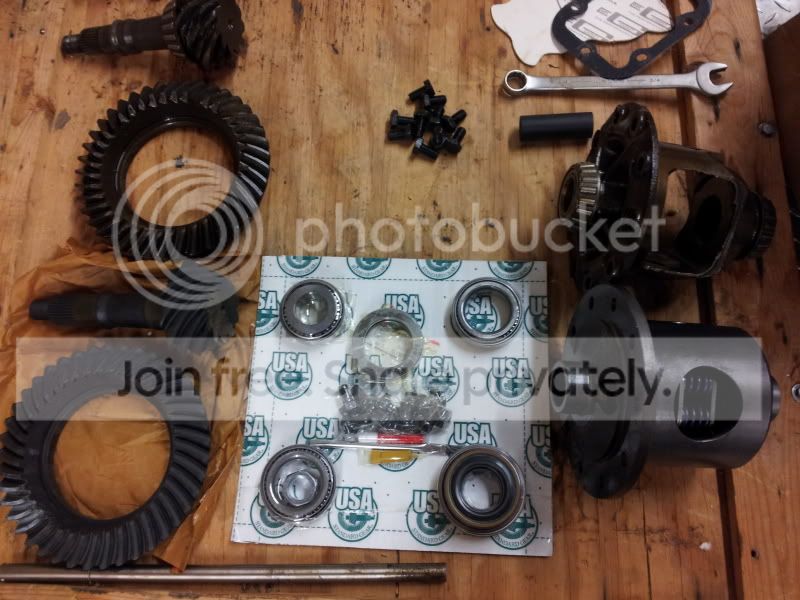

got the new bearings, gears, and carrier in. i've still to remove that last seal and bearing from the race but it could be from lack of trying:whistle:

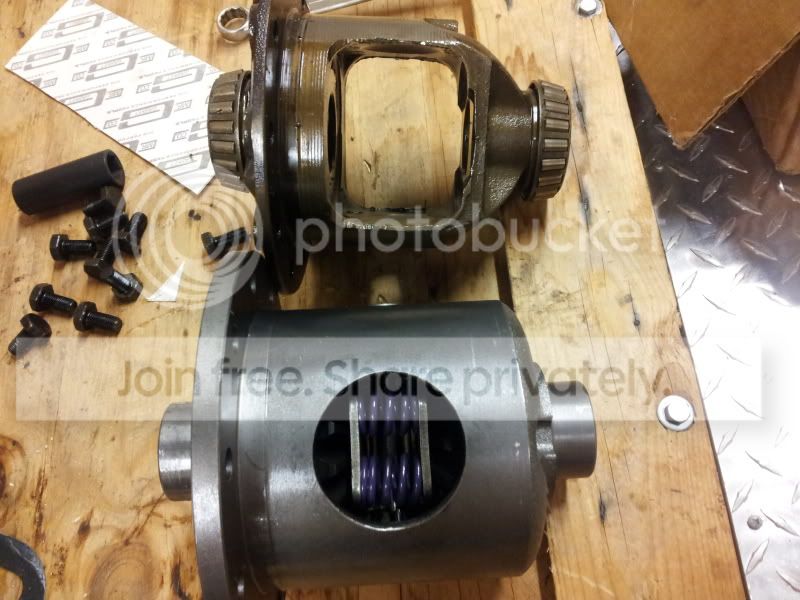

reinstalling the old carrier seemed simple enough, just slide the axles in and slip the C-clip on to the end of the axle but with the new LSD unit i'm not sure how to go about this.
also a heads up on the brand new Richmond gear excel ring and pinion: it is indian made and in honesty does not feel like quality. if i had known this is advance (probably could have done more research) i would have spent the time and money at a yard pulling some used 3.73.
anyway, the LSD looks nice and beefy though. hopefully we'll be driving by monday! without any clunking noises!

also when should i torque down the ring gear bolts? outside of the housing on a table or something or in the housing with the axles installed? i found a video of a Chrysler LSD installation and the guy put the C-clips in through that window, in the middle of those springs. i don't think that will fit on mine though because my springs are much closer together.
No prob on the info anytime! Install the ring gear on the carrier prior to installing in the housing. You should be able to get the c clip in after you have the gears set-up correctly.
