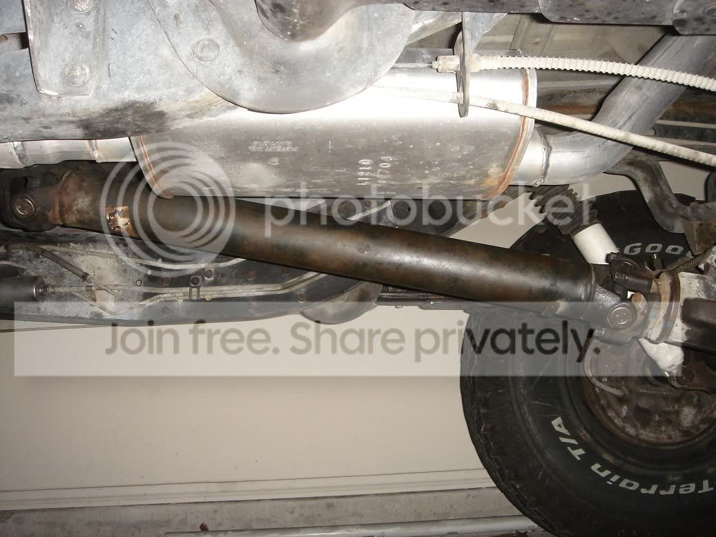

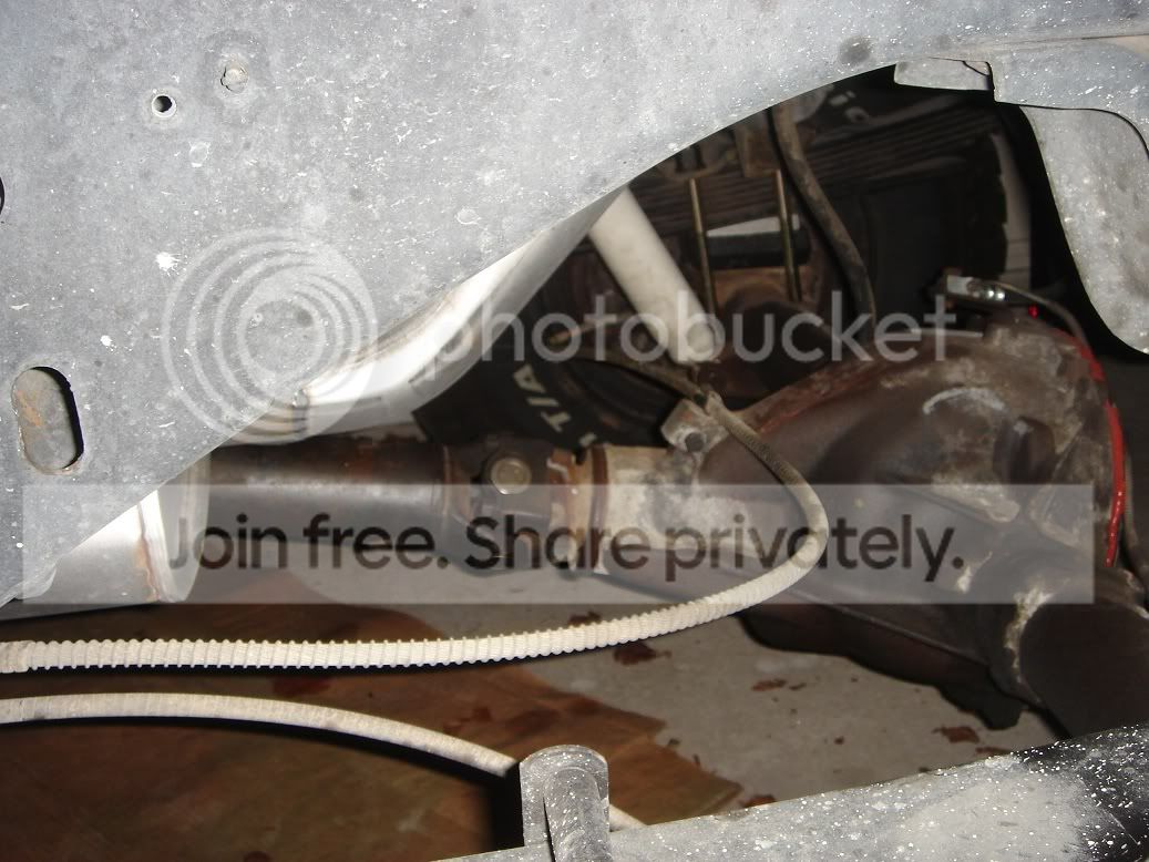

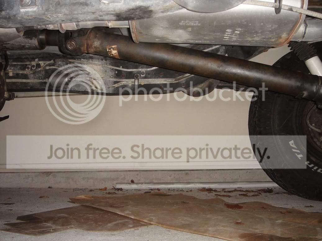

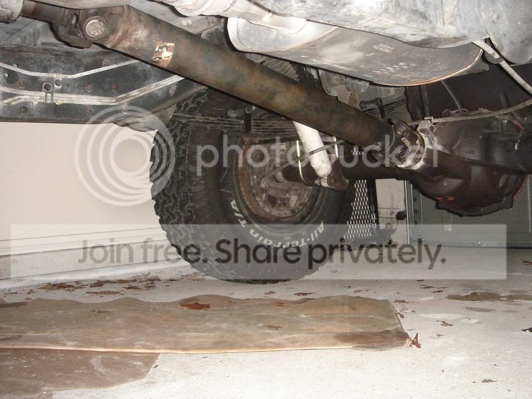

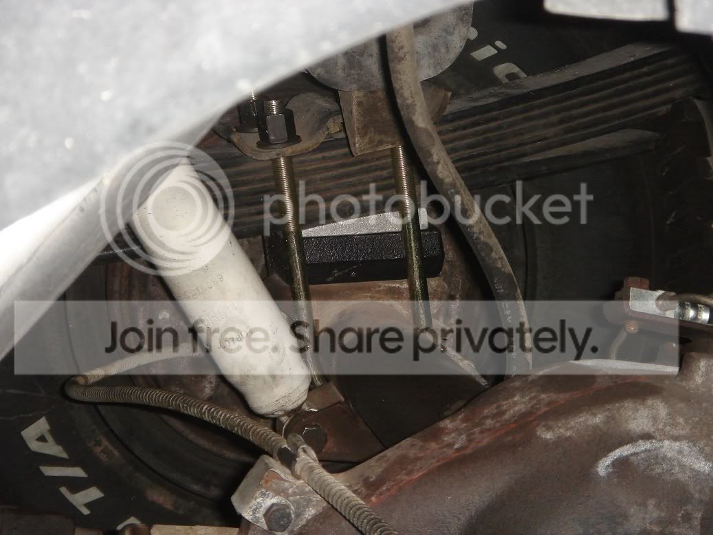

Well I had shorter blocks installed in the rear along with shims to point the diff up towards the transfer case. When I got the truck back there was some pretty significant vibration when accelerating and decelerating around 5-10mph. I installed a homemade transfer case drop made from square tubing and it helped, but I still get a little bit of vibration when taking off from a standstill at stop signs, red lights, etc.
Do you think it's possible they shimmed it to point too far up? I wonder if I should remove the shims and keep the transfer case drop in there... Any advice is appreciated.
Pics: does this look like the rear diff is pointed too far up? Should I try removing the shim and see if that makes it any better?
The rear axle is definately shimmed up too high. The u-joint angle at the t-case needs to match that at the pinion.
Would be fine for a cv style driveshaft but like scott said it needs to come down some, quite alot actually
