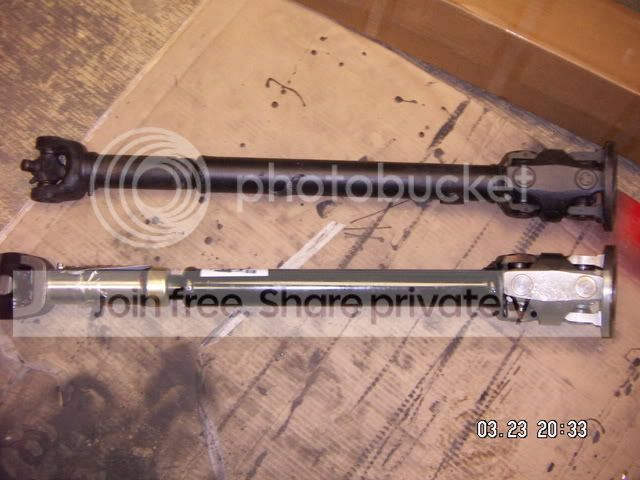

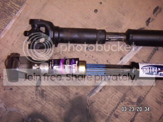

I got the front shaft. Turn-around was really quick - I gave him the measurements on Wednesday and it was on my doorstep on Saturday.

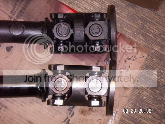

Here are pics next to my spare (stock, coarse spline) front shaft for comparison.
Tubing is 2" .120 wall.
The splines seem almost endless on this thing compared to stock and the diameter is larger as well.
The C/V joint is slightly larger for some reason. I don't know if that means anything or not. The best I can measure, it will go to 23 degrees before anything makes contact.

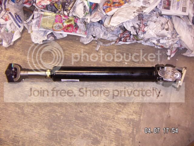

Rear shaft arrived today (Monday) after I gave him the measurements on Thursday.
I requested that the 1350 C/V mate with a 3R flange, so now I run the same (and easy-to-find) 32-spline flange on both outputs of the T-case.

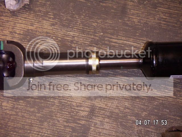

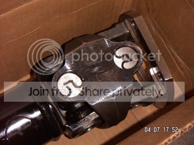

Here's the 1350 C/V joint:
Here's the 7" slip spline with the 1350 yoke:
But the best part is that now my rig runs smooth down the street. I hammered it off the line a few times (I have stock rear springs that wrap easily) and got it up to 60MPH with no vibrations. I've been waiting years for this.:thumb:
