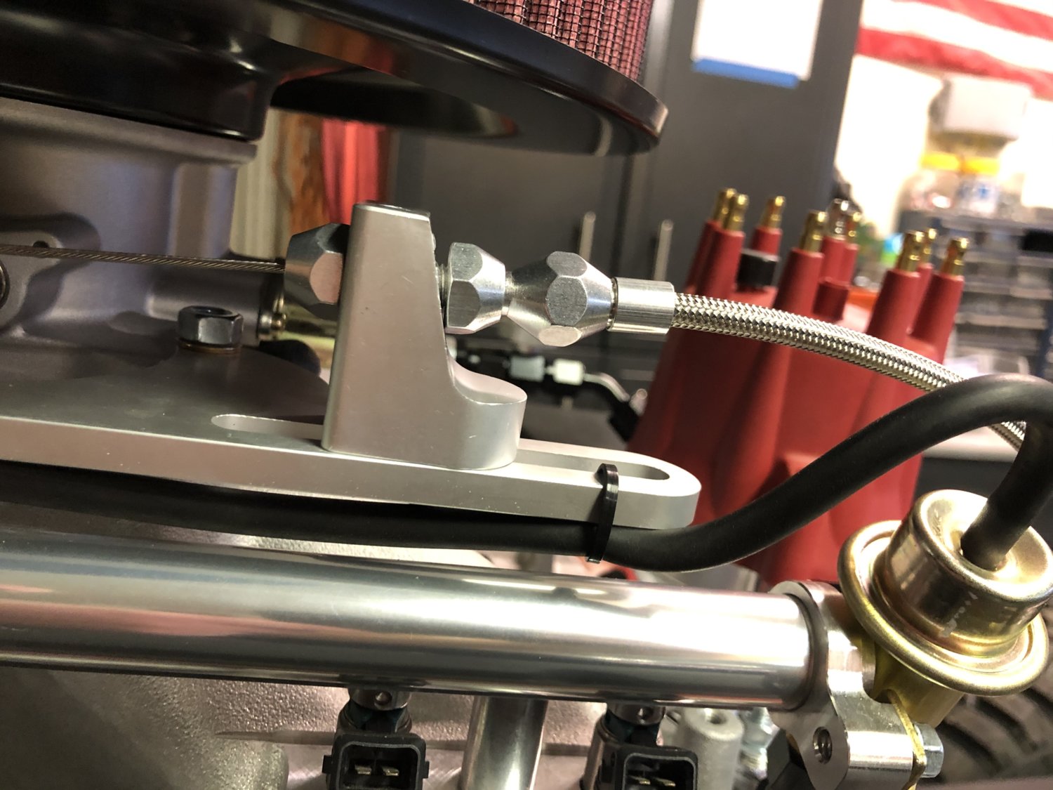

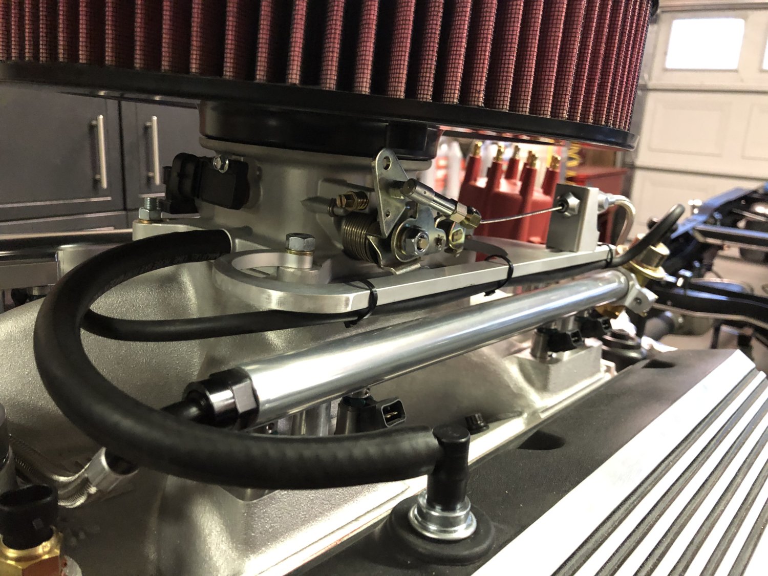

I thought I would circle back on this with my $0.02.
I trimmed the front arm off the bracket for the additional return spring since it's not necessary. I'm going with a lokar throttle cable (worked well on my other K10) therefore the the OE square style bracket was swapped out for the optional round hole bracket. You'll notice the back side of that bracket is cut at an angle so I need to modify it so it's flat. I could also use some longer throttlebody studs with the added thickness of the bracket. For the price, I think it's worth it.
full
Here you can see the angle on the backside of the bracket that I need to modify.
full
Damn! That looks great! Might have to get one myself.
Sad thing is I had one of those that I had modified the same way as @skunked to go on the Sniper but it didn't fit. After a little while I just thru it out because "what would I ever use this on...." :doah:
