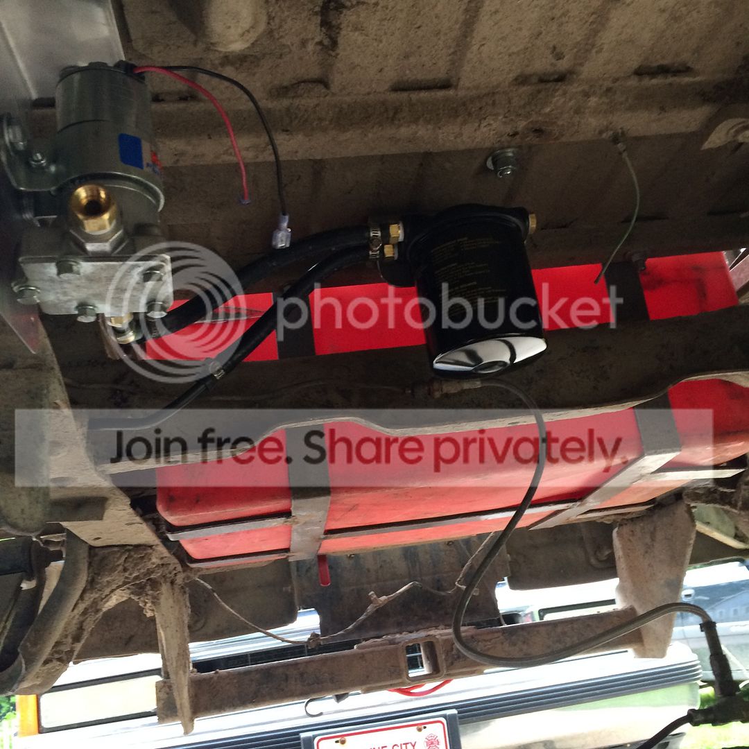

That'll be ok distance, I run a summit pump & haven't had any issues w/ it @ all. Here's my setup, it about the same distance your talking about....

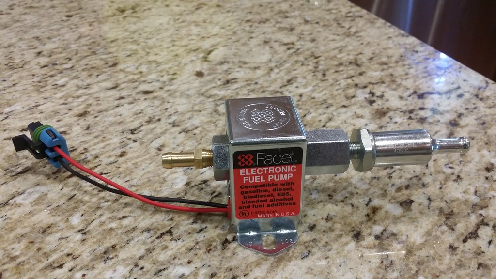

This is actually one of the pumps i'm looking at. This cube also the holley mighty mite and equivalents, which look to be maybe the same as the cube but in a different package? Also facet has a canister type pump(don't know part# offhand) but it can supposedly lift 50" which would take care my mounting "problem."
