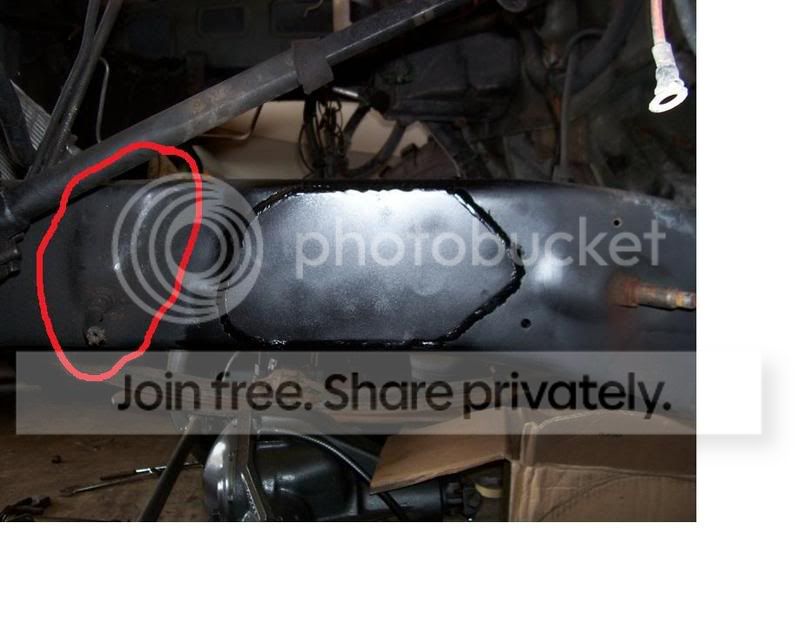

Will thes work on a 2 wheel dive frame to convert to a 4x4.
At this point in time, I'm not so sure that it would.
On the 2wd frame, where the brake lines pass through, there's a bulge in the side of the frame rail that may interfere with the crossmember frame brackets.
That's just one thing I caught with a quick glance at my '86 C10 this morning. There may be other issues as well, but without having a bare frame on hand to confirm, it's hard for me to say one way or another.
Is the bulge from the quad shock option?
No, the bulge is where the brake line pass thru the frame at a slight angle to the rear.
On my C10 the brake lines exit the frame ahead of the axle centerline as opposed to behind the axle centerline on the 4wd trucks.
Is this the area that your talking about where the brake line comes though.
