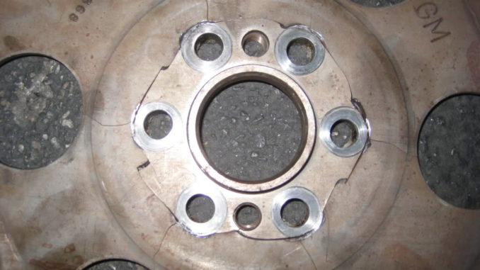

you can the starter doesn't care if torque converter is connected or not. Just be sure to push the torque converter (big blue bowl shaped thing) back into trans, before hitting key with bolts out. Personally I would turn by hand, either at fly wheel with tool designed for it, or front crank bolt with 5/8" deep 1/2" drive socket and long handle ratchet or breaker bar. Once the torque converter is unbolted using the starter may cause a badly cracked flex plate come apart, and damage other parts or people.
Plus, pushing the converter back makes looking at the thing a lot easier. Typically the cracks are in the center of the flexplate - coming from where it bolts to the engine. Even a severe one like this you might not notice with casual inspection.
