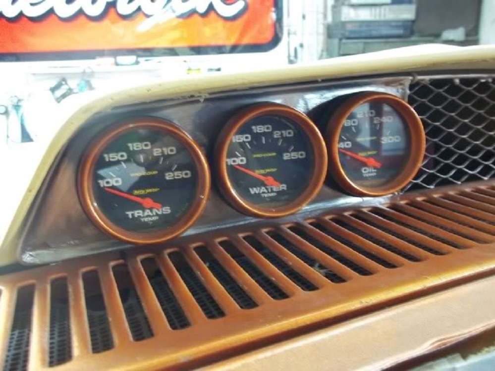

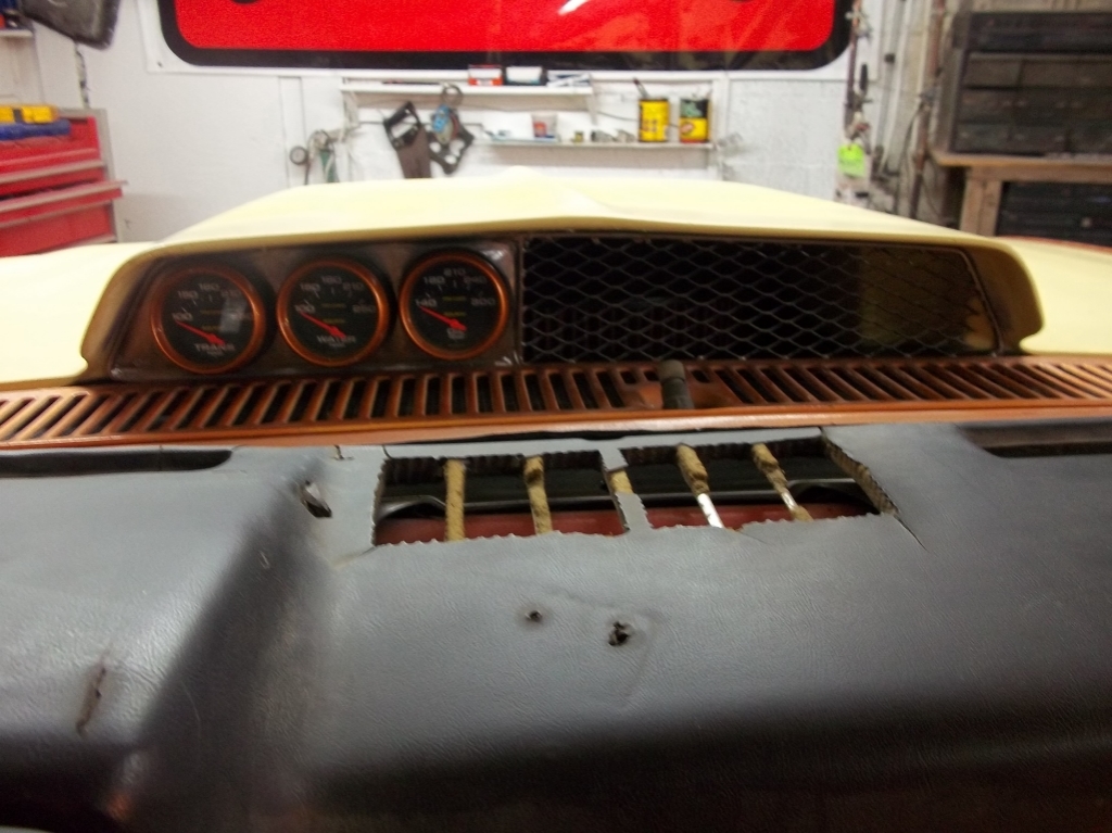

In the hood, GTO style

Fab/glass your own custom a pillar pod that puts the guages where you want them...

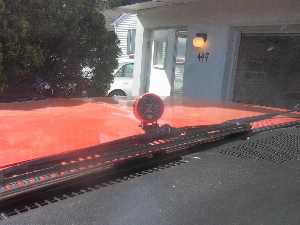

I was thinking about doing that but doesn't the glare/reflection on inside of windshield impair it visually?
