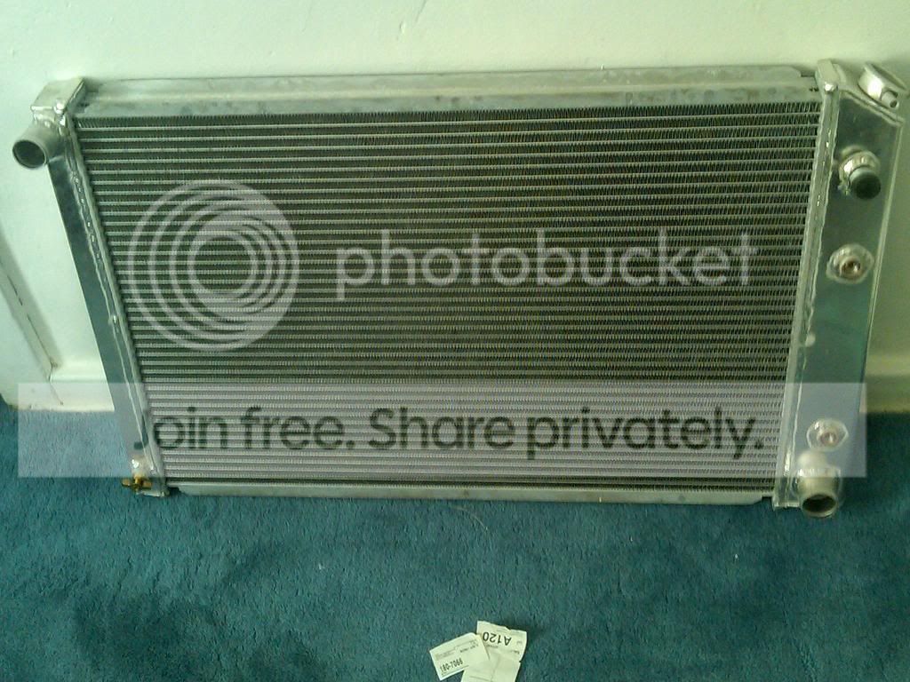

im excited, i just ordered my aluminum radiator and windstar electric fans

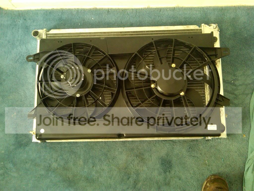

put the water pump and the pulley on tonight, pulled the radiator and fans out of the boxes
here you can see where im going to have to trim the shroud
which aluminum radiator is that? I just installed a Vistapro Brass/brass radiator.
Its the one from genesis auto I posted a link to in your thread when you were looking for a radiator. Cost me $145
Didnt' realize how cheap it was :eek:
AND, was in a massive hurry after they shipped me the wrong one.
Live and learn, i guess. My brass/brass radiator was about double that.....but fit like a glove.

installed the radiator and electric fans, got them wired in sunday (main comes on with ignition and secondary is wired to a switch). my bushings showed up lastnight but i got off work to late to put them in, hoping i can get them in tonight.
so sunday i put it through its paces to see how the new radiator was gonna work. around town it was fine, but the old radiator was fine around town. so i headed up white mountain which is right out of town and a bumpy rocky road thats about a 70-80 degree climb, it started to warm up a little and as soon as i hit the secondary fan i just watched my temps drop back down. next test was the freeway, it would heat up going down the freeway even with the heat on, now its nice and cool even with the A/C running.
You are going to want to put the always one on a thermo switch. I ran up to ID in December never once turned on the fan, truck never got off of the thermostat.
