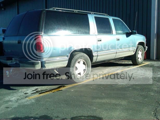

So i call a guy i work with who has been talking about selling his burb, i ended up buying it from him today, he is going to clean it out and drop it off tomorrow. 1997, suburban, 4x4, 1500, 350 engine, $1,000.

oh and here is my new burb

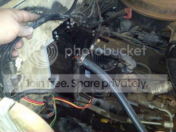

when we recharged the A/C, we vac tested it and it said no leaks, we recharged it and with a month it was empty again, so i ripped the stock heater A/C unit out and put in my summit heater, i am going to turn the A/C compressor into an OBA setup.
which summit heater is this? do you have any more pics of your install? How do you like it?

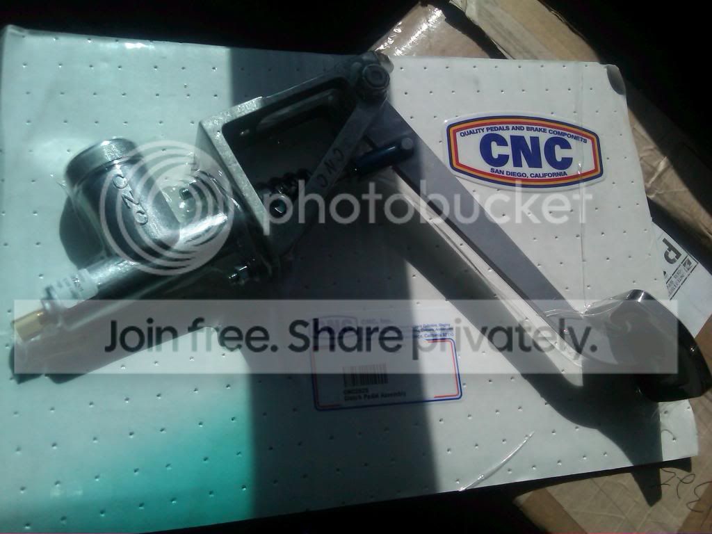

so it wasnt the wire to the temp sensor, it acted up again. traced my grounds and found the one to the fuel pump the PO had cut and just twisted back together. fixed that and drove it back and forth to work for 3 weeks with no issues. then last friday i ripped the 4L80E/241 out and sold it on here to shane, saturday i picked up a manual bellhousing SM465/NP205 which i am converting to hydraulic to put in the burb.
ordered a CNC clutch pedal/master cylinder assembly, the 465 didnt come with a shifter so today i ordered an updated one piece shifter from Novak, and im waiting for money to shift around from paypal so i can order the new flywheel/clutch from rockauto. once i get it put in then i will figure out my mounting for the slave and bracket.
picked this up in the mail today
Curious to see how that works out for you. There is a part of me that says it's going to be a nightmare.
Novak makes a kit with the slave and mounting bracket for about $210 but really its just a simple bracket I can plasma out.
