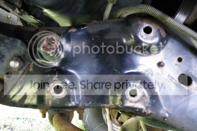

Still working on bolting the steering box onto the frame. There are a couple small cracks on the frame and it looks like one bolt hole has widened a little bit (not sure). I'm not going to weld on a brace yet because I need the truck on the road now. I may order a bolt on brace though.
The top left hole has a small crack and the bolt hole appears a little widened, other than that doesn't look too bad.
Tried to outline the crack in red. the U shape thing was just for the diameter of the hole (ignore it)
