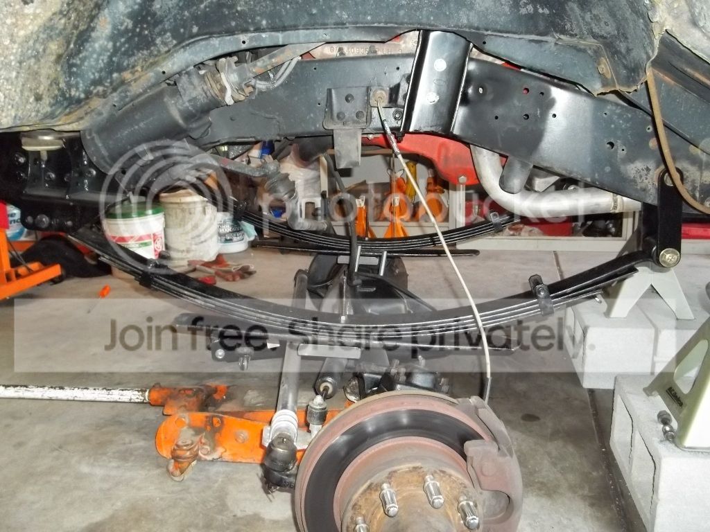

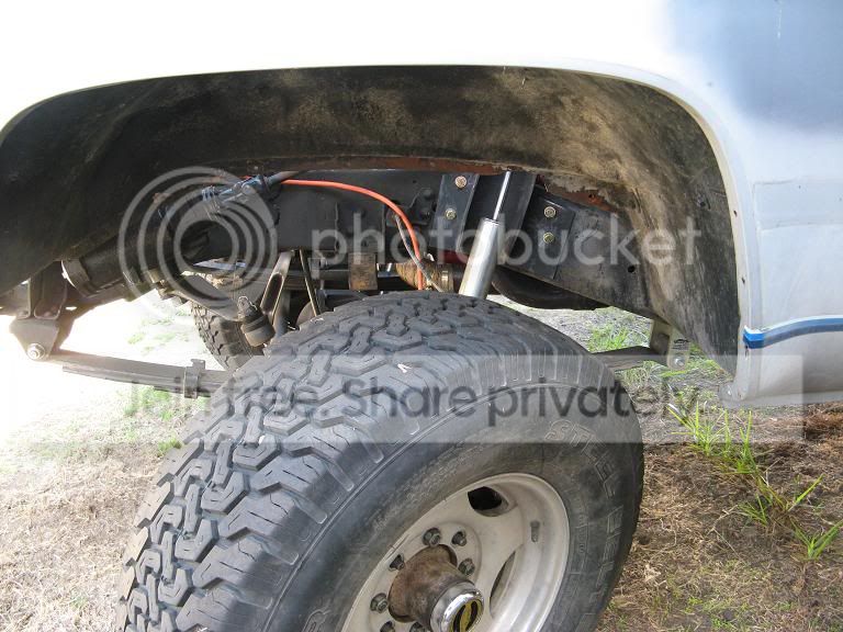

I'm going with the stamped Ford towers on the front of my K5. Looking to get into 14" travel Bilsteins. I'd like to see some examples of how people installed them. I saw the tech article (http://coloradok5.com/ranchoreview.shtml) where he put them leaning way back, but not everyone does that. It may be the easiest to tilt them like that, but maybe it's better to get the shock to travel more vertically and sort of go in place of the taller shock mount I have from the factory quad setup? Steering shaft clearance may be an issue with that though. I've heard of guys notching the tower. I really like this setup though and may try to copy it (http://coloradok5.com/forums/showpost.php?p=2828160&postcount=36). It should just barely be within my fabrication capabilities.
The more vertical the shock is the better it will work. I really like the setup in your pics. Seems to provide a good compromise of vertical mounting and keeping things in stock position without too much modification.

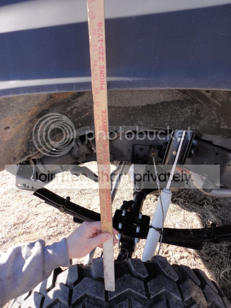

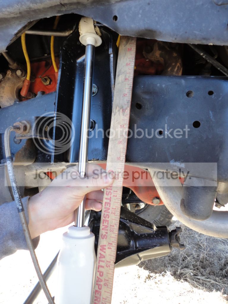

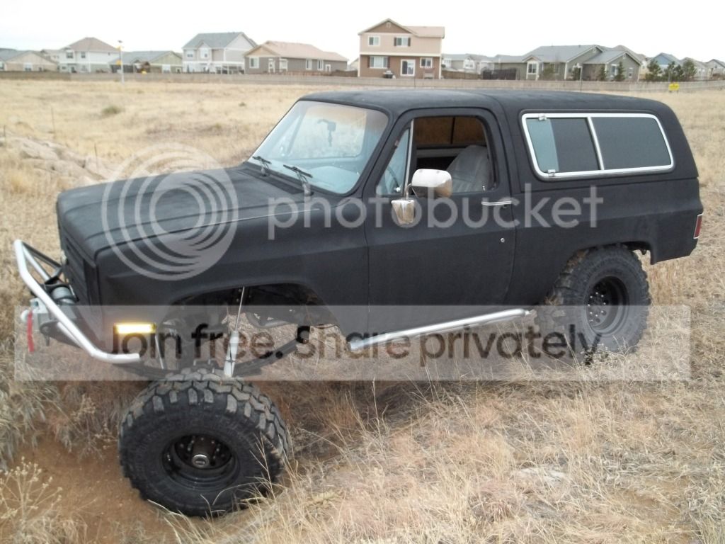

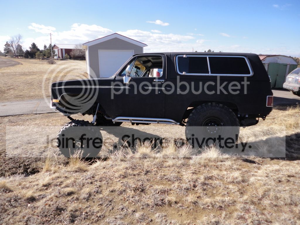

I set mine up very similar to the pics above, but mine doesn't go up as high. Mine stops just below the steering shaft. And I still used 14" travel shocks and it's pertty much perfect
trimmed up
pics right when i put the shocks on the front....not that great of a pic showing it
Flexing
showing almost all of the 14" travel being used
:D

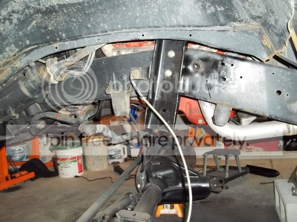

Sorry, should have been more clear. I mounted my ford towers as close in relation to the factory mounts on the frame as I could (just higher up) so that I could reuse the factory axle side mounts and keep similar shock geometry as stock.
If you look at Kay86K5's pics the towers are forward of the frame dimple where the stock mount was. I bolted my towers on to the other side of that dimple but as close to it as I could get. However, after looking at Kay86K5's pics the factory axle mounts may still work with the towers forward of the dimple giving a more vertical shock and keeping the minimal amount of fabwork.
I planned to go with the way BGKYK5 has his setup in the pictures you have in the first post, but after hours of messing around with the drivers side, trying to work around the steering shaft, I'm going to just get some knuckle shock tabs and mount mine like ezoliver has his setup.
