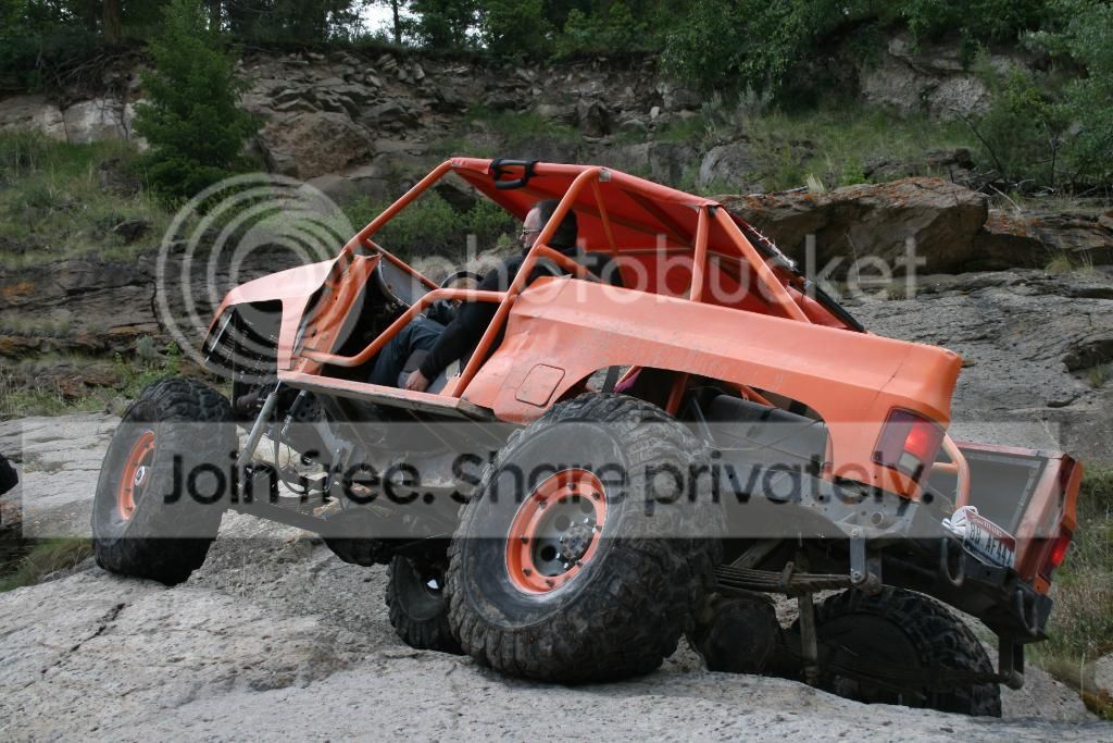

I will level with everyone here. I did not use a calculator program to build my suspension. I built what fit. Used comon sense from what I had seen done before. Set the back up for no axle rotation. Upper link as high as possible. Then bought the biggest shocks available at the time.
My point exactly..... I have seen your truck up close and watched it perform...
If this was "just getting lucky".... you hit the lotto of suspension systems !! :waytogo:

Wade did a good job with his blazer but I bet even he knows that it can be better. Now for what he does with his blazer and what it can do because of Mass is it worth tweaking it, probably not.
