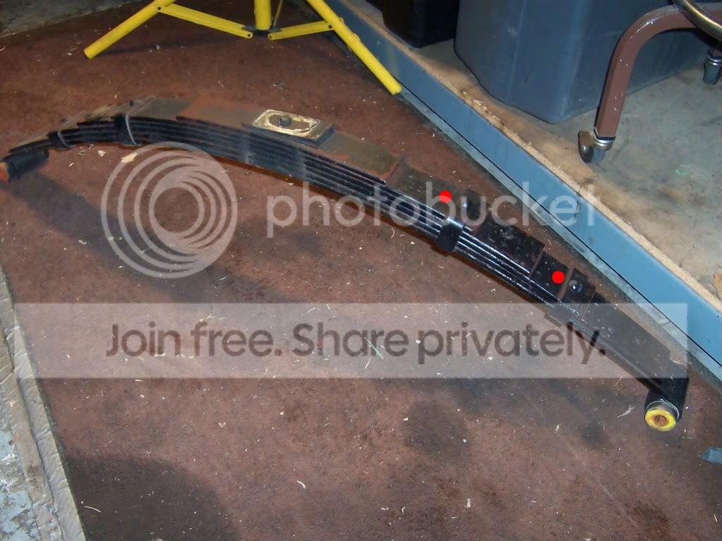

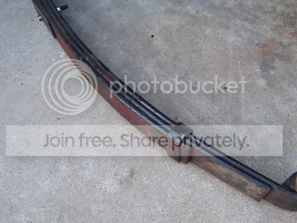

Ok so here's the deal. I have big plans for the suspension on the front of my k10 but for the time being I figured I could pull some leaves out of my front spring packs to soften it up a bit.
When I pulled them out tonight I realized my center pin on the passenger side is all bent up...
So here's my questions...
Do you think the bent pin was due to loose u-bolts or is it because I used grade 8 bolts instead of "spring pins"?
Secondly any suggestions on what leaves to pull out of the pack? I was thinking of pulling the ones I put red dots on.

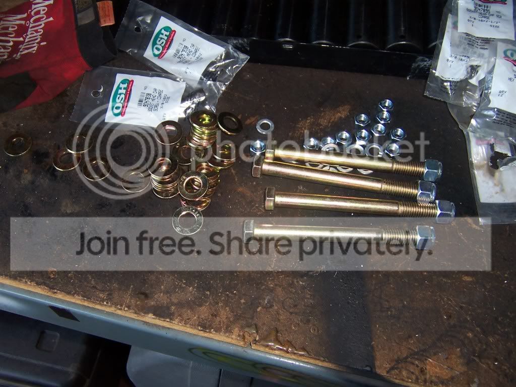

It's also time for some new hardware.... stinkin' salt air/water rusting all my stuff. :)

X2. I would split the leafs in half. Keep the long 3 w/ a clamp to keep them from fanning and ditch the last short 3. My .2

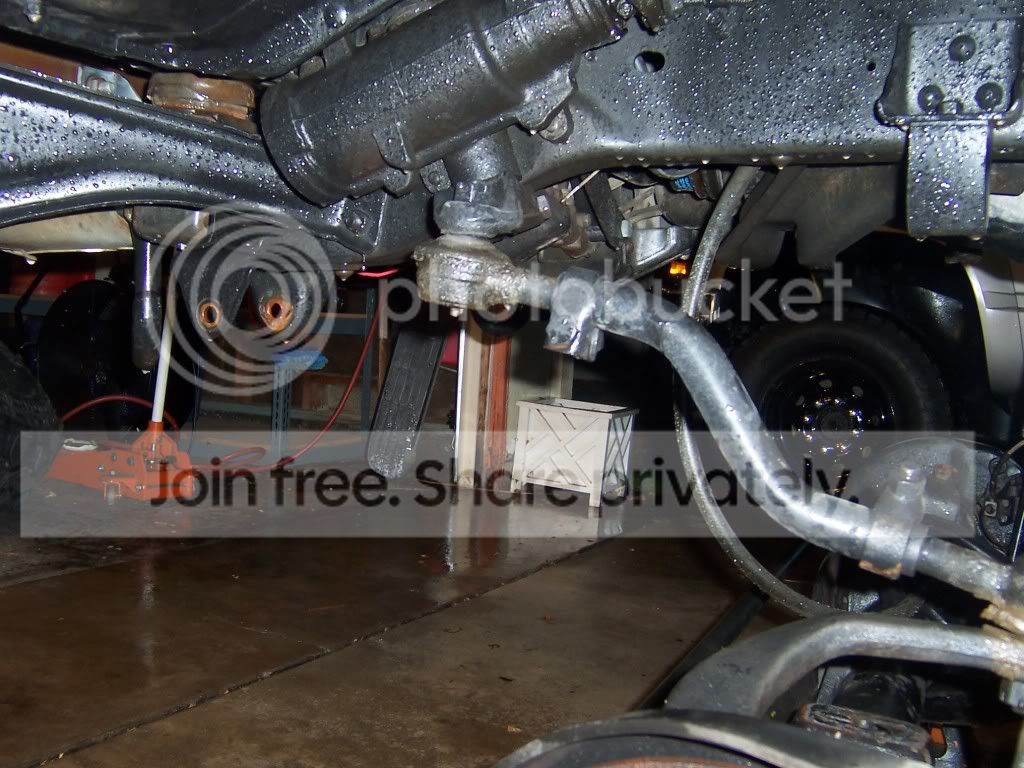

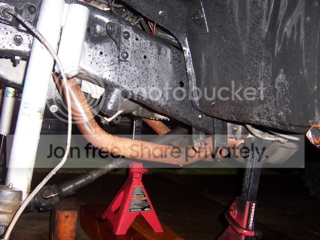

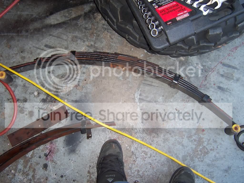

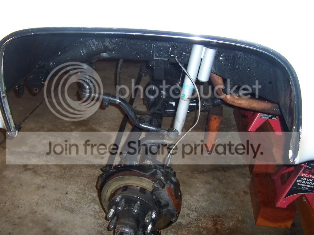

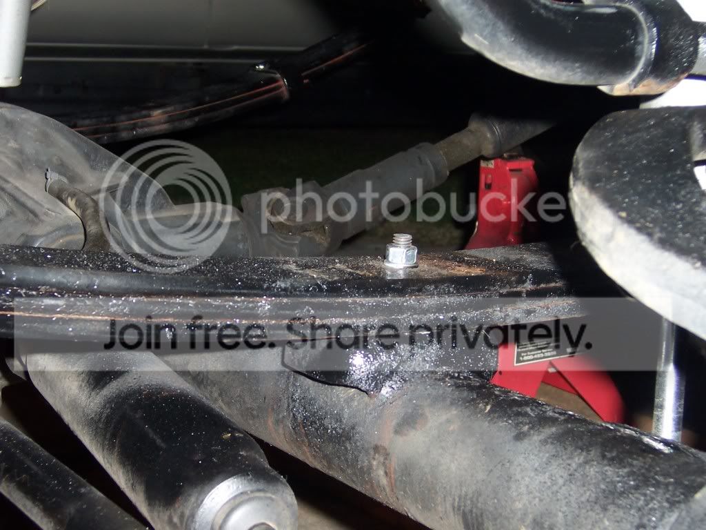

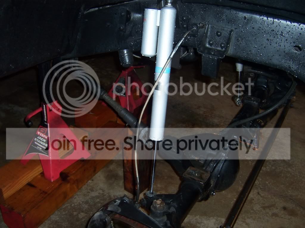

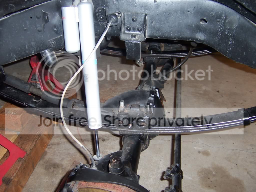

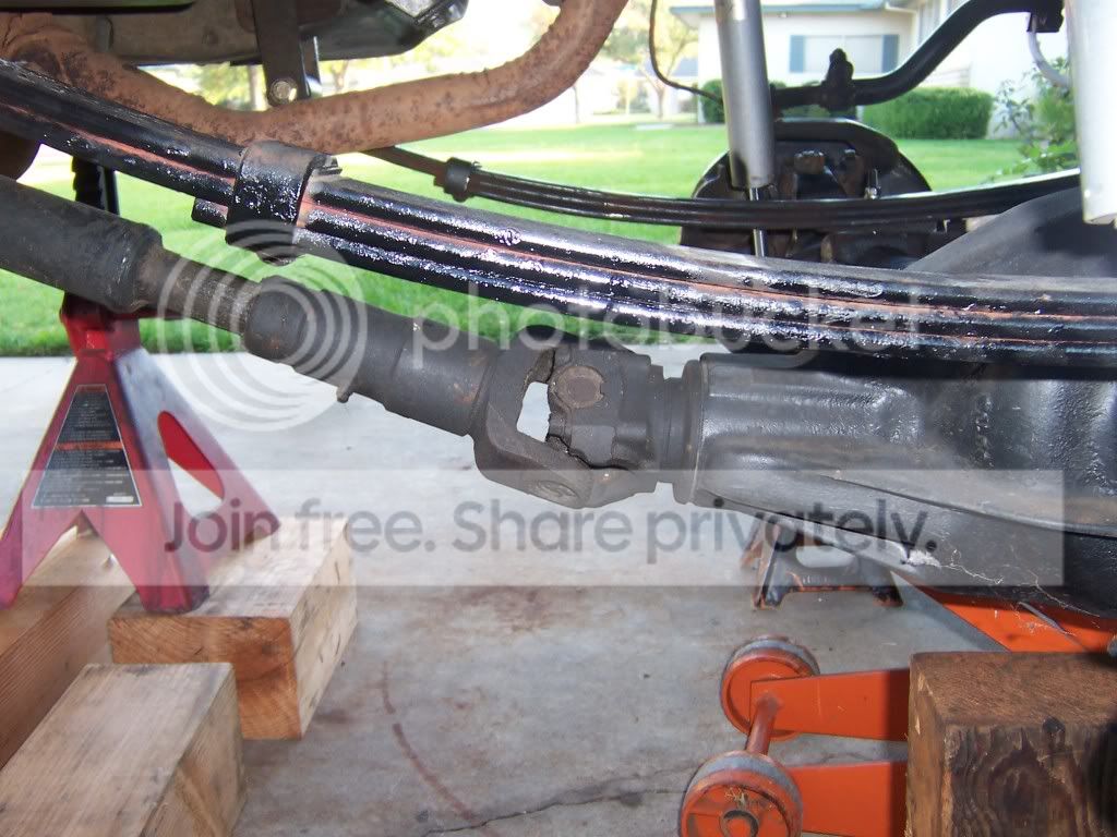

I got the packs pulled apart and put back together with the longest 3 leaves and I think it'll be a great improvement over running all 6.

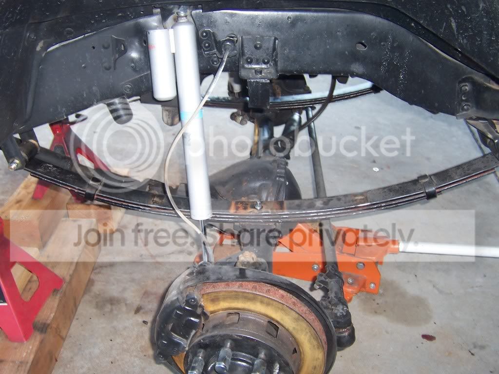

The shim on the passenger side was busted and when I pulled the pack apart it cracked all the way through so I thought I was sunk.... but then I started looking at it and I don't think I even need them anymore. In the pics all the weight of the truck is on the springs and my front d-shaft angle looks good to me. I also like the idea of not having a shim in there, just one less thing to break. :)
I solved one issue and of course another one came up. The threads on the u-bolts didn't go down far enough since the pack is thinner than before so it looks like I'm stuck until Monday when I can get more u-bolts bent up.

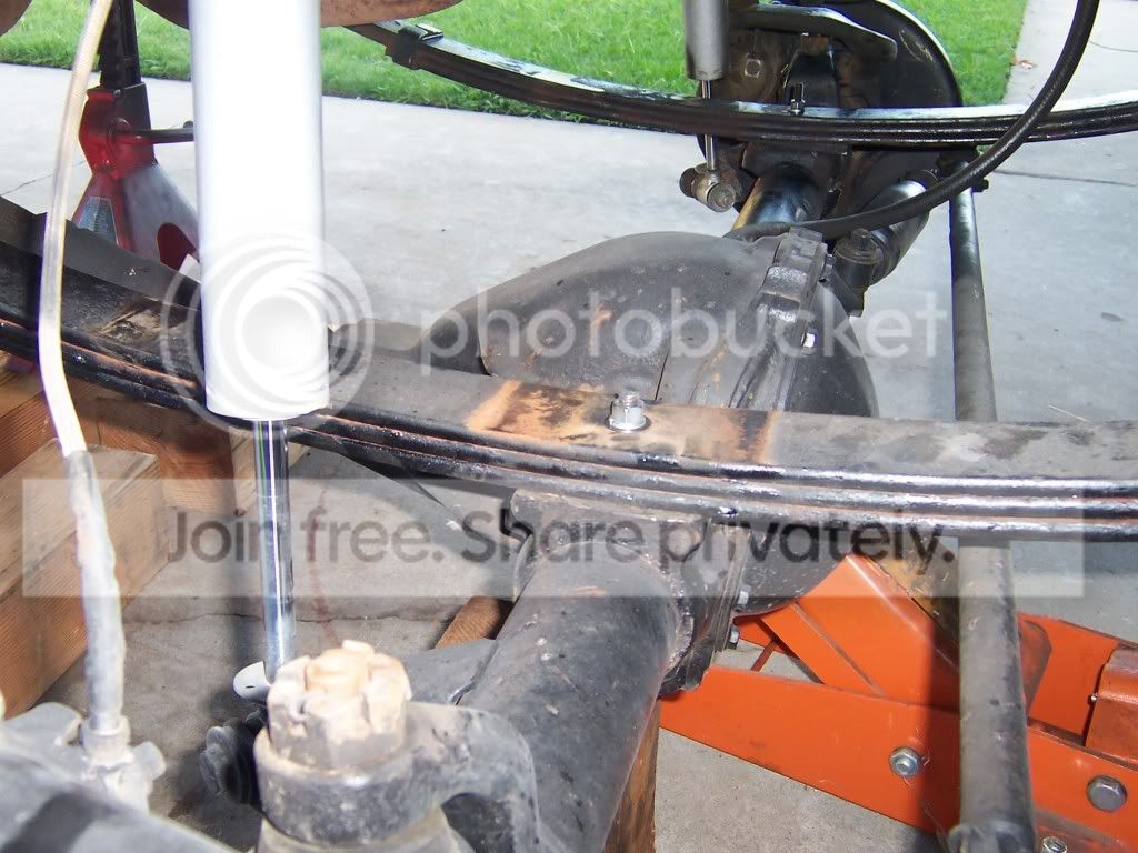

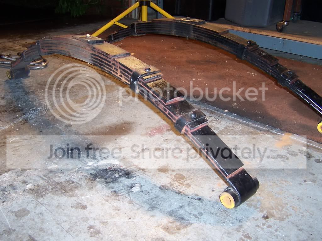

The newly assembled pack (this was the driver's side that I assembled with the shim but later went back and pulled it out)...

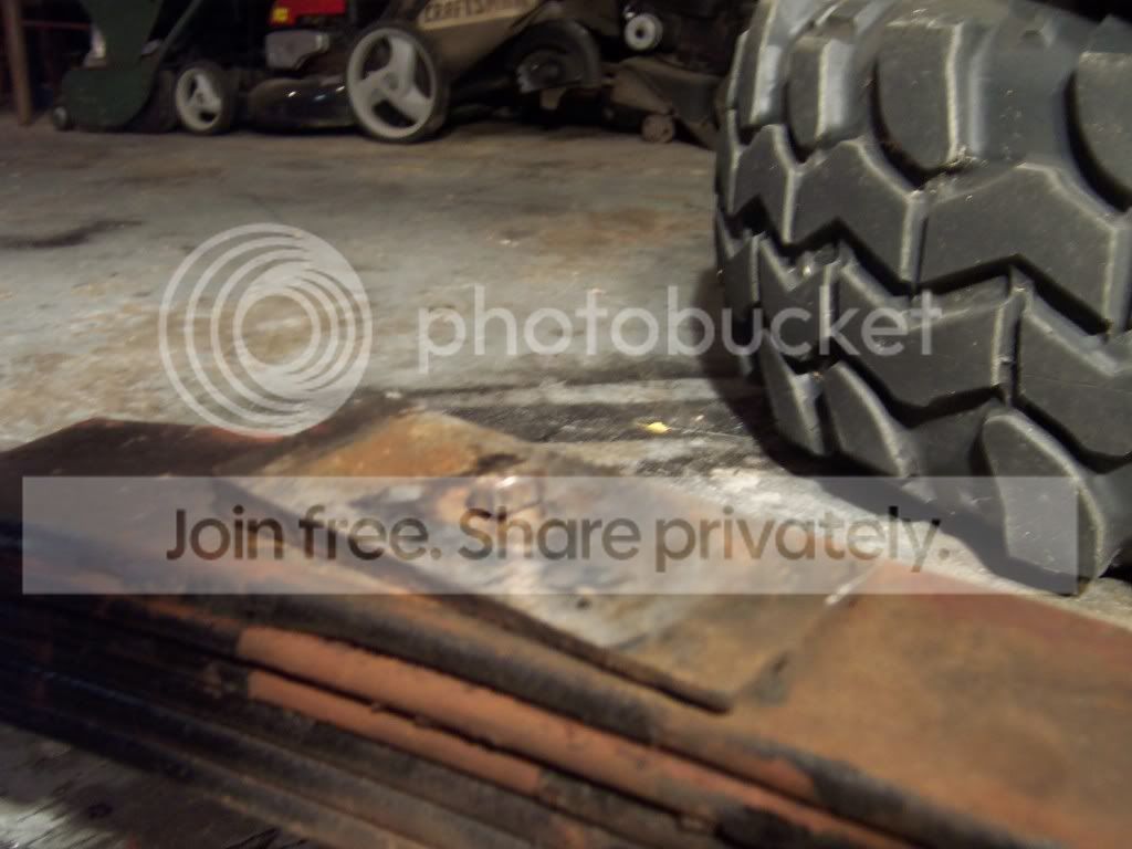

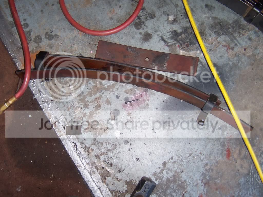

Here's what I pulled out...

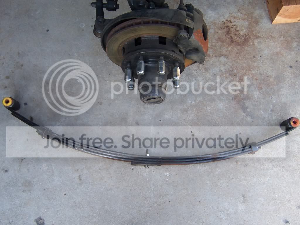

Here's what they looked like before...

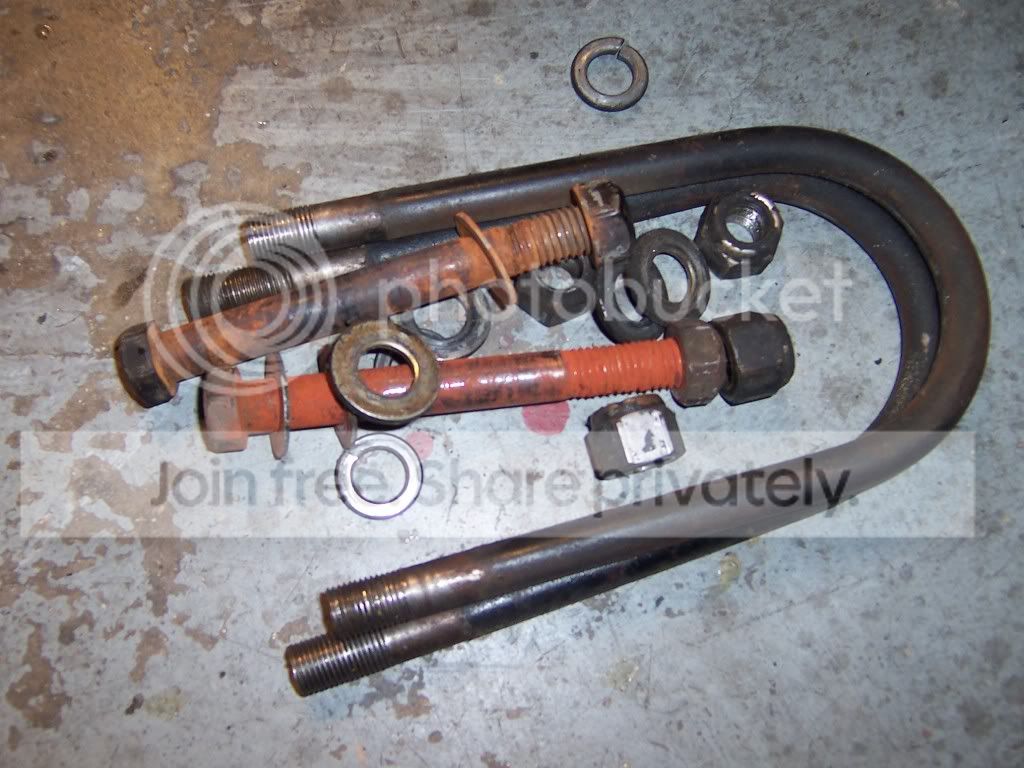

Fresh new hardware! :)

No pics of the full weight of the truck on them??

The weight of the truck is on them in the pics I posted tonight. The red jack stands under the frame aren't touching.

OOhh. I see the different shackle angles now.I think your gonna love the ride. Get ready to feel like you on a boat in the ocean.Maybe.
