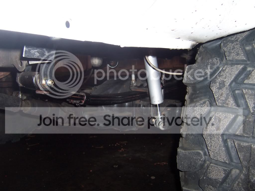

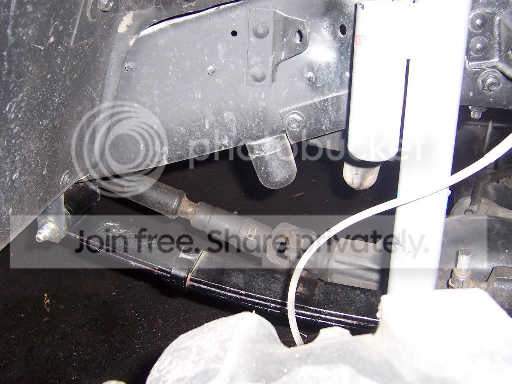

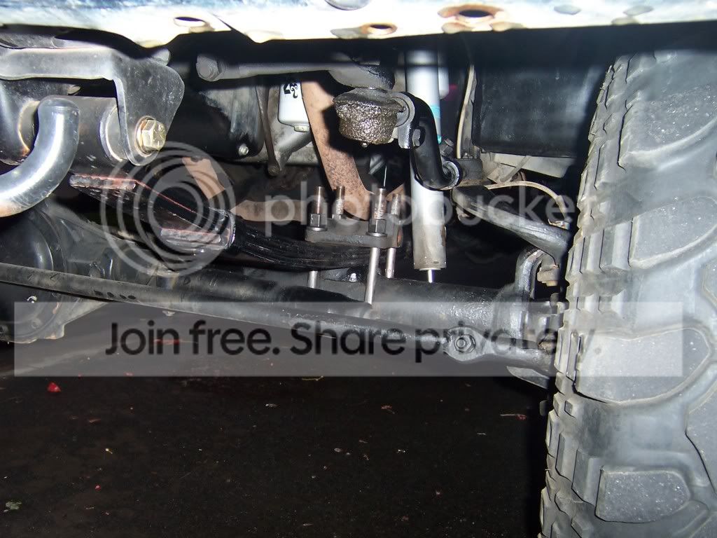

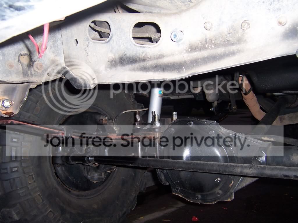

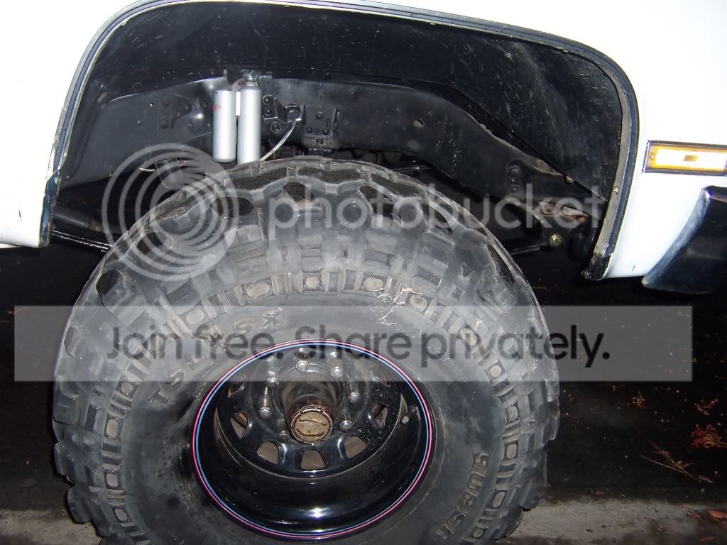

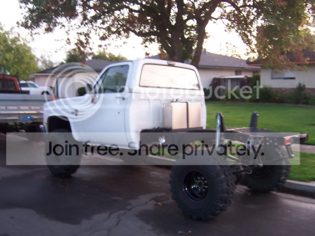

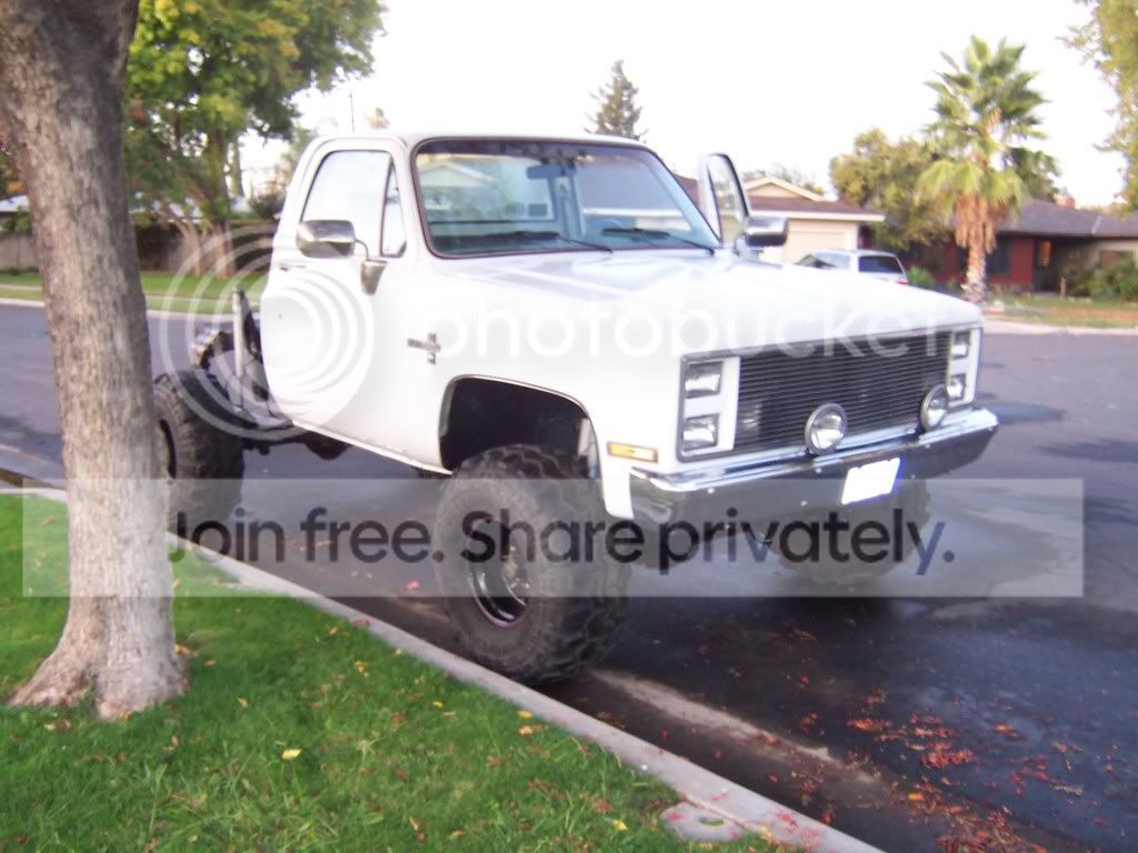

Okey dokey here's where I'm at as far as this little project goes...

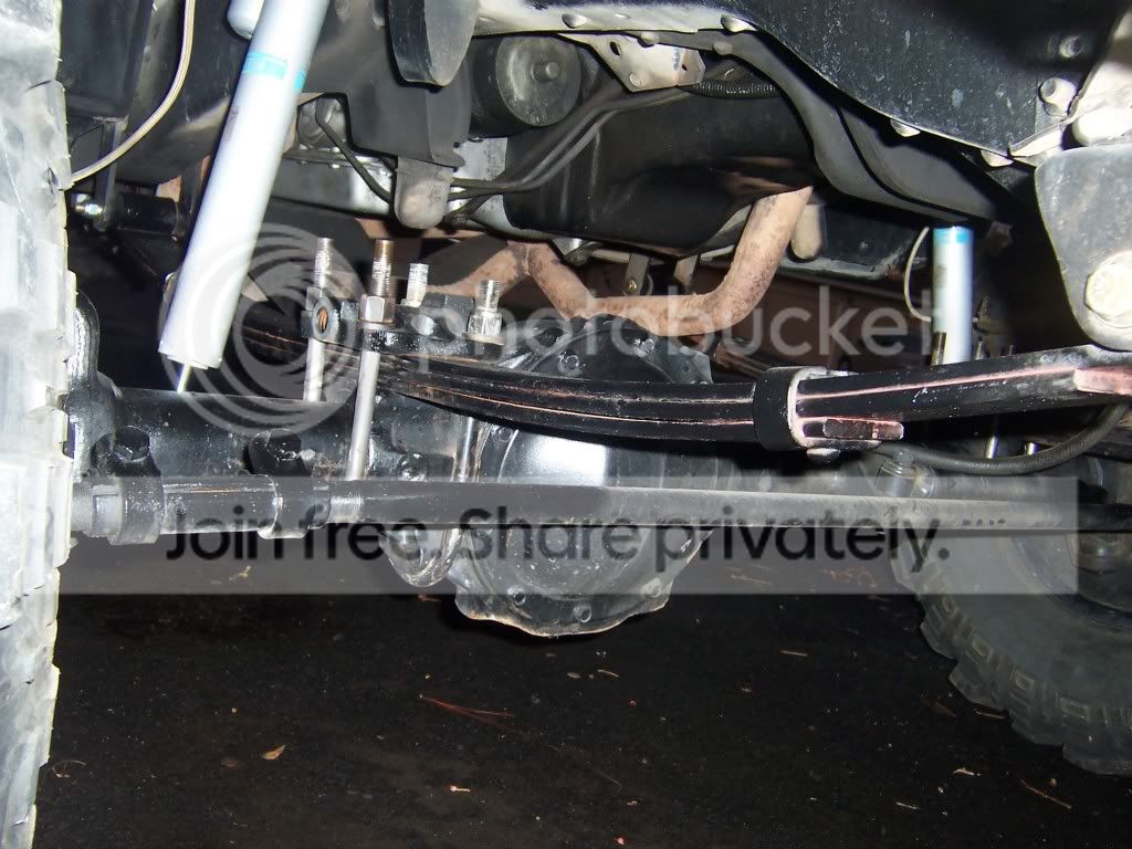

I got it all back together today since I was able to get some fresh u-bolts this morning before work and I have to say I'm happy with how it turned out BUT I will definitely have to get some stuff taken care of before our next trip.

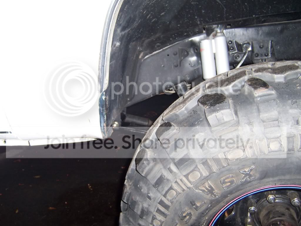

First and foremost I think I'll order another set of Ford towers to put up front since as it sits now there is only about 2" of shaft showing (they're 14" travel shocks) so I'll basically leave everything the same except bolt the Ford towers in place to get a little more up travel out of them.
Next is the front d-shaft... I think I'll pull the d-shaft spacer (which probably wouldn't be a bad thing anyways... my front output on the TC is leaking like crazy and I'm thinking the extra leverage of the spacer might have something to do with it). As it sits now I think I'd bottom it out on a hard landing.
Finally is the most obvious issue... the fenders. I hate to say it but I think they'll be getting a trim. The front will probably be ok but the back of the fender is definitely going to hit so I'll have to deal with that.
I could lift it back up a bit but I think the extra work to keep it low is going to be a good thing.... even in the dunes sometimes my high COG was a problem so I can only imagine how much it'll help on the rocks to keep it low.
Ok here's some pics...

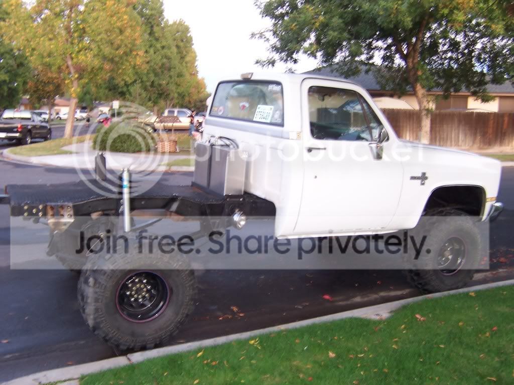

Oh, forgot to mention this but the last picture reminded me.... it does sit a little high in the back but I had my dad stand on it between the towers on the rear and it just about sat level so we're thinking after I mount up my fullsize spare, a toolbox full of stuff and the weight of tubing for the cage it'll be perfect. For now... well I guess I'll just run a little high in the rear. :)

becarefull you don't bottom your shocks out, you don't have much up travel left, and with those softened springs it won't take much.
Yeah that's why I said I was going to get some Ford towers and move them up... I don't daily drive the k10 so it'll just sit until I get the shocks moved.

for the leafs i would pull first and third starting from bottom. this is was i did on my 6" and i added an ooober long one from my thinnned out rear pack....its rides soft smooth and flexs great....
