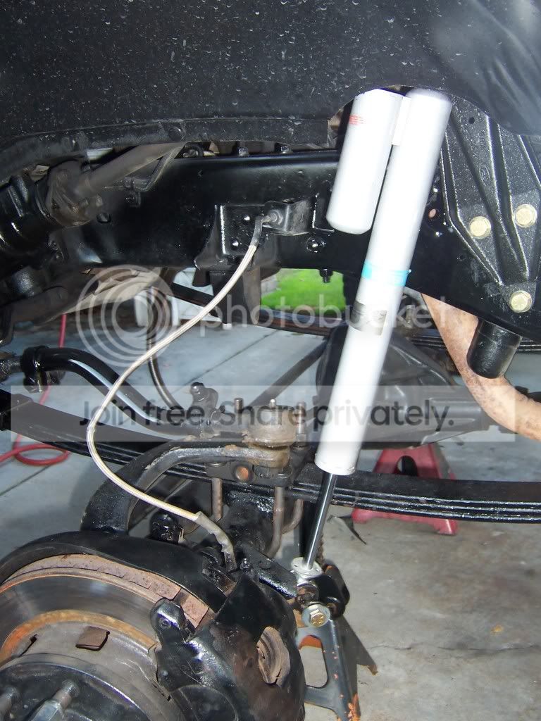

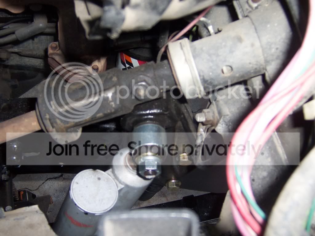

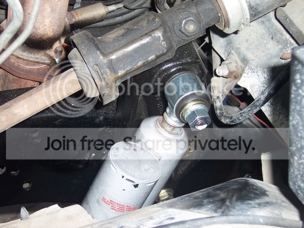

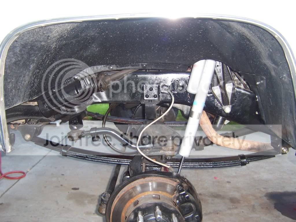

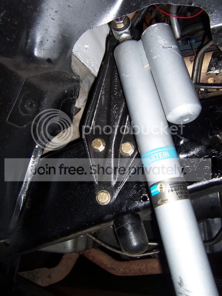

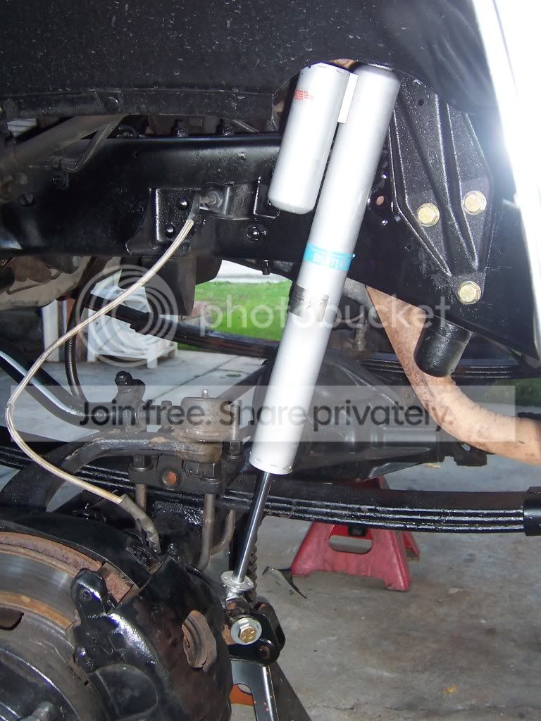

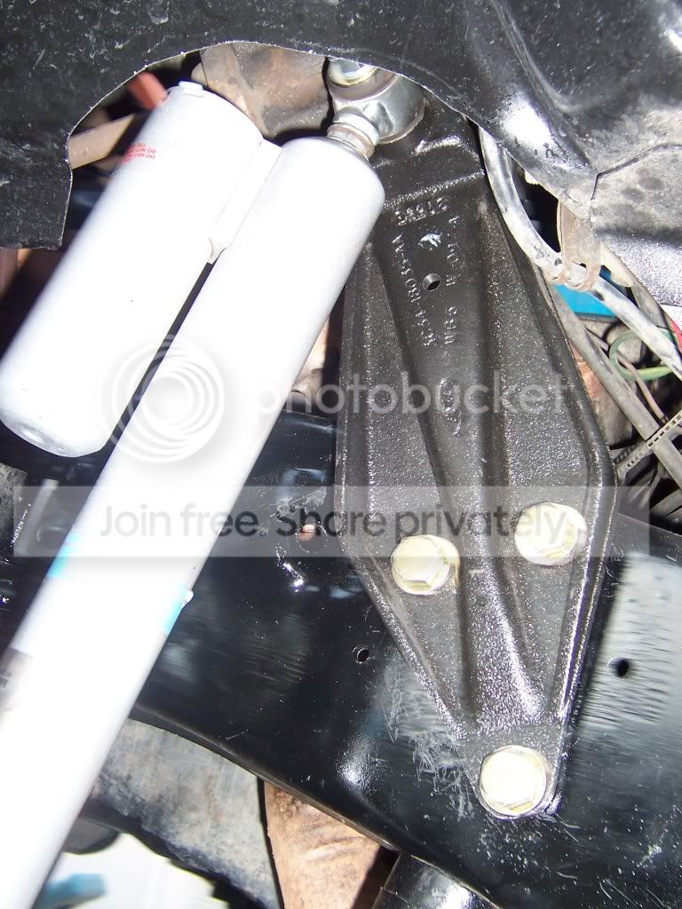

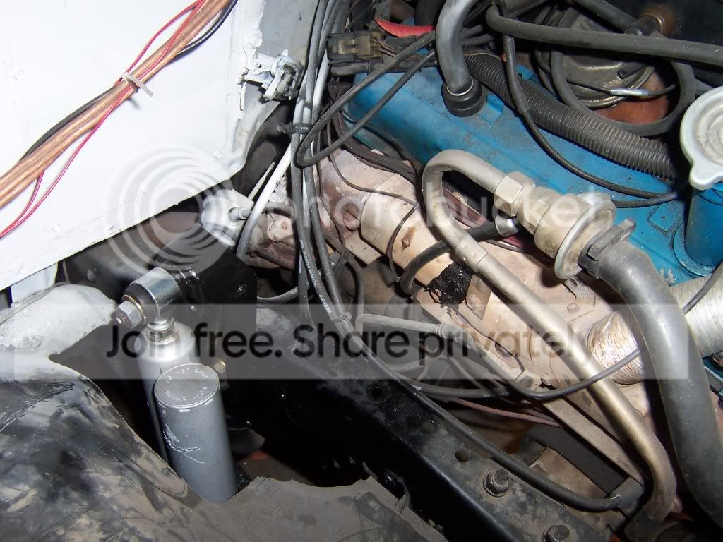

I just wrapped up the driver's side. This is the absolute longest setup I could squeeze out of it while maintaining a good bite on the frame and not running into the steering shaft or firewall but I think it'll be fine.
It gives me 6" of up-travel and 8" of droop. I'll make a little spacer for the bump stop so it hits a little before the shocks bottom out but honestly I think if I get 6" of up-travel out of them I'll be hitting the tires and have no steering so it's the least of my worries.
Oh and yeah, it does clear the draglink. :)

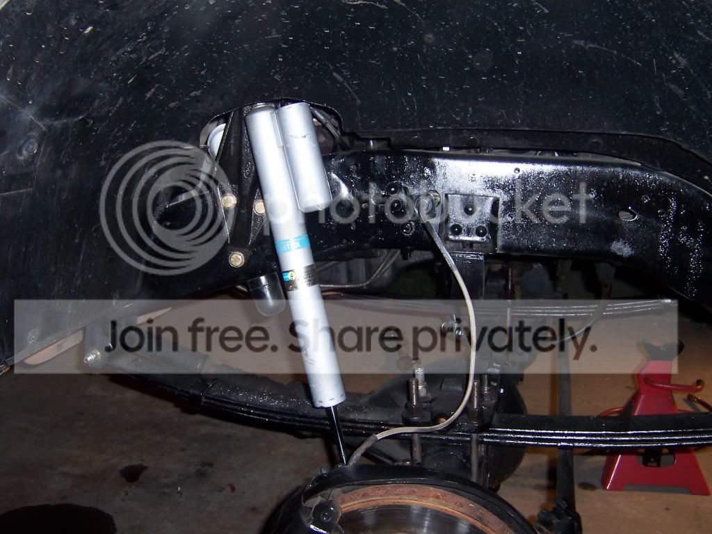

I got a little distracted tonight but managed to get the passenger side finished up too and took it for a test ride around the block and it rides like a caddy compared to before. Getting the shocks on made a bigger difference than I thought they would.

Looks good. I like the angle on the towers and where you told me you were mounting them. Very Clean. Rides nice HUH??
