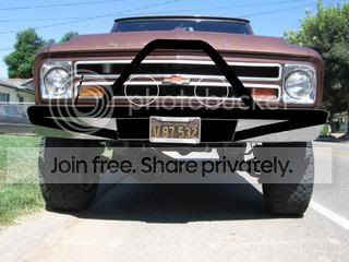

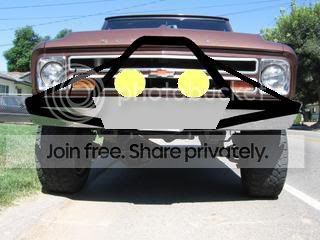

hey all, i was really bored and i drew up this bumper on paint. its probably what i would try to build if i were to build one. i would also move my axle forward and add 37"tires (now i'm dreaming), any ways i'm sure alot of new builders on CK5, and I, would like to see some custom tube bumpers so lets see em! heres my junk:
what do you think? i would love to see some more bumpers/ideas...
if it makes any dif, its a long bed :truck: :weld: :hack: :grind:
