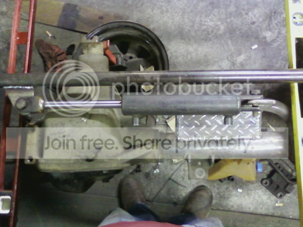

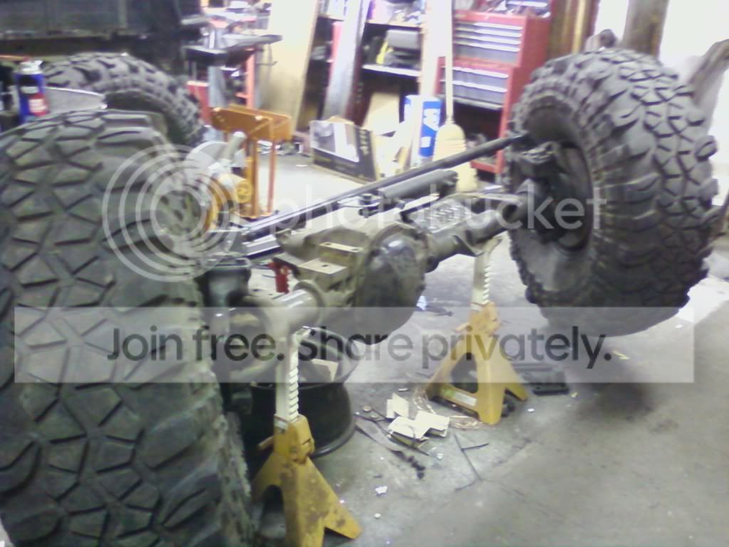

I run a Howe kit http://www.howeperformance.com/rockcrawling.html with a P-pump, Vanco hydroboost and single ended ram. It is down low because of my suspension. I had a double ended ram kit and sold it because this one fit my truck better. There is no skidplate yet, it is on the to do list. It works great and I have no regrets!

This truck has also had 47" LTBs, 48" Michelins and 54" Boggers and the steering is amazing.
I've drove this truck and it steers great...
I don't even notice the difference from lock to lock on mine being a single ended ram...
And for what it's worth, it does steer without the engine running...

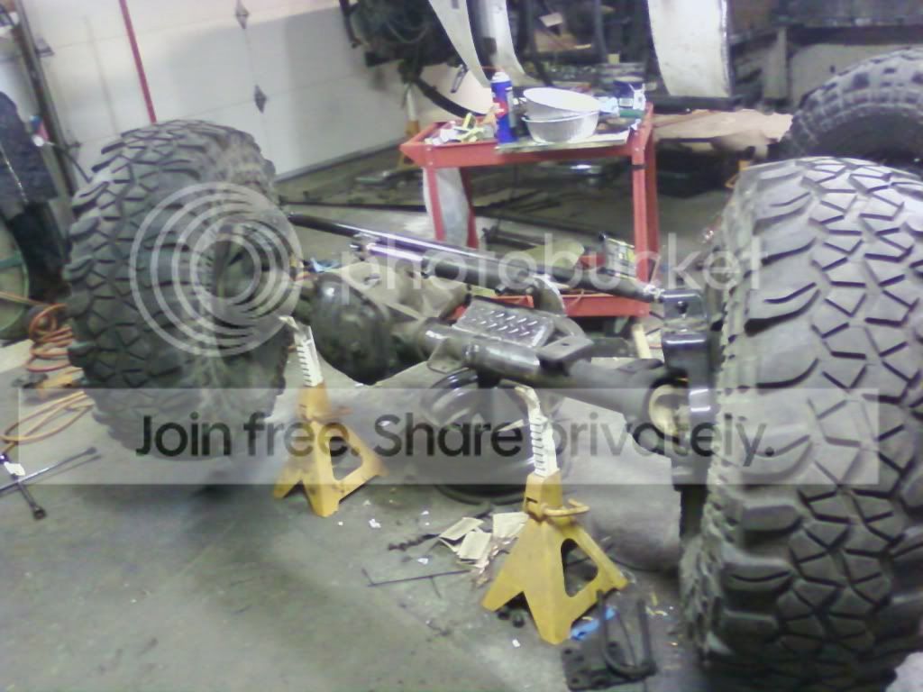

Here's how mine is set up...
Yep, steering control valves (orbital valves) still have steering even if the pump isn't running. Many people don't know that.
Yeah, when I was researching for my set up that was a big misconception...
I've drove a few rigs with full hydro and some with just assist... The difference is huge... Full hydro is the only thing I'll run on a trail rig...

Wow guys thanks for all the help! I've got some more research to do but I really like the pictures I got, gives me lots of ideas!
I just got these arms and knuckles for my full hydro conversion
