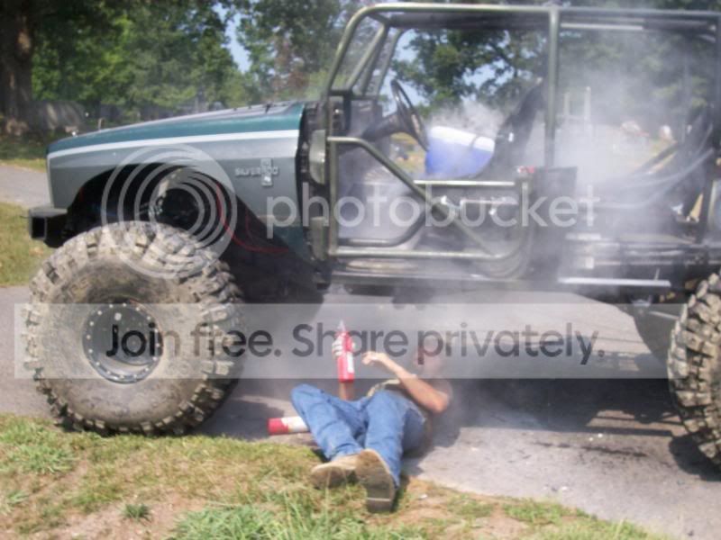

example-formud just put full hydro on his rig about 2 months ago..well last month we all went to take it for a shke down run.we got about 3 miles away from camp a and he blew a hose and the truck went up in flames,we got it out but not before it burnt up ALOT of wiring...also ive been told full hydro has enough pressure behind it to cut your finger off.idk how true that is but i did have a buddy get his cut off with a wrecker and hydralics...

oh here is a pic of what happened
