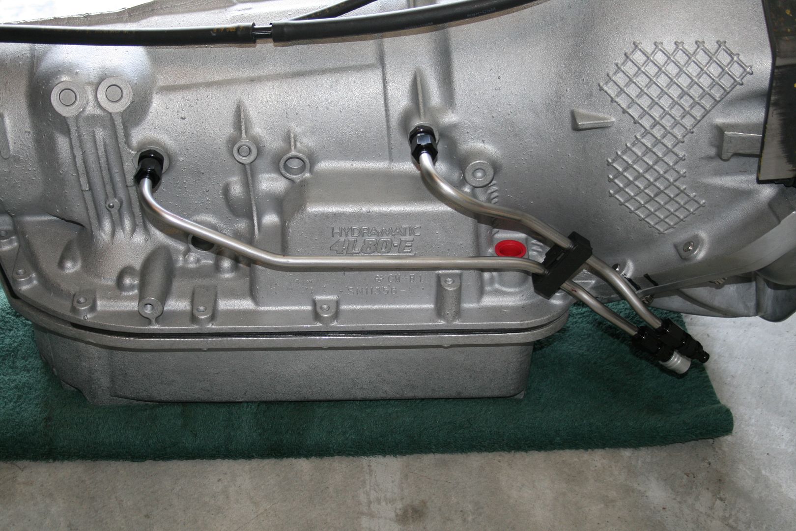

Here is a picture of the new cases, the rear line is the return, which means the top one is the outlet, which means the bottom one is the return on the older cases.
Then how does a respected leading in transmission repair/builds have this wrong?
I'm not saying that you are wrong. I'm just confused how TCI would be wrong.
I know the rear line is the return in the new cases, it feeds back to the planetaries. However, I did make the assumption that they did not swap the supply line in the new cases. I don't know why they would change the fluid passages in the case while leaving the old lower cooler boss there when it isn't used anymore, but I suppose it is possible. Let me try to do a little more digging in case my assumption was wrong.
