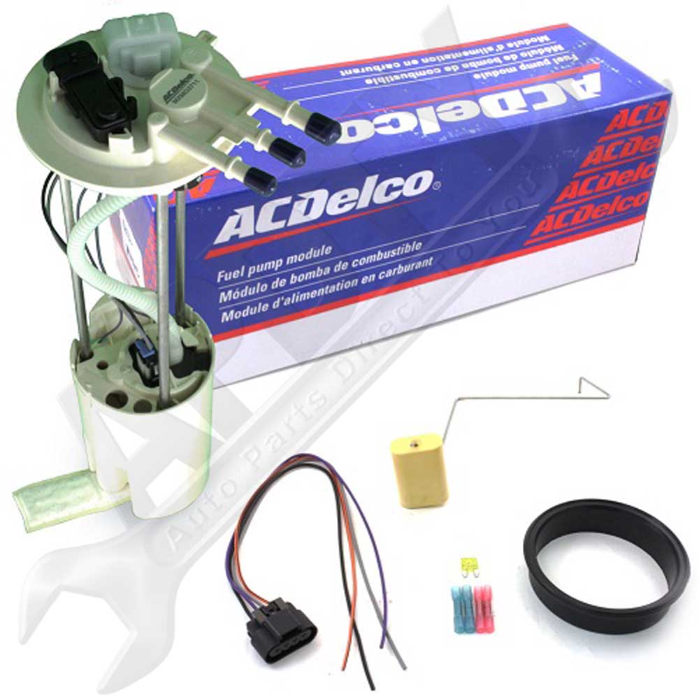

Basically, what we want/need is one of these, designed to replace our stock sending units:
Keep everything steel, brace the sump/pickup/pump area so it doesn't break off from fuel sloshing, and you'd not need a new tank. Even at ~$150-200 it would be worth it. AFAIK that design "slides" on the three steel rods, so useful on various tank depths.
Sorry for going off-topic a bit, just wish someone with the resources would build it. It would work well for you.
