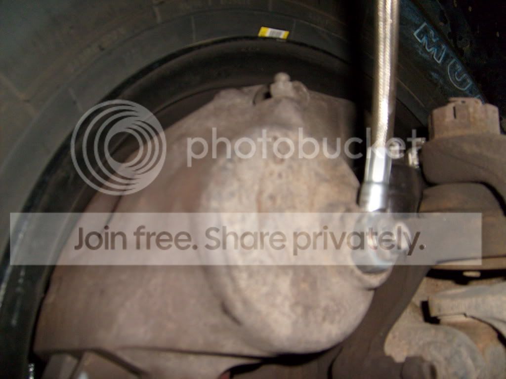

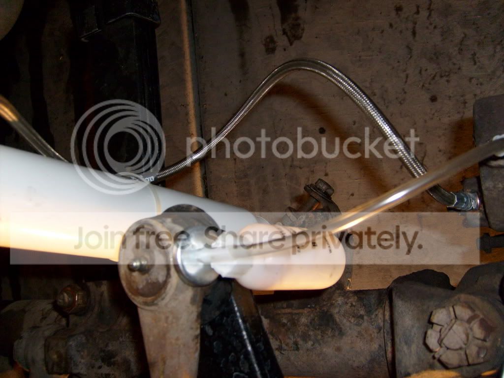

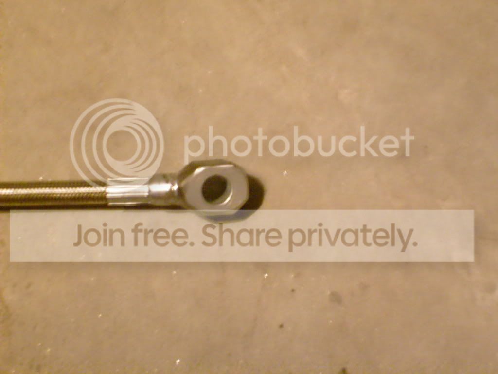

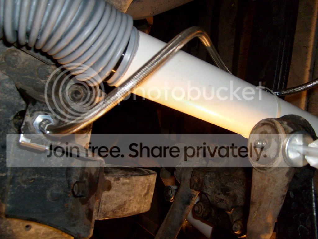

Got the front brake lines ground to fit and installed tonight. (what a PIA grinding, if you need the rounded kind instead of the rectangular be sure to tell Shawn at Black Widow when you order) I'll get some pics up tomorrow. I don't think I'll ever run out of line. :D

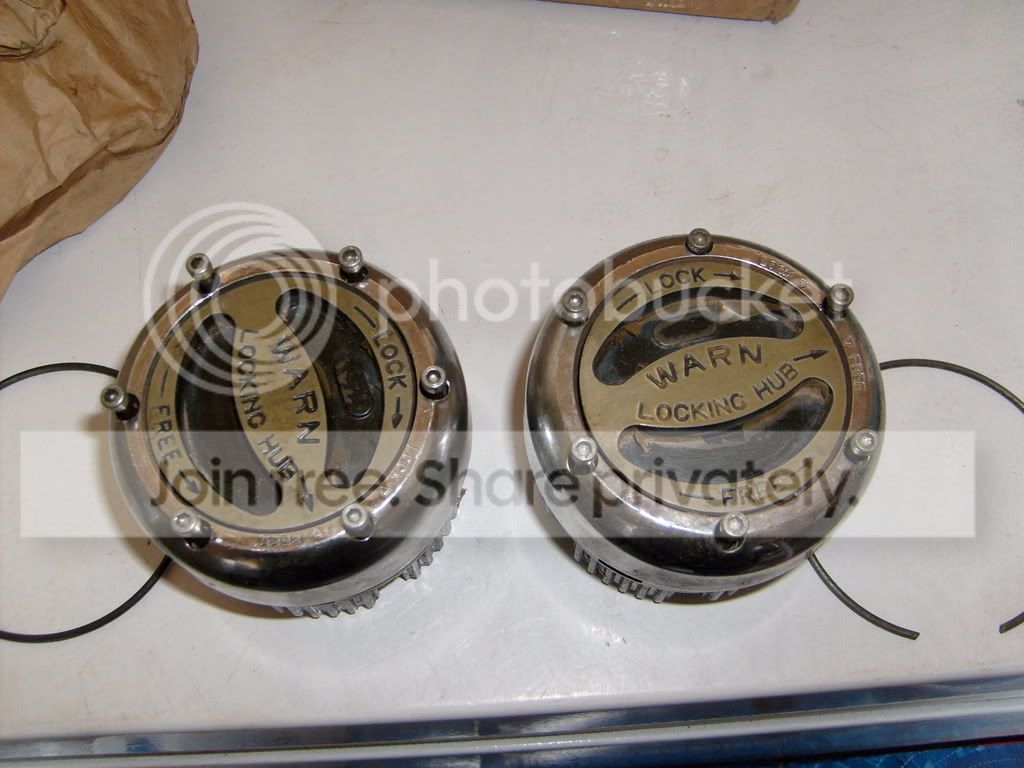

  • Warn Premium Locking Hubs (Thanks, Ryan.)

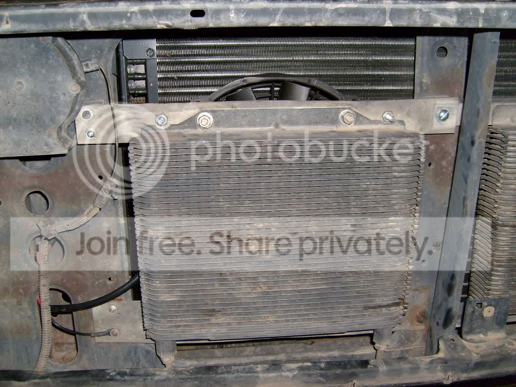

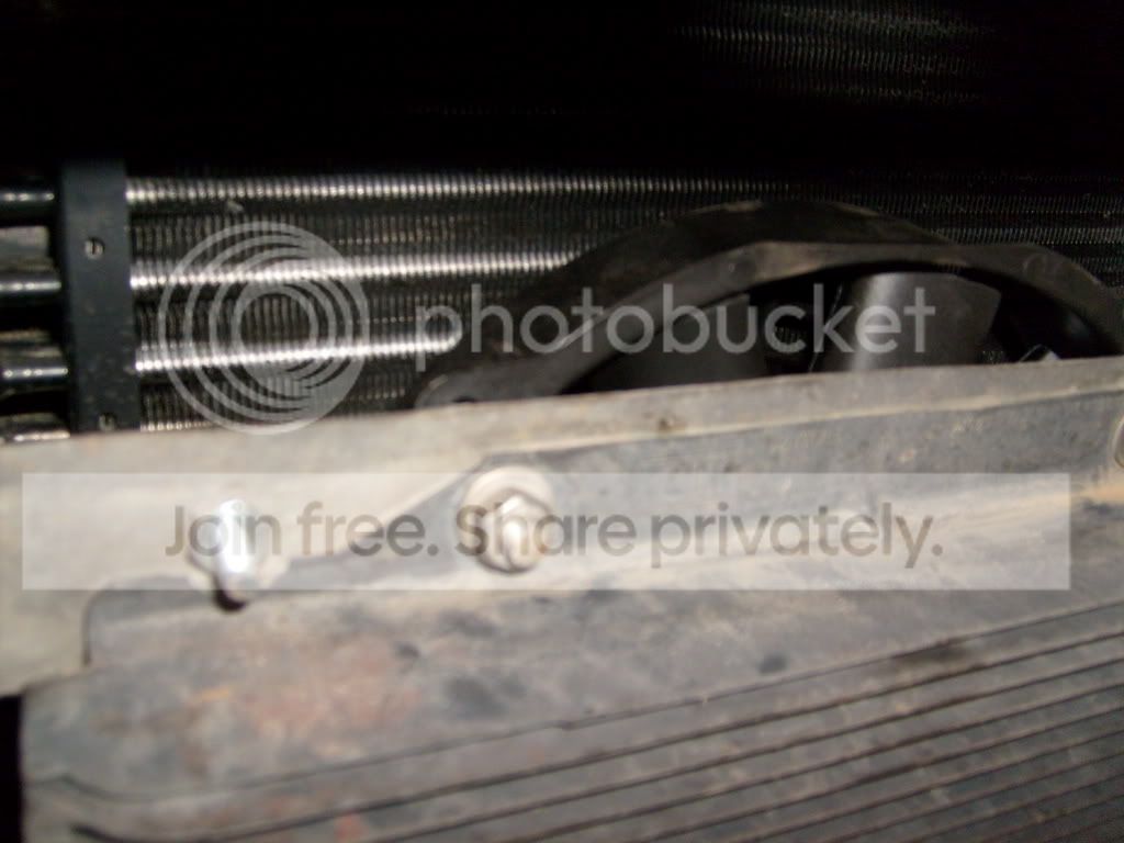

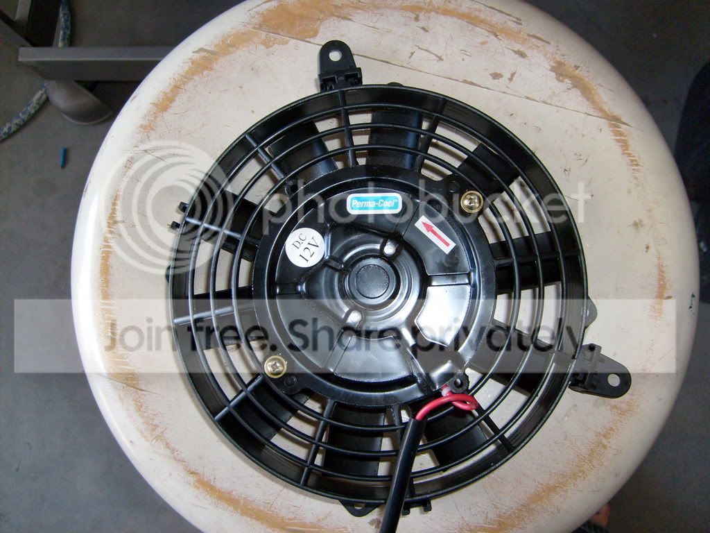

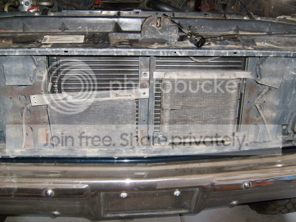

Once I got my R134a conversion done I had the same problem as most conversions, air gets warm at low speeds or when idling. This also caused my compressor to never turn off, so my engine would start to overheat. So, my solution was two 8" Perma-cool fans to be installed in between the Aux oil & tranny coolers and the condensor. That should keep the air flowing on the condensor and the A/C cold. Here's what the look like
To install them I just unbolted the aux coolers and mounted them on the back of the aux coolers mounting strips. Then I remounted the aux coolers with longer bolts and screws at the top.
I need to pick up some more bolts and screws then I'll install the second one. Their grounds are run to the core support and the power will come off a relay activated by the compressor (thanks for the tip Jason). When I'm done my remote start should be useful again since I'll be able to cool off the burb before we get in. :D Gotta love that when it's triple digits outside.

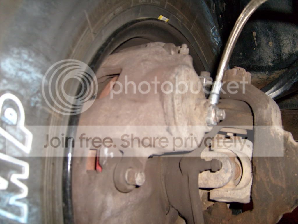

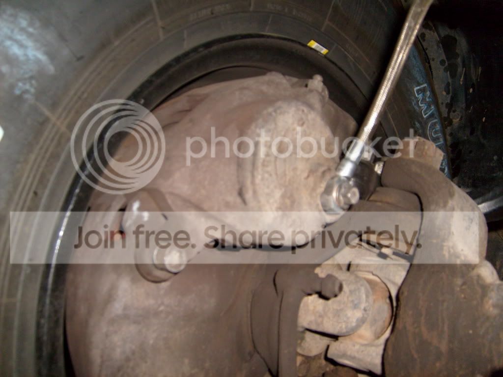

You got a better pic of your caliper ? I wanna compare my 1/2 ton 10 bolt to your 3/4 ton 10b .
Here is what mine looks like with the square ones installed anyway . I didn't go through the little nubs the line goes through , just to the side . 3 years on it so far .

Snapped some pics right now just for you, Pauly. ;)
They are very different. Mine have ridges on both sides that curve around the top and bottom and kind of cradle the ends. fter I ordered I noticed that some places listed the Pro Comp lines as only going through '86. My burb actually already had the wrong lines on it. When I went to buy a new line to use as a template for grinding I bought ones for 8600 GVWR for the heavy 3/4tons. They were longer and wider, and would have fit into the cradles on the calipers perfectly, the ones on the capliers were the 7200 version for the light 3/4tons. I also noticed the ones I took off and my new ones had smaller holes for the fluid than the 8600 version that should be on them. :crazy: I assume that doesn't help stopping power.
Thank you . I don't remember seeing those style . Must have overlooked them .
I got to look at the other 10 bolt I just got :thumb:

Well, this weekend when I pull the rotors to be turned, I'll pull off the autos and put on some WARN premium hubs courtesy of desertrat67 and that's it for now with the axles. I have a one ton 14BFF sitting in the garage, but it would need rebuilt and the perches moved and with so many other things on the burb that need attention, and my 33s not being a threat to break anything, my 10 bolt and 14 bolt semi-floater will be staying around for awhile. (wow, that was a ramble.)
