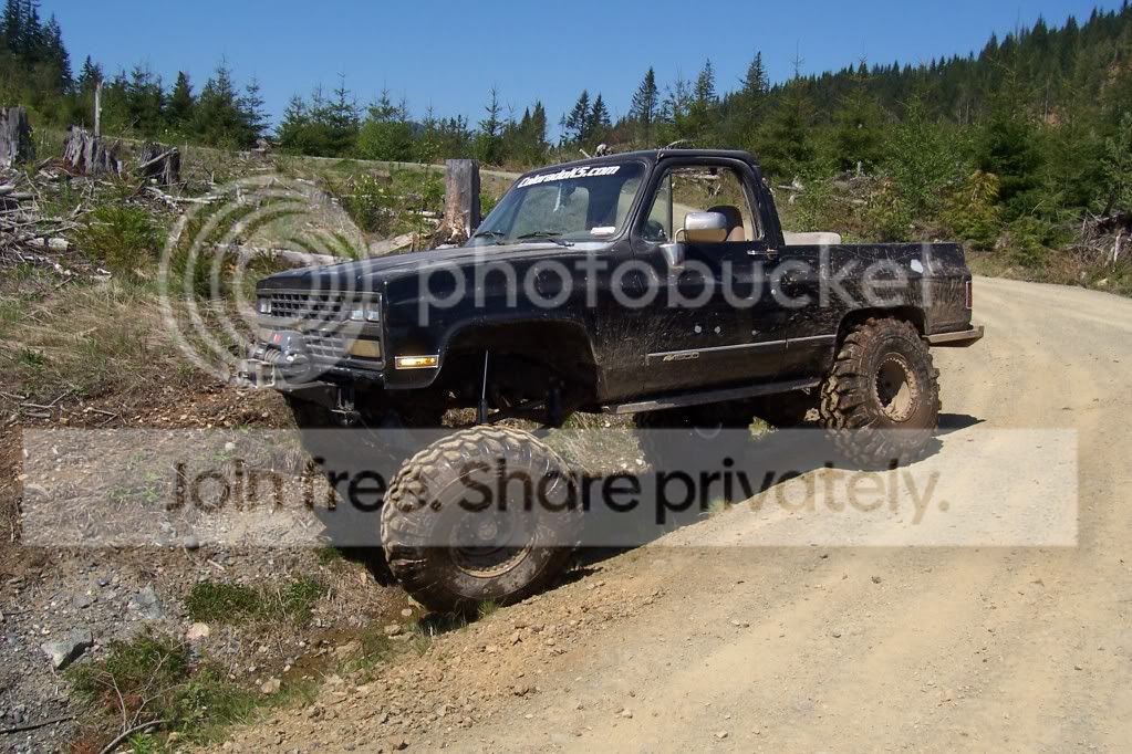

I guess mine sorta fits the bill. It's a 90 with 3" TC Softride fronts and flipped rear with 56's. I run a 1" body lift also. Right now it's on 37's and Walker Evans beadlocks. Has the usual D60 with a Powerlock, 35 spline all the way, Rockcrusher flanges, 4.10's, and crossover with hydro assist. The back is a 14 bolt with Detroit. Has a crate tbi 350, th400, clocked flat 241 with SYE and a 1350 High angle shaft. Front is a home brew square tube with a 1480 D60 joint at the case and 1410 on the axle. Full cage with PRP seats and a ton of other things. It was driven on the street and was a daily driver as needed up untill the end of June of this year. Now it is trail only. This pic was from before the 56's in the rear.

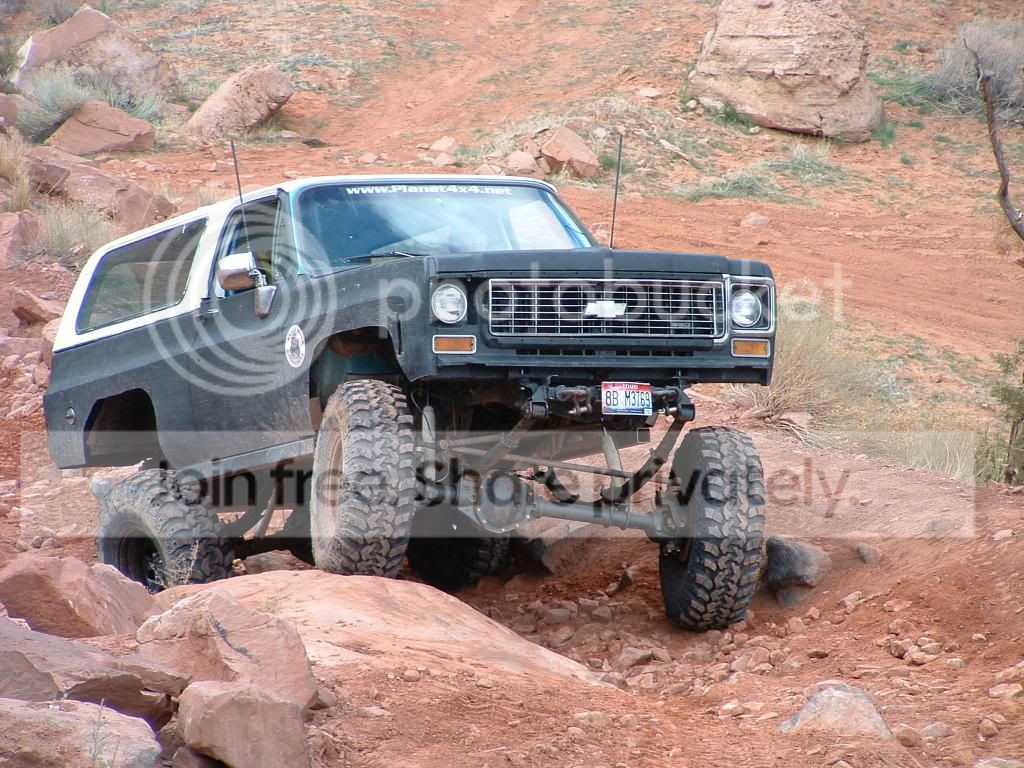

My blazer a couple years ago before most of the body damage was a great highway driver, rode nice steered nice etc. 40" Iroks kind of wear out fast, but I drove this to Moab twice. Montana a couple times, central Idaho. All over the place only problem I really had was the holes on the trans that hold the adaptor to the tranny stripped the threads, the adaptor seperated an inch or so. Had to add more tranny fluid every 40 miles or so

Are those 56's up front? Oh and what's up with the Jeep style crossover with the draglink attached to the tie-rod? Did it work out for ya'?
